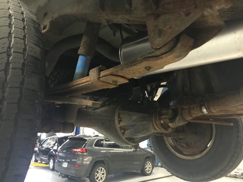

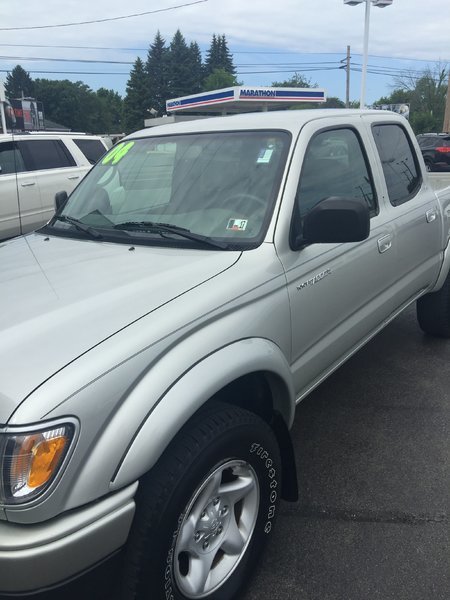

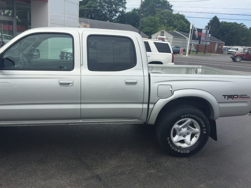

    Hey guys! I'm finally returning to the Tacoma World after several years with a Jeep Wrangler and Subie. So I've been looking for a well priced 1st gen Tacoma and think I found a 2004 DCSB TRD OR selling for 13,800 with 92,000 miles. The truck itself looks super clean but I have questions about the frame obviously. The Toyota dealership says the frame has been inspected and is good to go. I have a few pictures and was wondering if I could get an opinion if I should be worried or not. I would have to fly out to pick up the vehicle so any opinions would be great! It is coming from a cold weather state!!

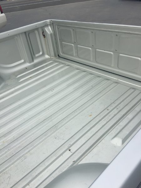

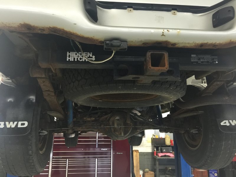

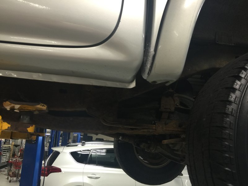

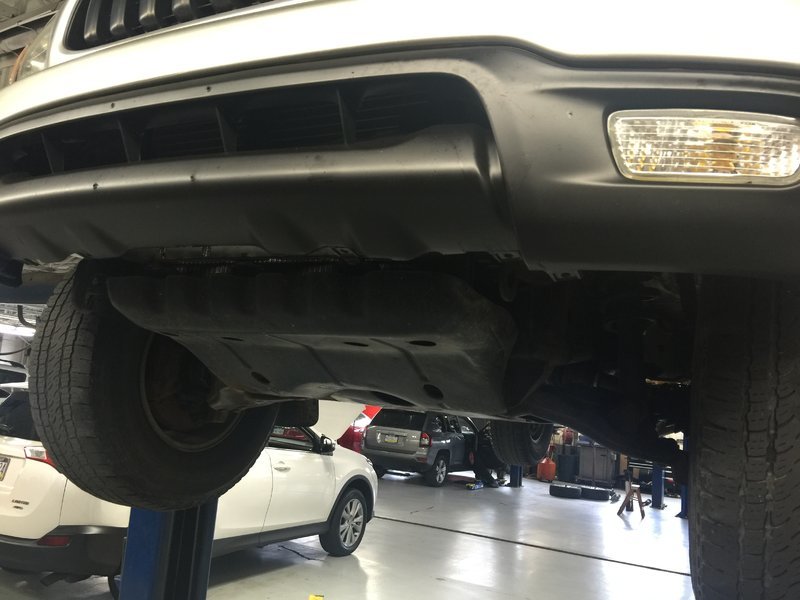

    Here are a few more pics. The price is well below KBB so I'm almost too scared because it seems like such a good price and looks great!

    Get pictures of the frame up front about right below where your feet would sit on floor. The inside of my frame rails were rusted out in this spot.

    The frame doesn't look bad but the pics kinda suck. It doesn't look like its been coated either but again the pics kinda suck. If the frame wasn't coated and a problem arises then your SOL as far a "warranty" goes.
    There is going to be people who chime in saying "it's no big deal, it's just welding" but if you're here asking, I would assume your not a welder nor can repair the frame yourself. I could be wrong though.
    Looks as if it's at a dealer, call them and ask if the frame has been coated by a Toyota dealer. If not, and your worried about it, then pass.
    When I purchased mine, I knew it was coated by Toyota and wasn't too concerned by the rusty frame. It was covered by the 15-year warranty and when I found a hole big enough, I got it approved to get a new frame. Mine was rusty right above the rear wheels, didn't notice it at first but then pushed on it with my fingers and a nice chunk fell in. The coated is, well to me a disguise or a cloak to mask the rust problem. The frames are rusting from the inside out and the coating hides all that and kinda keeps it together. when the dealers do the inspections, he said that they can only lightly tap on them with a ball peen hammer. If there is a soft spot they annotate it in the records but do not try to push it through.
    You said the dealer said the inspection was good? What does that really mean? By Toyota's rules about perforation, if the holes aren't any bigger than 10mm, it will pass inspection. If there is rust through, but holes are smaller than 10mm and the frame wasn't coated, you may want to pass unless you can take care of it yourself.
    See if you can get some better pics like said above by Norther Taco, the more pics the better help you will get on here. Good luck

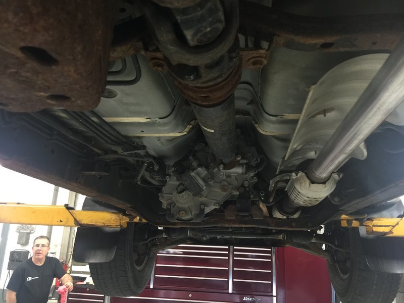

    This was all I got and is off the rack now.

    I wouldn't mess with it. The inside of the frame rails will be looking like that gas tank sheild. Not good.

    Really hard to tell since the pics are more focused on other parts and not the frame. It doesn't look as bad as my frame though.
    Call them and ask if the frame was coated. If it was, get the VIN and call Toyota HQ. Ask them that if you were to purchase this vehicle would it be covered under warranty for a rusty frame. If it wasn't covered and it scares you, PASS!

    FWIW, I think that truck is really rusty and I'd pass on it unless it was really cheap and wanted to start rebuilding it from the frame out. Junk like rusted up solid bleed screws on wheel cylinders and other random fasteners makes me cringe.
    But I also realize the judging standard is regionally subjective. For Colorado that would be considered badly rusted but I guess for Ohio that would be practically brand new.
