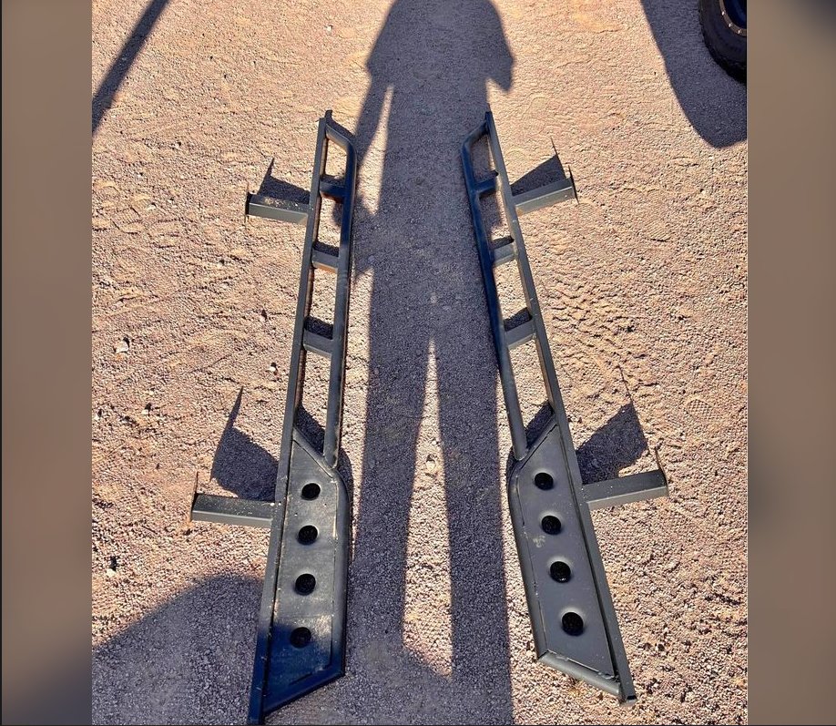

    So there is a set of homemade rock sliders for sale like 15 minutes from my house and for $400. They are bolt on for a 3rd gen. My first question is will they even fit my 2nd gen? My preliminary research says that they should.
    My second question is if it is a good idea or not, since I am 99% certain that these are homemade? Is it worth trusting someone else's homemade sliders? They seem to be a good deal compared to others that I have seen. Thanks for the advice.

    Well you get what you pay for.
    Question is, how hardcore are you planning on going to warrant sliders?

    There are plenty of guys that build solid sliders at home so being home-made shouldn’t scare you away. That being said, if you know what to look for in terms of proper welds and material choice, you should give them a good inspection in person before agreeing to buy them or at least use that as a negotiating point on the price. My opinion is that they used smaller diameter material for the main rail but if it’s thick enough that could be ok. I’d also be cautious about using only two attachment legs to the truck and would be more comfortable with at least one more in the middle. In their current state, I’d advise against using them as true rock sliders and consider them glorified steps.

    Honestly not too hardcore, I just want something to act as a step and not fold my rocker panels when I hit it. I used to have tube steps, but sold them for a profit after I smacked the passenger side one and dented it.
    That is kind of what I am looking for. I have a few friends who can weld (I have very basic knowledge of welding) and I may ask for some help to add another support in the middle.

    UPDATE: he says I have to drill into my frame in order for them to be bolt on. I'm probably gonna walk, since the whole point of bolt-on is that there is no permanent damage.

    Second the third member idea.
    Just from the pictures I'd guess it needs some decent reinforcement before I'd trust hanging the truck on them.

    Only two legs, need four for proper support.
    Tubing is smaller than typical ones on the market. You want minimum 1.75" OD x 1/8" wall.
    The frame flanges look paper thin. They should be 3/16".
    Keep looking or blow your money on something else :laugh:
    3rd gen has a frame reinforcement splice in the area of the transfer case crossmember. Sliders designed for 3rd gen will typically have a joggle that will leave a gap on 2nd gen.

    If you or a buddy have welding capability, I'd say go for it. They need some improvement, but the expensive part (buying the material, doing most of the layout and fab) is done.
    I'd like more and thicker mounts, but in this case, I'd get them, clamp them to the frame and put them where you want them, then find existing holes to use and fab up 3 or 4 mounts to use those existing frame holes, then chop off the mounts that are on it, hit 'em with some paint, and you're done. An afternoon of metal work and less than $100 in materials will make those pretty stout.
