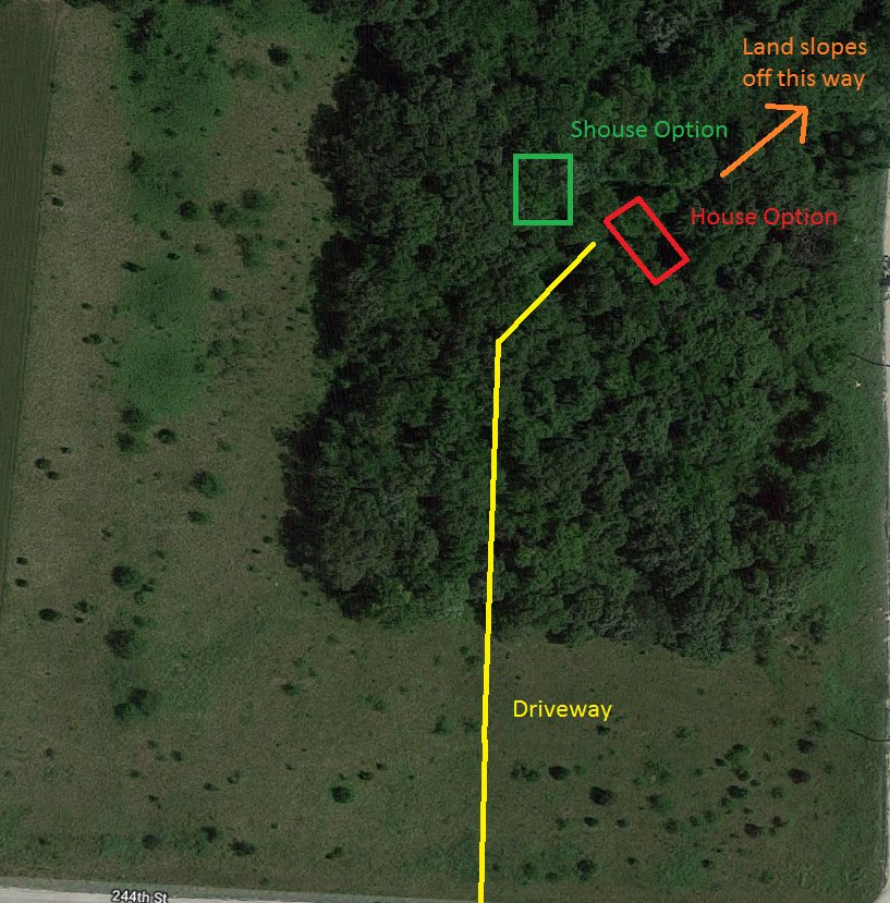

    Anyone have experience in purchasing land and building a home? Tips or tricks? Things to watch out for?
    I have a budget of 200k to work with and I want to keep costs down.
    Right now I'm weighing the options of allowing my cousins excavation company to dig our basement or borrowing my uncles backhoe to do it myself. Problem is the rainy season is coming up soon. Plus its Missouri so the weather fluctuates like a woman's mood.
    I found 8.37 acres I'm going to make an offer on, Mostly wooded, on a hill.
    A gravel driveway is what I'm thinking will be the cheapest and easiest for me to do, my dad is loaning me his small tractor with a blade so I can blade out the driveway and spread gravel.
    Beyond that I'm stuck trying to decide if I should buy a steel building and build a shouse, hold off on the basement; or dig a basement and put a modular home on top.
    My Aunt is my realtor and she's checking on if there are any restrictive covenants on the land that would prevent us building a modular.
    Stick built is simply too expensive unless I had a job where I could take off a lot of time and dig out, frame up, run all the plumbing/electric/air/etc by myself or with a few friends.
    I'm preapproved for the land loan, and ready to make my offer, its listed overpriced per acre for the area and since its all on a large hill, we are going to leverage a lower price plus closing costs.
    Any one have any tips for me? Am I getting too far in over my head? If all goes wrong I can always buy a house instead of the land, but the American Dream and all. :fingerscrossed::oldglory: House.jpg

    Power and water are already on site.
    We are looking into the covenants now, we were going to have a builder put a modular home in, take care of all codes, and connect up power and water. We'd have to get a perc test and put in a septic tank too.

    Yeah my dad's house has a lagoon, not sure what all is involved there other than digging out a big hole in the ground that's lower than the house. The property slopes off enough that wouldn't be a problem.
    I'm also weighing my options to another cheaper plot that's in a different neighborhood, its smaller, but more treed. What I want is to be surrounded by trees and not see my neighbors lol

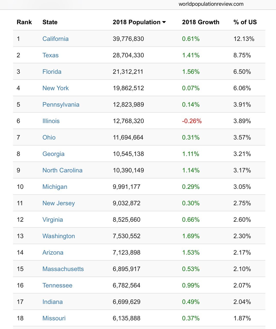

    Ha ha smart guy. I meant by area. We have like 6 people per sq yard over here
    Tatts521 and 916carl like this.

    Also in NJ yeah we are a little compact over here
