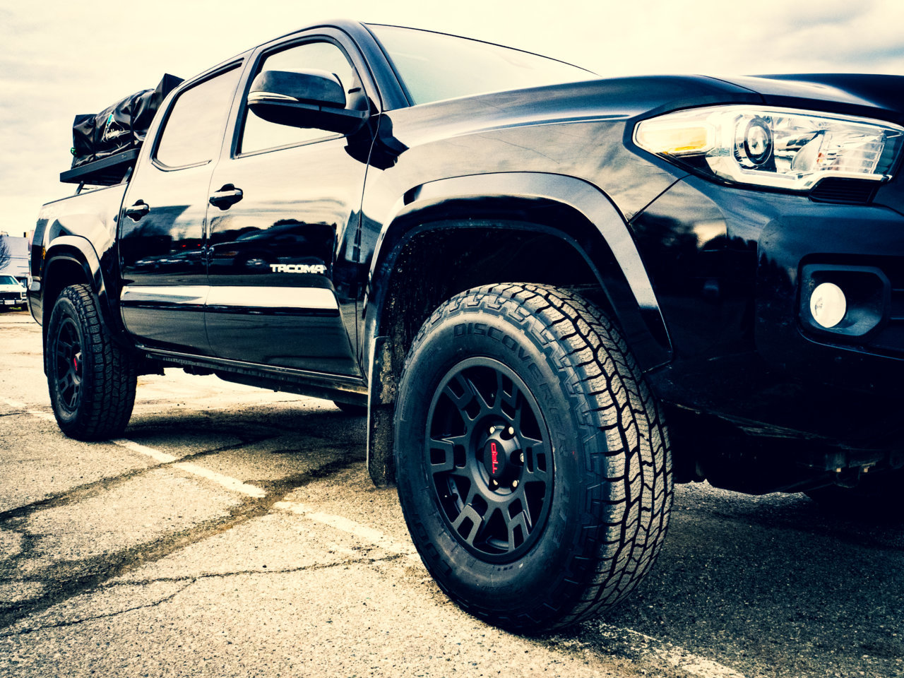

    And just so you have a visual:

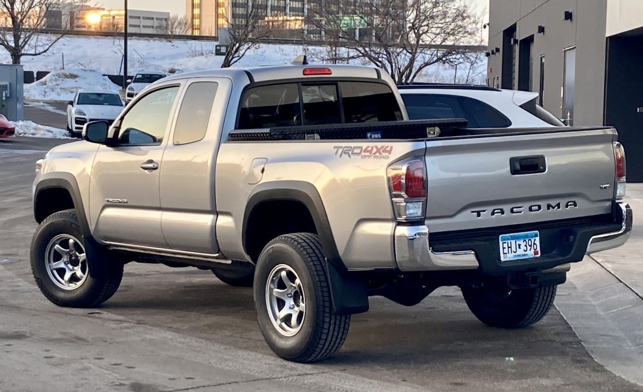

    I weighed the stock 2021 16" TRD offroad wheels and factory Goodyear Wrangler Adventures at 60lbs (25lbs for the wheels and 35lbs for the tires). The tires were relatively light for their size. Based on those weights your set up should be 4lbs more than the stock combo if you have a TRD offroad with factory 16" wheels. If you have the Sport with 17" wheels, these weights may not apply.
    I installed Michelin Defenders in a 265/75-16 size on my Koenig 16x8 zero offset Countersteers (first production from back in 2009/10). The combo weighed 4 lbs less than my stock set up of 60lbs.
    39lbs tires / 17 lbs wheels =56 lbs total
    This combo is 8 lbs less than your combo at 64 lbs.

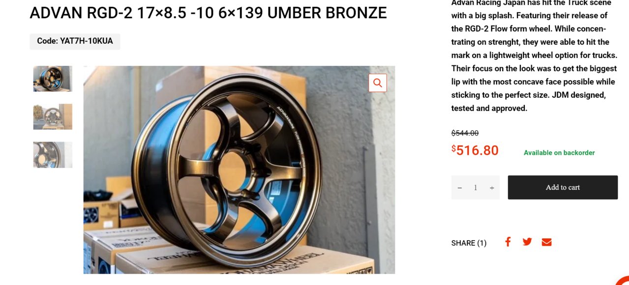

    Here is an example of a similar styled 17x8.5 wheel at 21 lbs but it doesn't come cheap. There are other Advans available

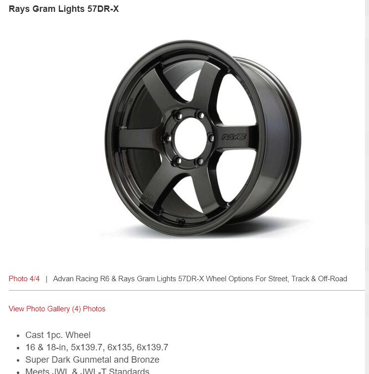

    Rays also has wheels that fit Tacomas, but again they don't come cheap

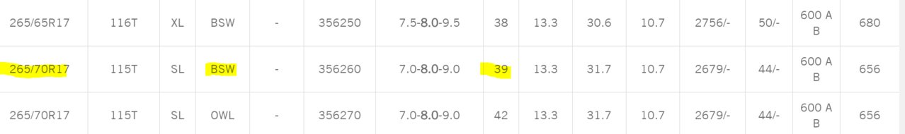

    If you check the Toyo site you will find that the black wall in that size is speced at 39lbs.
    https://www.toyotires.com/product/open-country-at3
