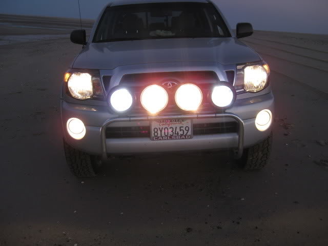

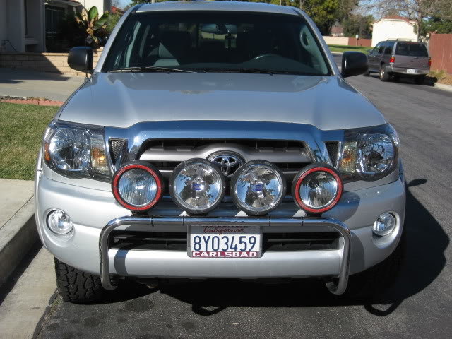

    For distance you want pencil (aka 'spot') beams ... HID of 4,300 to 5,000 degrees K in color (pure white)

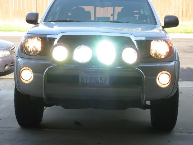

    The pair closet together are Hella 4000 pencil beams, converted to 35 watt HID, 5,000ºK. The pair on each side of the Hellas are Kragen HID 'Euro' beams (driving beams). The factory lights are all stock halogen...
    Below are the Hellas when they were 100 watt halogen powered...
