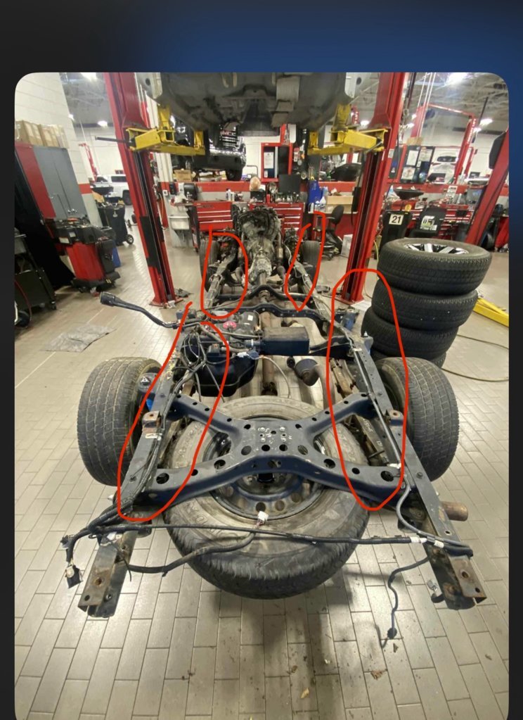

    I’m taking it to TN if I buy it so I would think as long as there’s nothing detrimental now it should be fine forever being no rust issues here. Also I can coat it with something myself. Need to find what the best is.
    I asked for more pictures of these particlular areas this is the pic I sent them of a Tacoma frame

    Just nicely ask them for more photos. Tell them where to point the camera.

    I did. I sent them this picture and asked for photos from these areas
