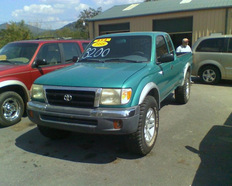

    Pic of truck I took with cell phone today.

    Nice looking truck, walk in with $3000.00 cash and tell them to deduct $200.00 for the missing belt and what may or may not be a working compressor.

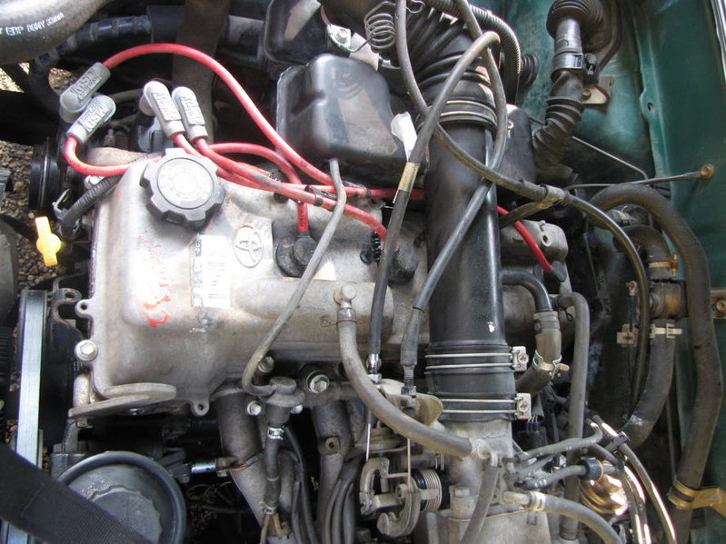

    Take a pic of the engine, we can tell ya then.

    Here is a pic. I called Toyota with that serial # and they were of no help. He had no clue on how to figure out what size or year this engine is. I really would like to know for future repairs ect,
