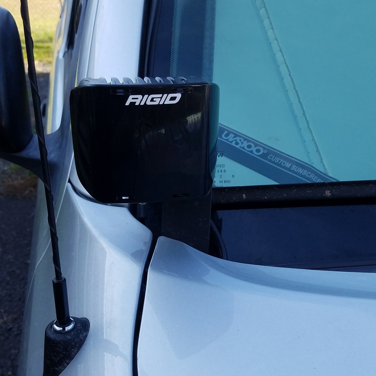

    I also just got back from aiming my fog lights and ditch lights. Well... more or less. I need to shim up the driver side light like I did on the passenger side because it is hitting the bottom of the opening in the bumper, so it won't go down far enough. I didn't measure, but it's about 4 inches above level right now at 25 feet. Before I aimed them, they were pointing above my headlight cutoffs. :eek: I didn't grab any pictures. :facepalm:

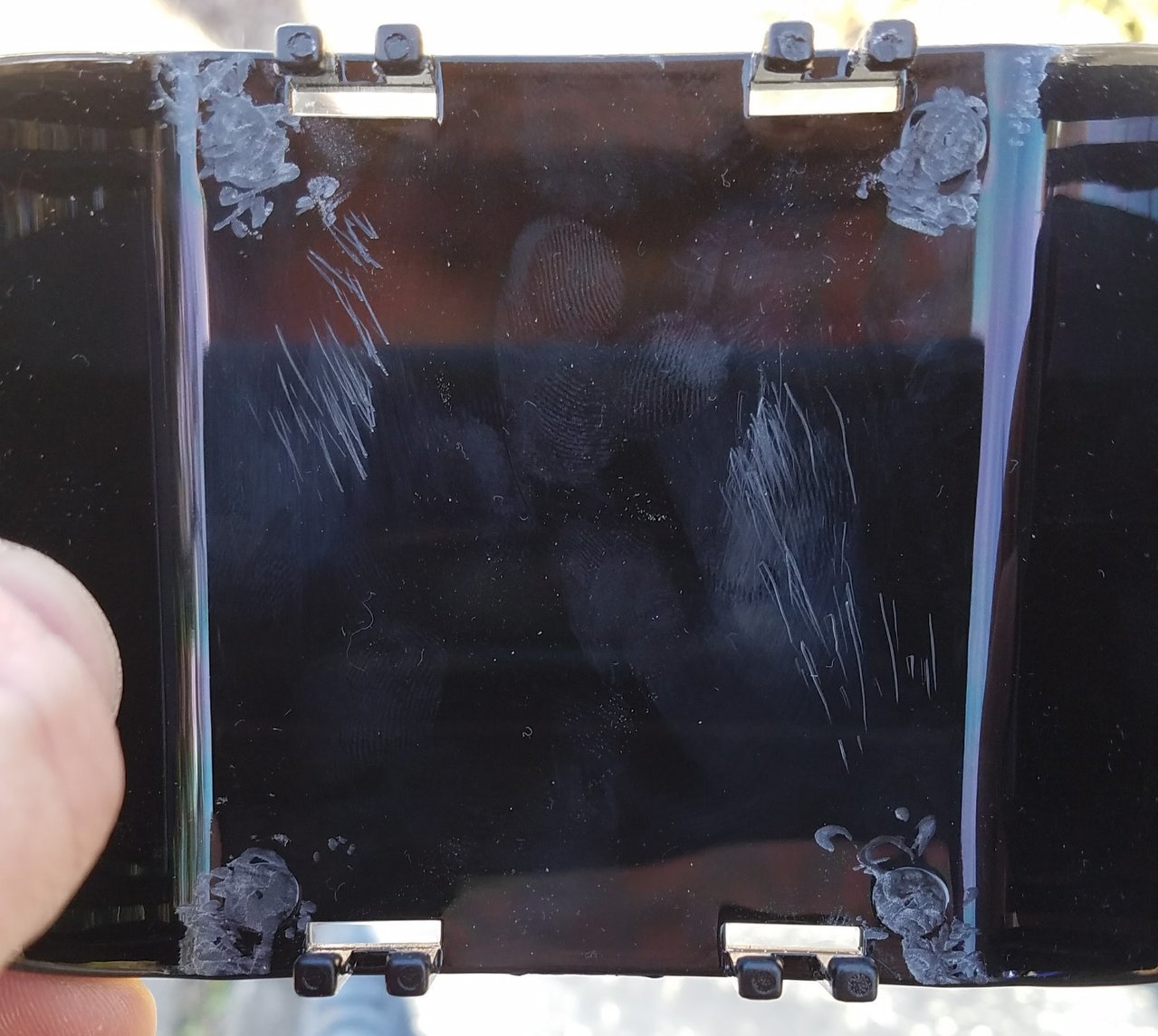

    I ordered a set of Rigid D-SS covers, for my Cali Raised pods, with my 4 Wheel Parts order mentioned in the last post. They didn't initially fit because there are 4 raised areas that kept the covers from pushing on far enough to snap on. Today, I pulled out the Dremel and ground down the raised spots, and they fit great now. They hold on tight to the point that I need to use a screwdriver to pop them off the lights.
    I also took advantage of the nice weather and vacuumed out the interior of both the truck and the car.
    Here you can see where I ground down the raised areas. Not the prettiest, but it's inside the cover against the light, so it can't be seen.
    Here's how they fit on the lights.
