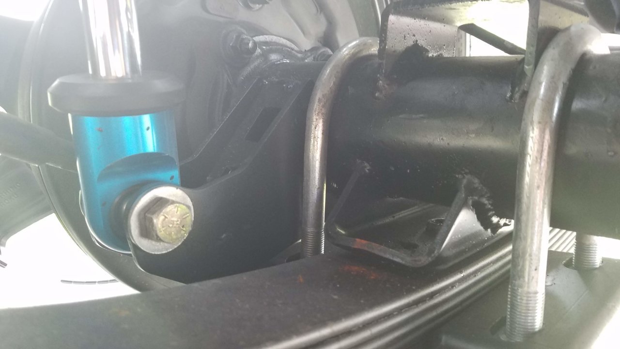

    So you know, I may have got 1 short call from them. They installed the standard tabs, not the deep tabs, and the tab can be rotated down a lot more, as pictured in my install instructions. I wasn't there installing it, so I don't know if there was interference, but it looks like they know nothing about suspension and can't read instructions. One thing to note is the Camburg kit puts the springs outboard farther than stock, reducing room for the shock tabs
    Also, with the resi back so far, I'm worried the shackle might hit the resi under droop.

    Well... I just took another look under the truck and there's no way that they could have rotated the shock tab farther down because of the u-bolt plate under the spring. To rotate any farther down would require notching the shock tab or u-bolt plate for clearance.

    I see that now. My SUA conversion design might be able to fix that as mine only has the u-bolts (9/16) down the side of the spring and they are tight to the spring, but you would have to weld a perch on top of the axle to support my u-bolt plate. Then the axle tab can be rotated down, and you have some bump travel.

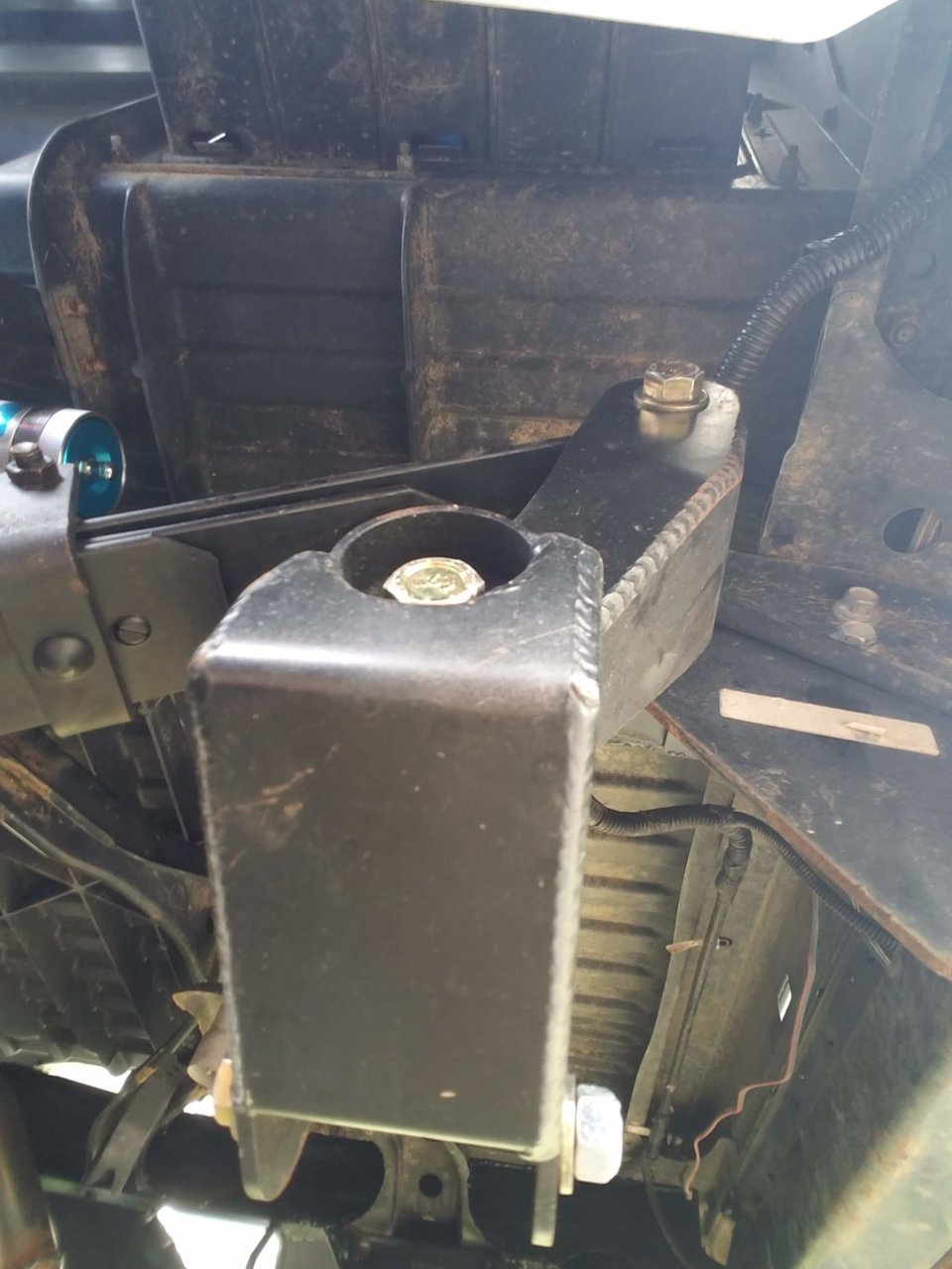

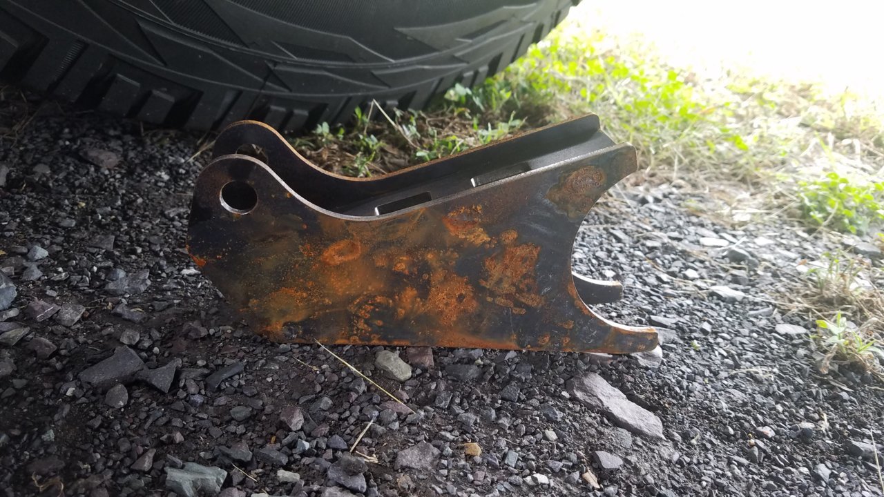

    Yeah. It's definitely odd.
    Honestly, I'm not sure about the Camburg kit. There really isn't anyone on here running it, and there's only one picture on their website that shows the shackle position. In that picture, the shackle is forward of vertical and mine is sitting rearward of vertical.
    Their's:
    Mine:
    Thanks for the offer. Hopefully, it doesn't get to the point that an attorney is needed.

    Not sure what you're asking about with something shifting in the hanger . If I jack up a tire, the spring will compress which will angle the shackle farther back.
    I didn't hear back from Camburg yesterday, and I want to hear from them before I contact IPOR. If I don't get an email today, I'll call them when I get off work.
    Archive is referring to the u-bolt setup for his SUA kit. His kit uses 2 plates to sandwich the axle and spring. One typically sits on the factory spring perch, and something would need to be welded on the top of the axle to support that plate because the Camburg kit moves the springs out farther than factory, and it wouldn't be completely supported.

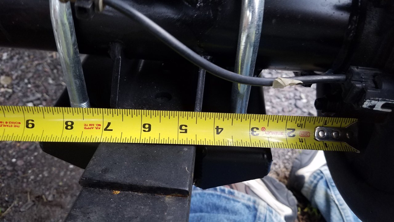

    I got an email back from Camburg yesterday. The photo on their website that shows the shackles angle with the truck on the ground is a custom setup on one of their race trucks that runs shorter springs. That means that my shackles are sitting in the correct position.
    I still think that the passenger side spring looks like it's leaning in toward the center of the truck. I jacked the truck up yesterday evening, pulled the wheels and drooped the suspension to take more pictures. I discovered that the spring perches aren't welded in the same place on both sides. There's 3/8 inch difference between the two sides. On both sides there was a little bit of a lip of the machined surface where the bearing bolts up that I hooked the tape measure.
    They also used gobs of red loctite when they bolted on my wheel spacers. They didn't return the instruction sheet, but I'm pretty sure Bora says not to use any loctite.
    Driver side spring perch (4 3/4")
    Passenger side spring perch (4 3/8")
