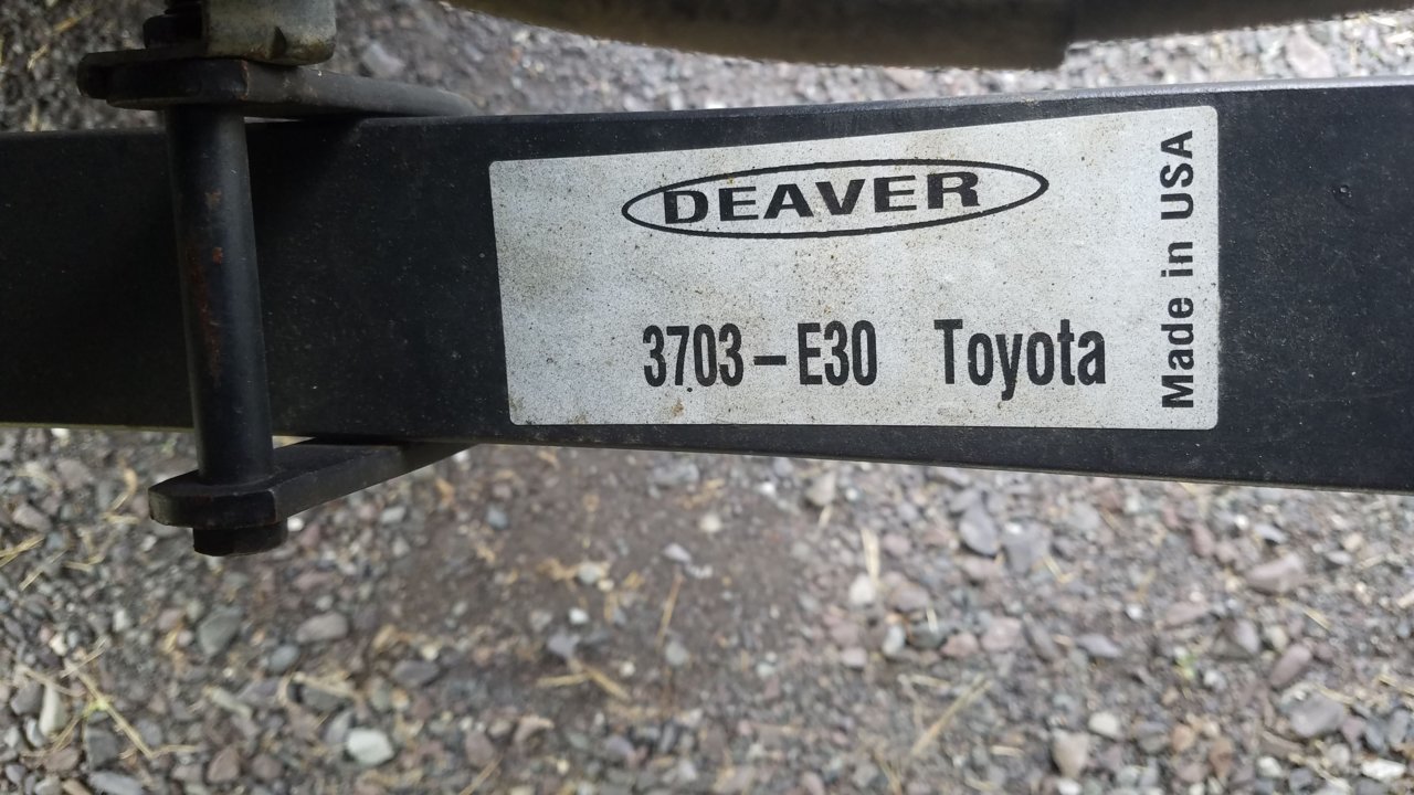

    Gotcha. My springs are labelled Deaver 3703-E30 Toyota.

    Yeah, those were the Deaver E-30 Springs and were ordered as a “prerunner” leaf pack, not the HD. I wouldn’t worry about the position of the shackle too much. What found out was, the leaf springs are long as well as that shackle. So the only way it’s going to sit is with that shackle slightly angled back. If the shackle design was smaller, it would compemsate for the longer spring length and make it more centered.
    The axle perches are definitely something to be sorted out.

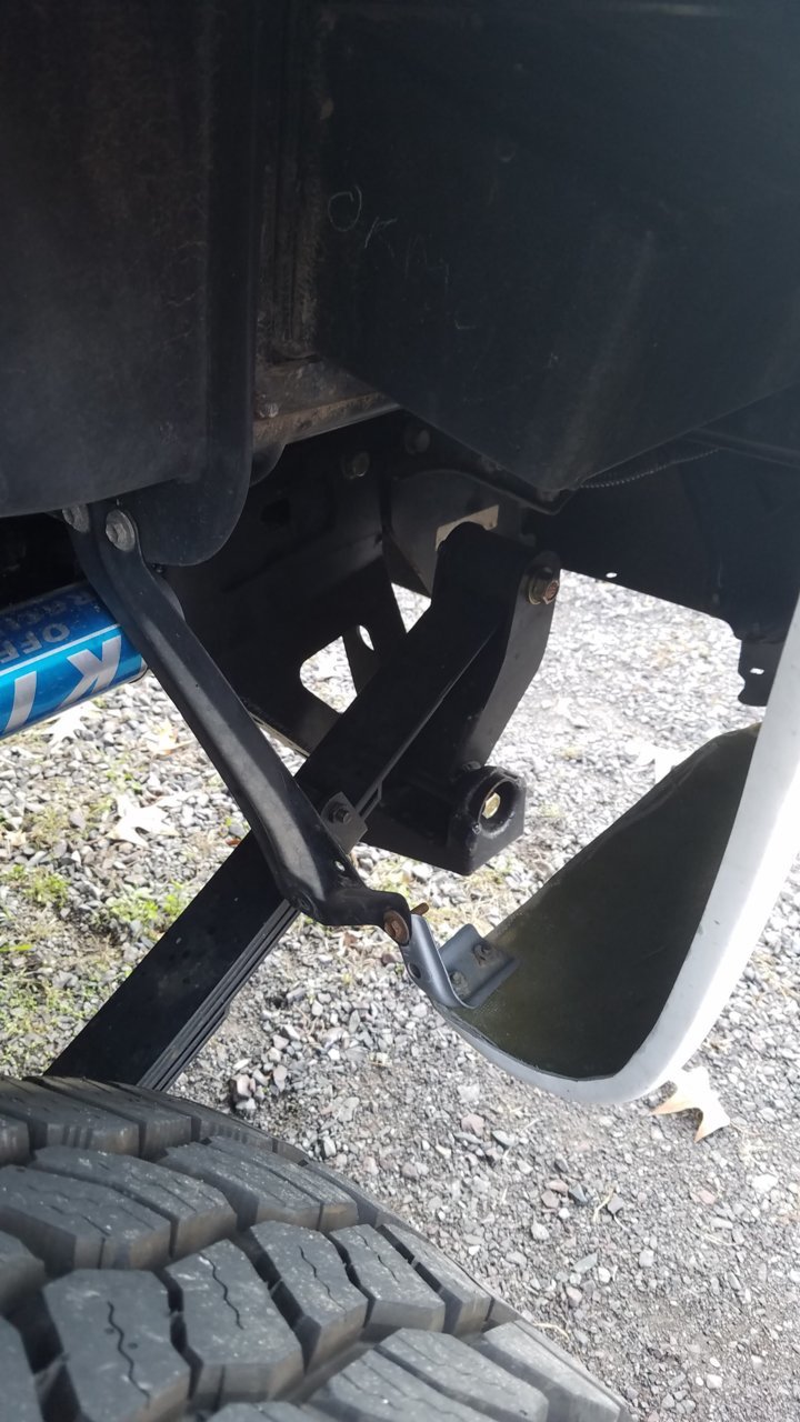

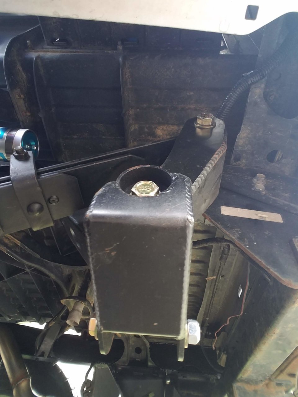

    The spring perches, axle shock mount tabs, and bump stops need redone. When the shocks are setup correctly, I'll need limit straps, and I still want a brace to run between the towers in the bed. Redoing the exhaust reroute and longer brake lines to eliminate the spacer they used would be nice but not high priority.
    Basically, everything they did except the frame boxing. :bananadead:

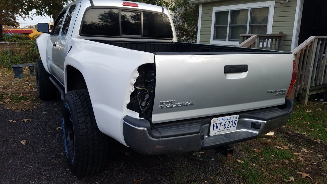

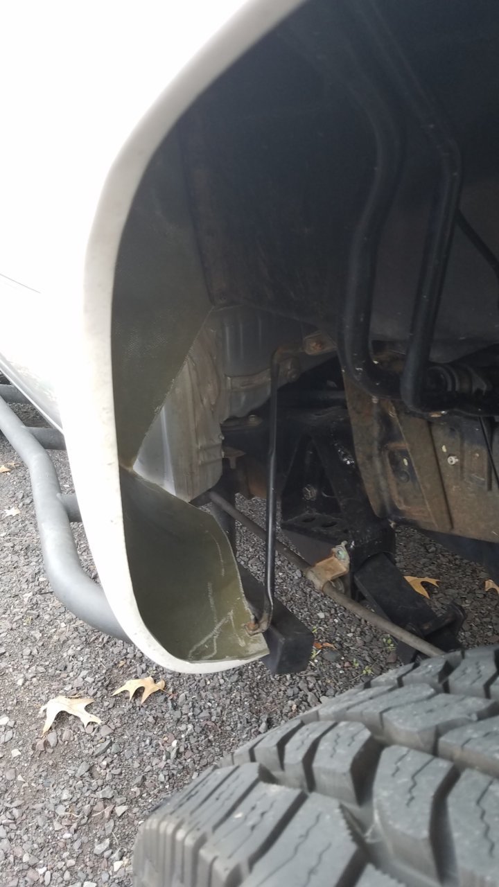

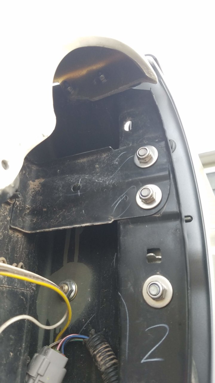

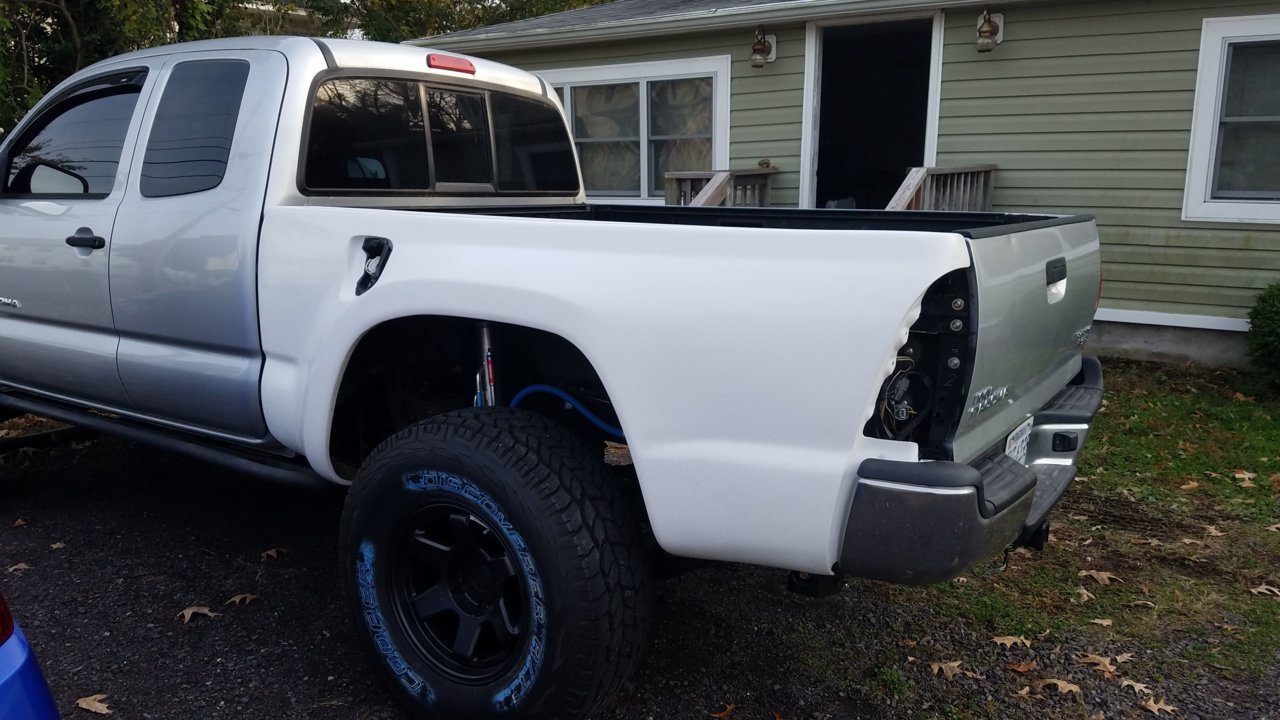

    As promised earlier. Here's some pictures of the driver side bedside.
    Still need to work on fitting the tail light, but hasn't been an issue driving around without it so far. Still have the passenger side tail and the 3rd brake light.
    The front brace.
    The rear brace.

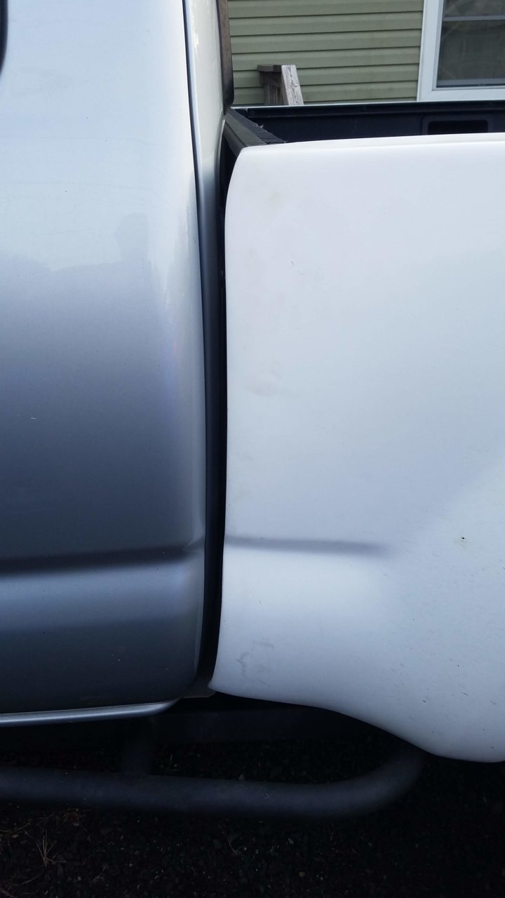

    Bed/Body gap. It's actually hitting the slider back where the kickout is. I may pull the sliders for the time being.

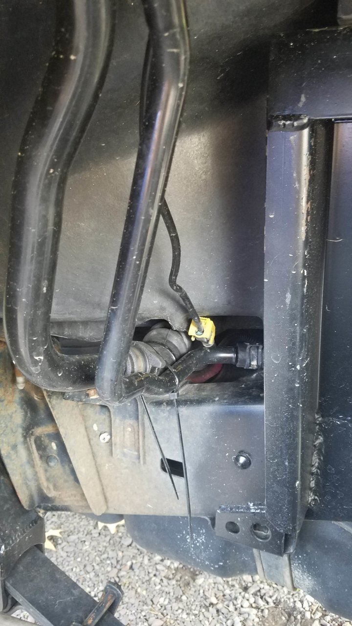

    The filler neck. I had to pull some of the bend out of the metal vent tube to alleviate some of the pull down at the plastic fitting on the tank. I need to look at where the bracket used to be. Where the zip ties are. My buddy that was helping me did that while the bed was still shifted back/lifted because the bracket wouldn't go on. I need to see how/if the bracket fits now that the bed is where it should be.

    Nice work! Those fenders are coming out sweet
