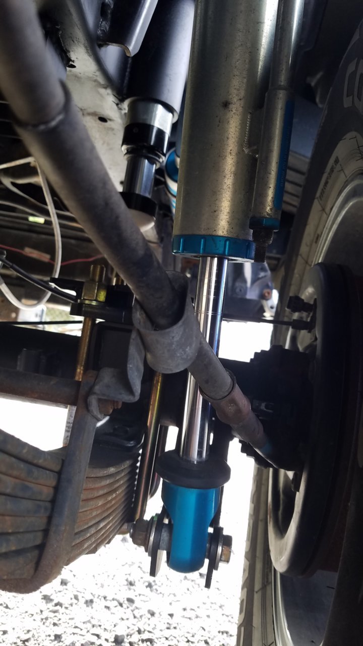

    I picked up my truck from the 4 Wheel Parts down in Richmond yesterday. They got the suspension install errors left behind by the shop that shall not be named straightened out, and it came out great. I can't thank @Fish12South and the guys in the shop there enough.

  6. Mar 24, 2019 at 2:14 PM

    It rides a lot better now that it isn't up in the bump zone. Before it was bouncy and stiff at the same time. It's hard to explain. It also doesn't feel like it's jumping around on small, hard bumps.
    There's the very tiniest bit of a shudder right before I come to a complete stop. It may be the brakes though. It was doing it when I got it back from IPOR, but it's less noticeable now.

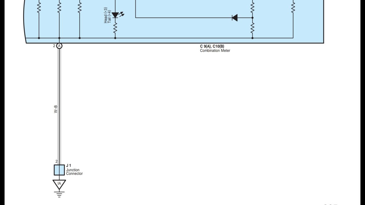

    Fairly productive day today.
    I bought a new toolbox yesterday because my old one was overflowing, and I moved the excess from the old to the new.
    After the movers came to see how much crap I have, I tried installing a new stereo, but I need a different dash kit to make it fit. What I need ships from China, so it may not got here before I move with their standard shipping. I'm in contact with the seller to see about faster shipping options.
    Next was checking the wiring of my PLX gauges and MAP-ECU3. I got the gauge that wasn't working going and the MAP-ECU3 wiring is correct, so I must have a setting wrong that's keeping the cruise control from working. I didn't bother dragging my laptop out to check it.

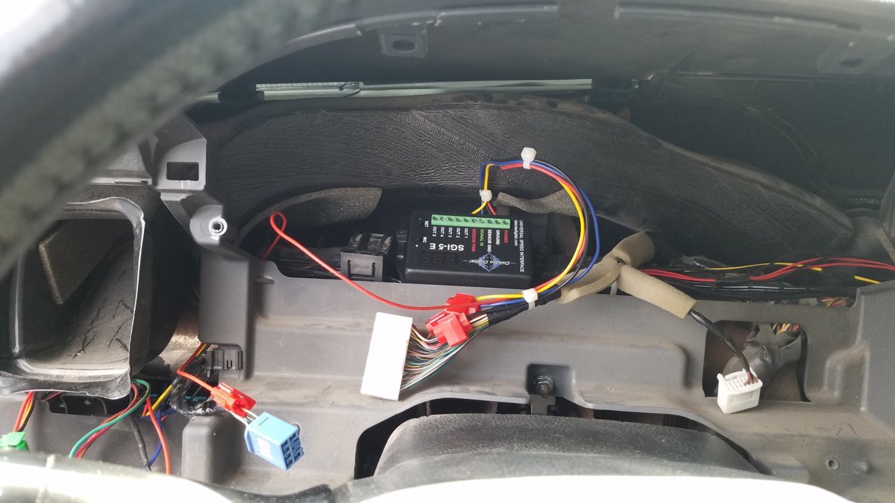

    Last inside bit was installing a Dakota Digital SGI-5E speedometer calibrator. I ran out daylight, so I'll work on finishing that in the morning.

    Slow start to today, but I just finished installing and testing the speedometer calibrator. It's dead on with the GPS speed app on my phone.

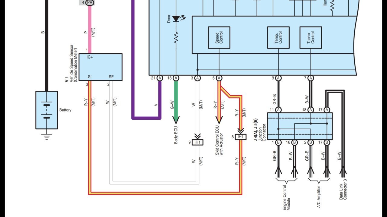

    I used IDC connectors for all the connections. I pulled accessory power from pin 1 (light green) of the dimmer switch. Don't use the B+ wire (cluster pin 1). It is constant power, and you need to be able to cycle power to access the calibrator's menu system. Ground and signal are on the bigger connector that plugs into the back of the cluster. Ground is pin 2 (white/black) and the speed signal is pin 6 (red/yellow).
    Make the calibrator input signal connection back from the factory connector. I unwound a couple inches of tape from the factory harness to give myself plenty of room to work. Then cut the wire at the end of the IDC connector toward the factory connector and make your calibrator output connection with the end of the remaining factory wire the end of the IDC connector.
    On the DD SGI-5E, the primary outputs are out1 and out2. I missed it buried in other text in the manual, but Out1 is a sine wave output and out2 is a square wave output. You want to use out2. I initially installed using out1, and the speedometer didn't work. Also, be smarter than me and use the built in reference function of the calibrator to make sure it's functioning before you go for a test drive. :rofl:

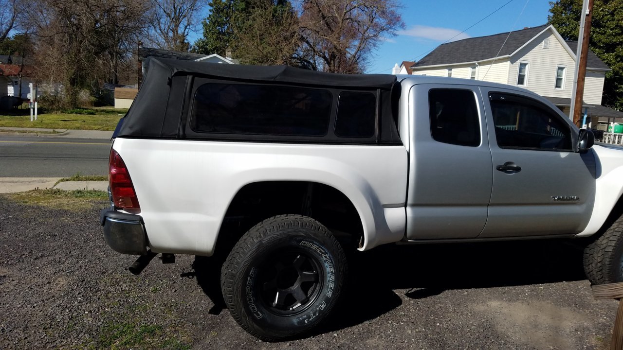

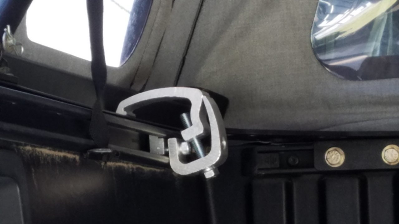

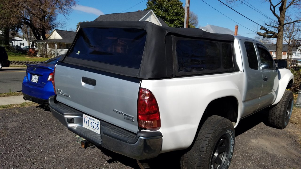

    Replaced the clamps that hold the Bestop down. The ones that it came with tilted when tightened and didn't hold well. I've been driving without the windows and the end of the rail kept pulling loose. I bought clamps like the ones that were on my old fiberglass shell.
    https://www.amazon.com/dp/B07K2K1QG9
    I also put the windows back on. I had to cut around a 1/4" off the rear window bar, so it would fit between the @KB Voodoo bed rail caps.
