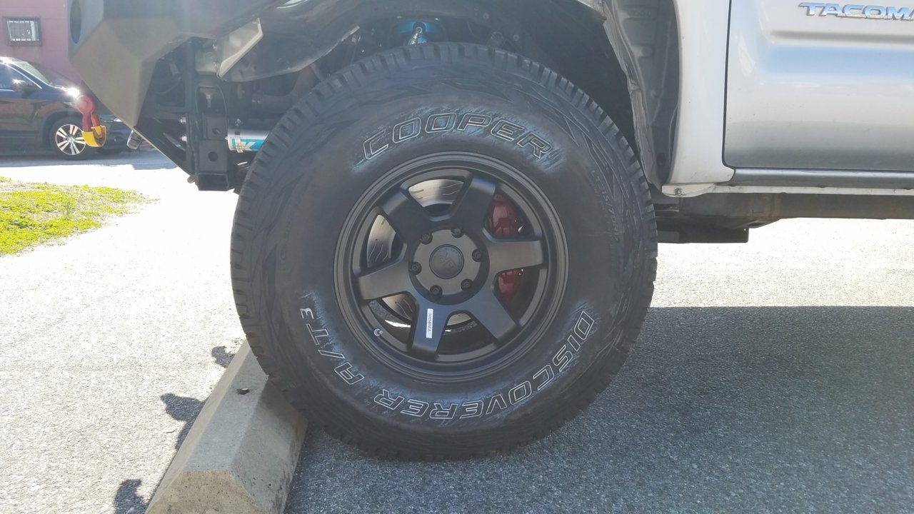

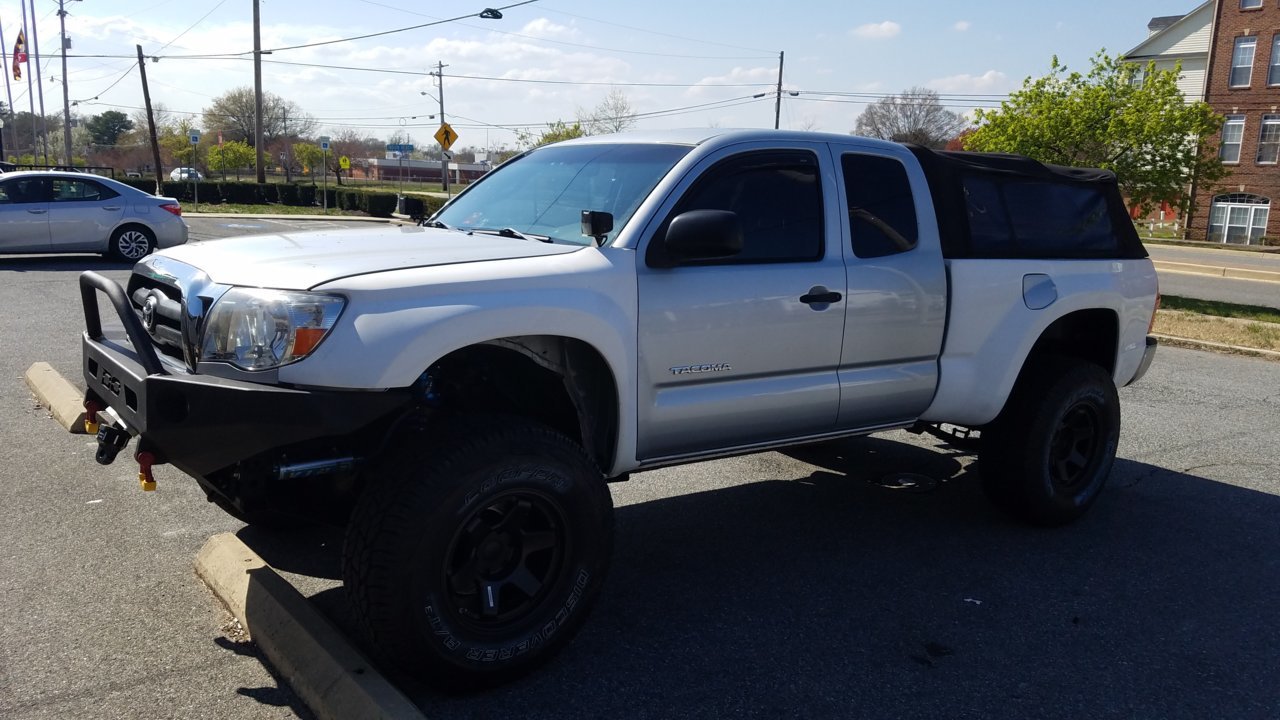

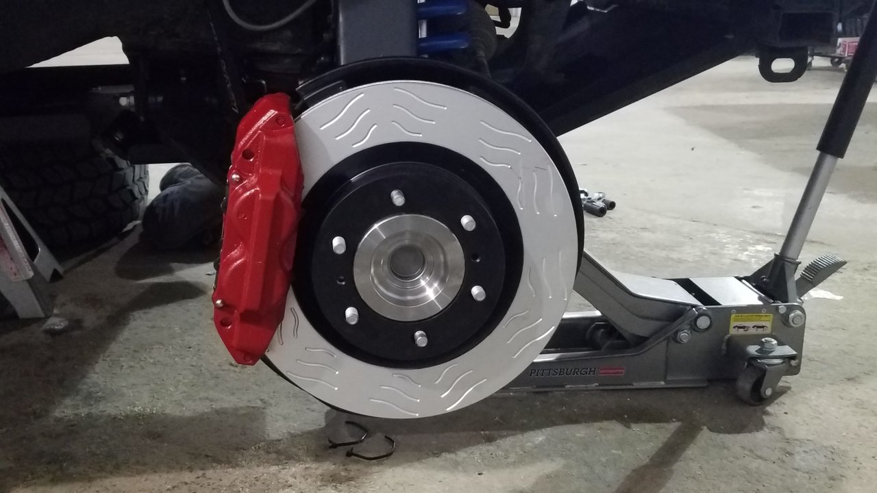

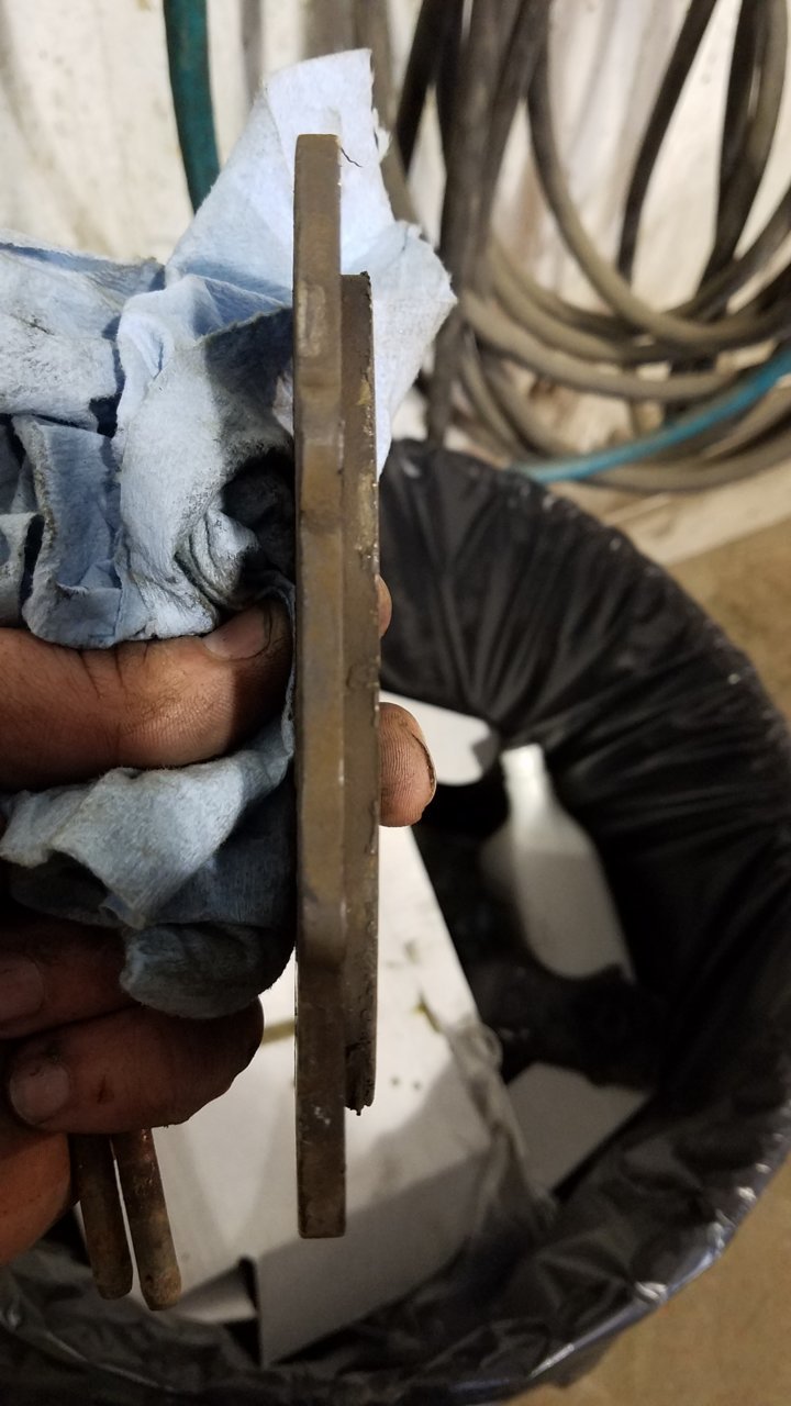

    Put in work today. I'm fucking wiped. I blame my current health issue because it's not usually this bad. I started losing steam after the first side, and it just went down from there. Anywho... enough of my whining. On to the work.
    Installed @glorifiedwelder gussetted spindles, 2010+ 4Runner front brakes with OEM dust shields, and @05Taco4x4 hubs/bearings. Also, retorqued the rear suspension (u-bolts, shocks, and leaf spring/shackle bolts).
    Behold the wonders of engine braking. Original stock brake pads with nearly 120,000 miles on them.
    Passenger side done.
    Caliper peaking out. Fills out the wheel pretty well.
    Random whole truck shot waiting for the pizza place to open after we finished. Only took 7 hours. :eek:

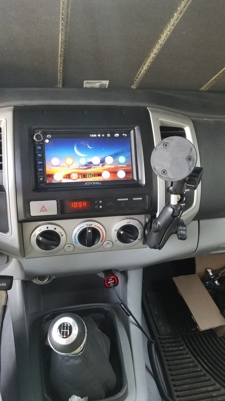

    Finally got my new radio installed. The Joying unit that I bought is a nonstandard DIN size, so it has been a struggle. I bought a Metra dash kit from a member and tried modifying it. That didn't work out, so I bought the CarAV 11-114. The radio face fit the dash kit, but none of the screw holes in the side plates lined up. Luckily, one of the guys at the job I just left has a 3d printer at his house, and he made me a set of custom side plates. He also printed a spacer to fill the gap between the dash kit and radio face.
    Oddly, the CarAV dash kit doesn't use the factory bolts. It just snaps in with trim clips. Hopefully, it holds up, and the PLA that the side plates are printed from doesn't soften and sag in the heat.

    You must be pretty pumped. My girl's Xterra is the basic bitch option and man dropping in a real radio with satellite and stuff totally changed the drive forever. Hard to believe she ever had it in there to begin with now.

    Yeah. It's pretty nice. I cut the antenna cable when I put on the fiberglass and removed the rest of the cable so no radio, but the bluetooth works great for streaming. I drove around a couple hours today.
    I didn't run the microphone, but the one built into the front of the radio seems to work well when I took a couple calls while I was driving.

    Damn thats one way to do it...I just bent my antenna and rotated the base that used to stick out of the fender to be horizontal so the antenna still works. That said I havnt really used my radio since.

    The antenna wouldn't come apart where it feeds through and attaches to the fender. It was going to be fucked either way, so I just cut the cable.
