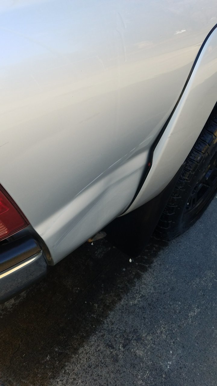

    I got in on the fiberglass group buy in early October and ordered fenders and bedsides. They finally got to the shipping terminal, and I picked them up on Dec 4th. I pulled them out of the shipping box and didn't find any shipping damage which is really nice.
    Yesterday, I went out to explore Bald Mountain with a group of local TW members. All of my pictures and pictures of my truck from other members are on my google photo: https://photos.app.goo.gl/usxOawX139n5xRAt2
    I didn't notice yesterday, but today I noticed that I bashed the rear bedside at some point.
