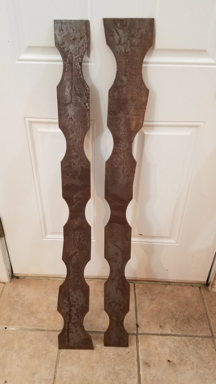

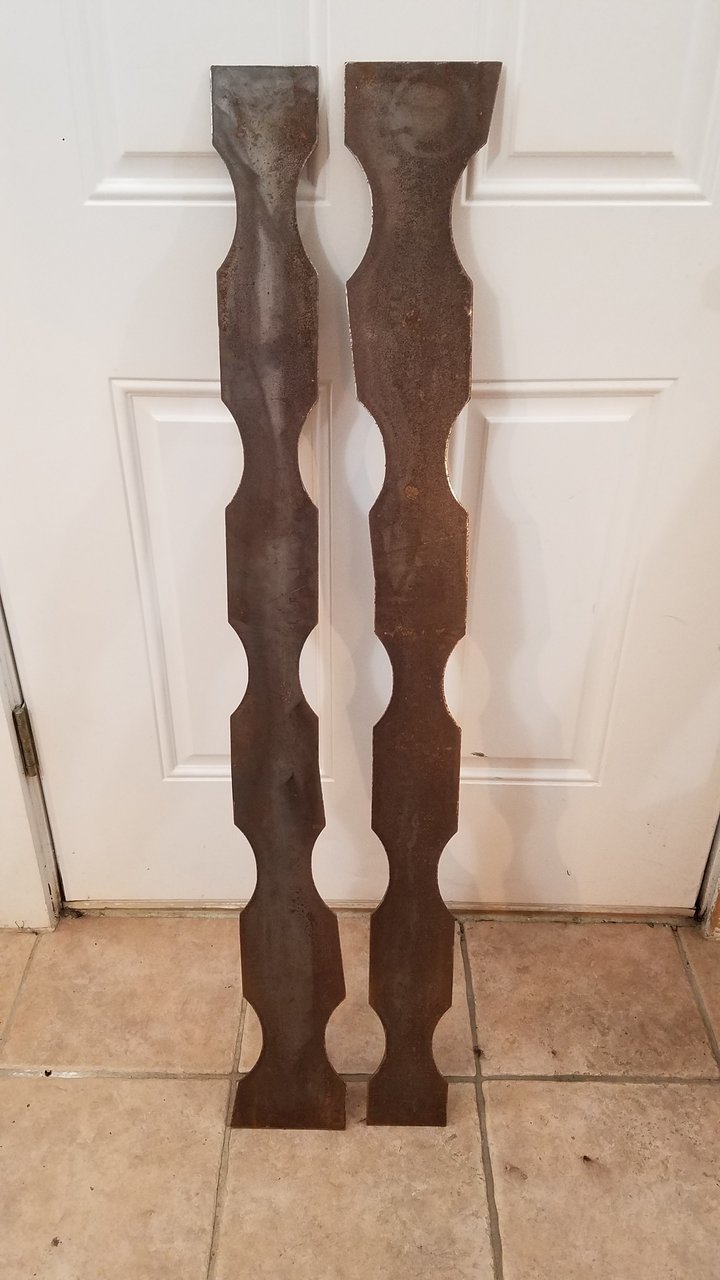

    I also finally received my frame plates from @jeffz0rz. They're dry AF and covered in surface rust, which means he doesn't bother recoating them with rust inhibitor after the plasma cutting process burns off the factory inhibitor coating on the plate. I guess 30 seconds of his time and a can of silicone spray or WD-40 is too much trouble.

    Bummer about the frame plates. Do you have to cut out the stock “x” in the rear in order to install the plates? Can you sand down the plates to remove the rust?

    Yeah. The stock crossmember that holds the spare goes away. The spare will live in the bed for the time being. A swingout bumper is on the wishlist.
    The surface rust will come off. If I have time tomorrow, I'll start working on removing it and give them a wipe with something to keep them from rusting again.

    Nice man sounds good then, half of my armor that isn’t painted had slight surface rust on them. With some 120 grit it came off pretty fast. I’m getting the dmz plates for mine as they are designed to get welded around the x cross member in the back. It’s a little more expensive, but should be simple to install.

    This is more than 'slight surface rust'. I think Jeff sells a set that keeps the stock crossmember.

    Wow man that’s kind of rough. Might take a little bit to clean that up. Tim’s plates are in pieces instead of strips like that.

    Yeah. It will take some work, but it's doable.
    Sounds the same as Jeff's plates that keep the stock crossmember. I think I read that they're multiple pieces as well.
