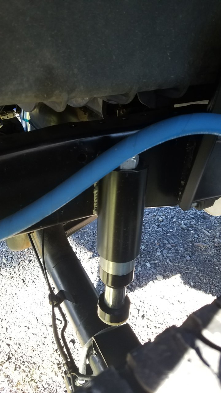

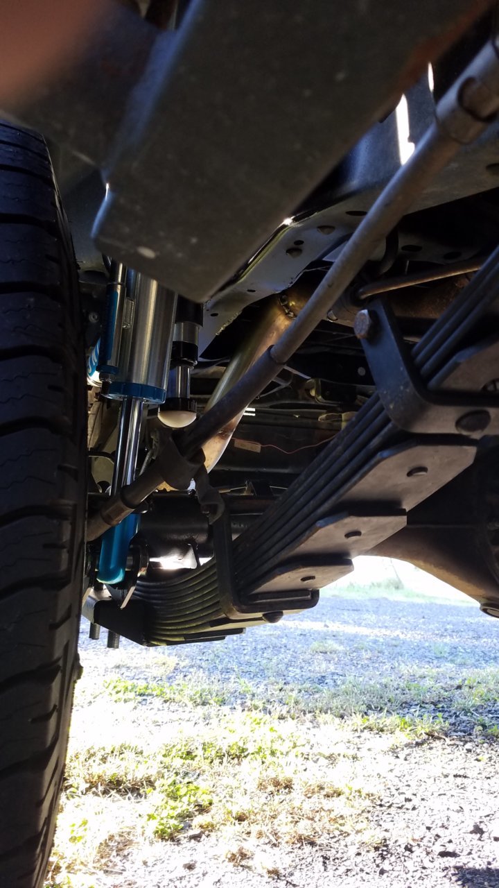

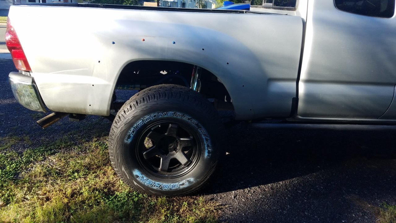

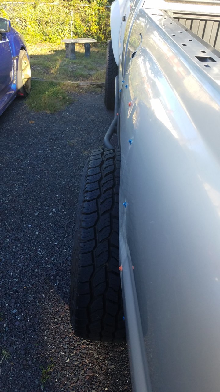

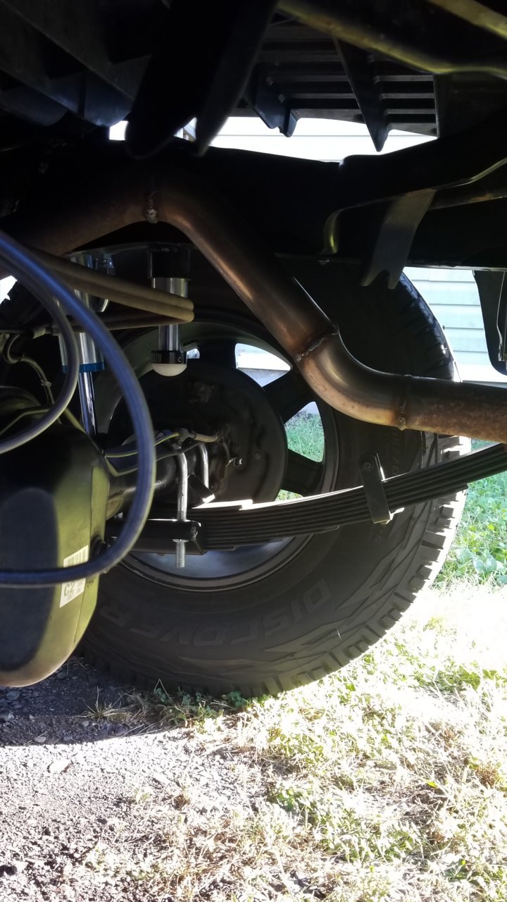

    Here's some pictures of the new rear setup.

    Hate to say it...your bumps look about as low as mine. If that’s the case, kiss a few inches of travel good bye.

    Look at the amount of shock shaft showing. That's all that's possible with my setup unfortunately. I saw that when I picked it up and instantly started thinking I'm going to need to upgrade to 16s through the bed.

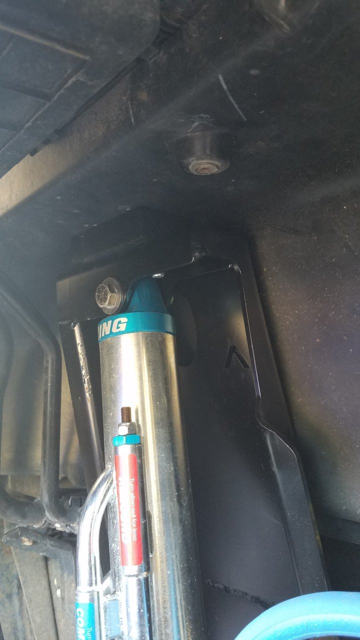

    In general, the install looks good to me, but I have a few gripes. :argue:
    1) In the last picture, you can see the plates that bolt the @ARCHIVE Garage shock to the wheel wells. His instructions say that it's not a bad idea to make a brace to go between them for extra rigidity, and I told Lance (the owner) at IPOR that was something I wanted done when I got the install quote and dropped off my truck. I talked to the guy at IPOR that did the work on my truck, and he told me that he talked to Archive Garage and decided that I didn't need it. WTF? :smash:

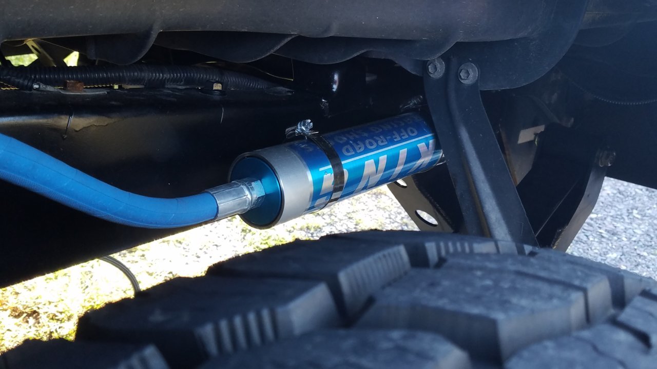

    2) In picture 6, see that spacer under where the soft brake lines attach to the hardlines? Apparently, the lines that I bought were too short, even though I called Camburg to ask what length line was needed when installing their SUA kit and ordered the lines in that length. They're only a couple inches too short, so I'll probably just buy new ones. However, IPOR never communicated in anyway that this issue existed. It's good that they found a solution to make the lines work, but I would have had them source lines the right length or ordered new lines myself if they had called me to tell me about the issue. It's not like there wasn't enough time, since it took them 7 weeks to finish my truck (they told me 2 weeks when I dropped it off).
    3) In picture 7, you can see the hack job they did to my exhaust. The original routing would have put it into the spring. Again though, they didn't communicate with me about it. They just did whatever they wanted. If they had told me about the issue, I would have just had them cut the exhaust just after the axle and weld the tip on. As it is, it nearly hits the rear shackle hanger, and it will hit when it that rear exhaust hanger slips out (it always does). Hell that rear exhaust hanger came loose and slipped to the end of the tailpipe when it drove my truck around.
    4) When I was talking with the guy that did the work on my truck (Lance was already gone for the day), he instantly started talking shit on my truck saying that it would never do what the parts on it were designed to do, asking why I was building it the way that I was, and how much better your setup is. That's some fucked up shit right there. :bananadead:
    5) They didn't install any of the limit strap hardware, but from what they told me, the shock have 1/2-1" of travel left before they bottom out when everything is at full droop. If that's true, then yeah, it's not really needed. However, I had to contact IPOR multiple times asking if they had installed the hardware before they gave me a straight answer.

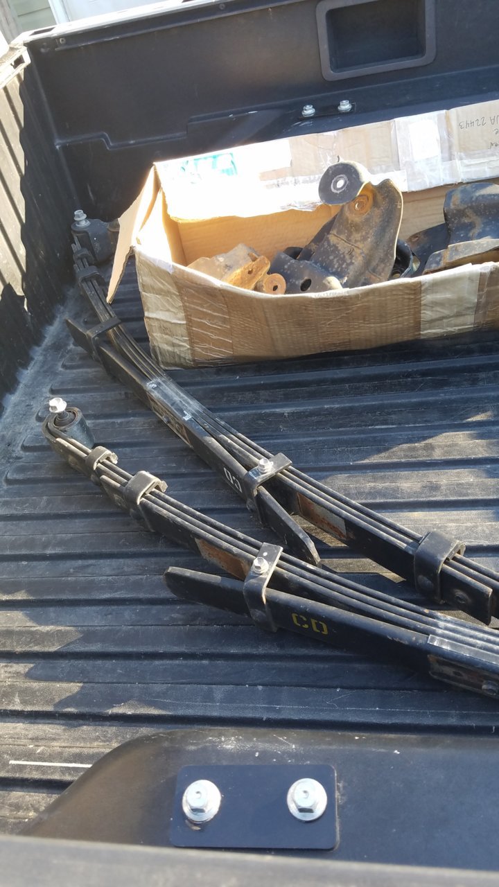

    6) The limit strap hardware and extra axle shock mounts that I provided (but wasn't installed) are rusted to hell and back because they left them in the bed of the truck outside.
    7) Their communication sucked. I had to email them anytime I wanted any information about how things were going. However, they were one me like flies on shit to get paid when they sent a partial invoice out. Fuck... They'd email me the invoice after lunch and then call me to get paid right before they closed at 5pm. To go along with the shit communication, when I dropped my truck off I thought my lug key was in the glovebox like usual, but it had been thrown in the box with my tools when I left the mod day at @Mr. Projekt's house a couple days before. I dropped the truck off on a Monday and called Tuesday to tell them where the lug key was because I hadn't mentioned it. I found the lug key that Friday morning while I was finally putting everything away. I took it there later that morning, and the lady working the desk (Nicole) told me that they had pulled the truck around 'the other day' and couldn't find the key. Instead of calling or emailing me, they just sat on it and didn't do anything. Who knows how long they would have waited before they tried getting ahold of me, or if they would have done god knows what to try to get my wheels off without the key.

    The axle tabs should be rotated way down, there should be 7" min of shock shaft showing. I have 7" on my truck with the std tabs, I'll be going to the deep axle tabs shortly. You're probably riding in the stiff bump zone cause they set the tabs so high.
    The bump can should be as high on the frame as possible, they set it really low
  13. Oct 13, 2018 at 7:45 PM

    So I just got done crawling under the truck and looking things over some more. The passenger side shock has 4.5" of shaft showing, and the driver side shock has 3.75" of shaft showing.
    Here's a picture of the axle tab that they did and didn't install. How do you like that pristine condition they returned the unused tabs in?
    Also, you're totally correct about the shackle leaning backwards past vertical, as you mentioned in your PM last night. I'm going to shoot an email to Camburg to make sure that's correct, and if not see if they can identify what IPOR did wrong.
