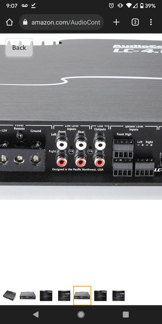

    Recently got done installing an audio control D4-800, some upgraded speakers, and a sound ordnance b-8pdt powered sub. I'm having issues with the sound ordnance sub. Almost every time it turns on, it buzzes for about 1/2 second at close to max volume. Not sure what frequency, but it sounds like white noise during startup.
    I'm wired from the stock head unit through speaker level inputs to the audio control amp. I'm using the bass output from the audio control amp(RCA's) to the sound ordnance. I'm using ignition switched power as the remote turn-on signal for both amps since the stock head unit doesn't have one.
    I've also added in a 10 second delay timer to the sound ordnance remote turn on. I thought maybe the head unit or the audio control was outputting noise during their boot up. Now the radio and audio control are fully booted and playing music and the sound ordnance will still buzz when it turns on. The only time it doesn't buzz is if I have the truck on, turn it off, then turn it back on within a few seconds. I've never had a sub that makes white noise during startup. It's really annoying. Any ideas?

    Power up the sub with audio lines disconnected. If it still buzzes then you know it's a sub problem and contact support accordingly. If it doesn't buzz, you might have to choose a different input.
    Edit, also, I don't know how your 4 channel outputs to RCA. Are you sure they are low level outputs? If not, you need a converter.

    The 4 channel audio control has programmable line level outputs (either full range or subwoofer). They're programmed for sub outputs right now.

    Does the amp auto convert from speaker level input to line level output? I would almost be tempted to put an external converter and tap the sub directly to the front speaker inputs, for sake of troubleshooting simplicity.

    Yes it does. It has a built in DSP and as I understand the manual, it sums the front and rear speaker inputs, applies it's internal "accubass" logic to correct for the factory head unit roll-off, uses the internal low pass filter, and then outputs the preamp signal to an external subwoofer amp. There's a lot of options for what can come out of the line outputs, it's all programmable in the audio control software.
    I'll disconnect the inputs from the sub today and see if that helps, but I'm really hoping it's not the audio control amp that's causing this. I bought it specifically for the DSP and control in correcting for the factory head unit. The sub also has high level inputs, but it won't correct for factory roll-off, so I'll be losing some capability going that route.
