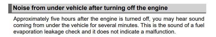

    My 2023 V6 SR5 is sitting in the drive. About 20 min. earlier (wild guess) I opened the passenger door to look at something inside and shut the door but didn't lock. I came back and heard a buzzing under the truck near the rear. Stuck my head under and seemed like it was coming from near the center of the vehicle but I didn't track it down completely. I listened for a minute thinking it would stop but it didn't. I peered inside and didn't see any lights on the dash but it was bright out so might have missed it. Opened the drivers door and it continued. Shut the door and after a short delay it stopped. Now I am very curious what it was. Seems like it could run the battery down eventually. Any idea what this is and why it was running?

    Just the EVAP test running, 2nd gens do it as well. It's in the owners manual.

    I heard something similar after filling up and parking at home. Few hours later I hear an odd noise coming my truck. I narrow it down to around the left rear side near the gas tank. Since the sound is kinda near the gas tank area I opened the gas cap and hear a whoosh of air and then the noise stops.
