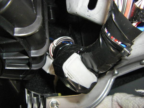

    [​IMG][​IMG]
    ok here is what i did i took all that black wrapping off the big wire harness, then i unplugged ever single harness and wrapped them with electric tape then put on a few zip ties. those are the best photos i could get to try and help.
