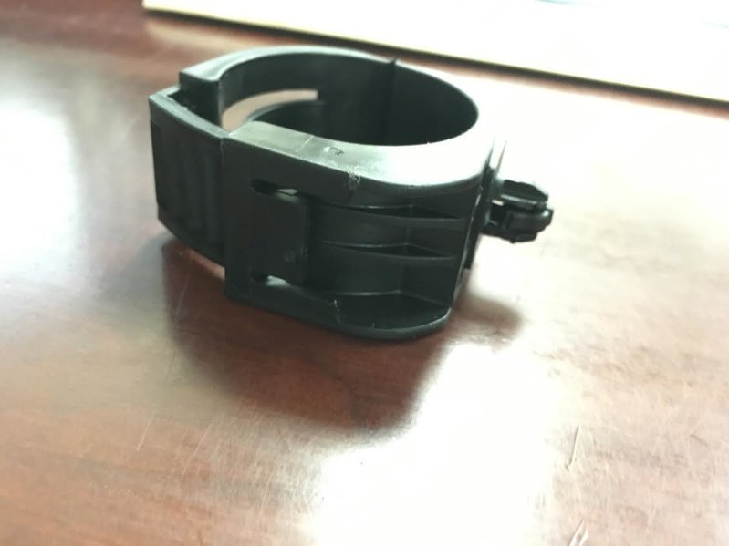

  13. Oct 15, 2016 at 7:44 AM
    #33
    uurx
    uurx Well-Known Member
    Mar 12, 2015
    #150723
    9,923
    long island, new york
    '12 t|x pro
    @ChadsPride hey you still got the rattle behind the glove going on??
    today I ended this stupid sound....
    in my case it was removing this plastic clip pictured below, contrary to what many have said in this thread being the culprit
    I removed the glove box as well as the black panel above held in with 1x 10mm bolt
    on the right hand side you will see a thick group of wire harness tucked against a metal bracket. with this clamp around it securing it still (and noise)
    remove the clip all together and bend the bracket a tad away from the harness so that there is no contact between the two
    sorry I should have taken pics during the process.

  15. Jan 1, 2017 at 9:41 AM
    #35
    uurx
    Mar 12, 2015
    #150723
    9,923
    '12 t|x pro
    pull the box off and take a drive and see if it is still making sound
    you can stick small felt like strips in spots where you have plastic on plastic resting on one another
