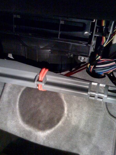

    I had this same problem on my '09. Open your passenger door and make a fist. Gently tap the side of the dash board that would normal butt up against the door. Its kinda on the side where the AC vent is. If you hear the sound then you have the same problem as me. Sounds like pencils in a can rattling around.
    I had to ride around with my glove box out and a broom stick and poke around till I found the noise. Turns out (for me anyway) it was the plastic bar that the glove box attaches too. I took a small bungee cord and wrapped around the bar and then pulled snugly and attached the other end to the body mount.
    Fixed my problem. If you want pics I can snap a few.

  11. Jan 24, 2009 at 11:27 AM
    trailmaster308
    trailmaster308 Well-Known Member
    Dec 17, 2008
    #11657
    107
    Louisiana
    PreRunner 3" Toytec Adj Coilovers 2" AAL
    As requested.

    Not sure which suggestion worked, as I zip tied anything I thought in the wiring harness might be making the noise (behind the kick panel and also behind the glove box). I also used a large zip tie (in place of the bungie cord as suggested above) and no more noise. So, while I cannot say exactly which one worked, the combination of the two did the trick. It is nice to finally be rid of that irritating noise. Thanks for the recommendations !!!!!!!!!!!!!!!
