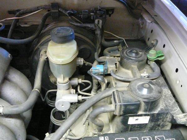

    I pulled this photo off the web, but I circled the box I'm talking about.........

    Yep, that's the beast.
