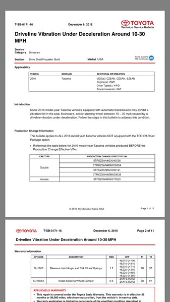

  14. Dec 27, 2016 at 7:39 PM
    #2234
    SK bassin
    SK bassin Well-Known Member
    Dec 27, 2016
    #205837
    89
    2016 Tacoma XP package
    Your welcome GUYS
  15. Dec 27, 2016 at 7:40 PM
    #2235
    SK bassin
    Dec 27, 2016
    #205837
    89
    Check out what I just posted
  16. Dec 27, 2016 at 7:41 PM
    #2236
    SK bassin
    Dec 27, 2016
    #205837
    89
    Here ya go
  17. Dec 27, 2016 at 7:49 PM
    #2237
    Koitz
    Koitz Well-Known Member
    Sep 15, 2016
    #197378
    691
    2016 TRD sport 4x4 DCSB 2" lift 285/65/18 and loaded
    2" lift,18"rims, 32" tires,pro shifknob, black emblems etc
    I knew about that tsb
    But that's not the vibration that I was talking about.
    When the truck is between 1800-2300 rpm the pedal "vibrates" a little bit.
    Is more like a buzzing feeling than a vibration.
  18. Dec 27, 2016 at 8:06 PM
    #2238
    SK bassin
    Dec 27, 2016
    #205837
    89
    Ohh my bad.
    Also I think we both have the same issue. Mine deffintly feels like a buzzing feeling too.
    It doesn't bother me too much I just feel it.
    What do you think it is
    Koitz[QUOTED] likes this.
