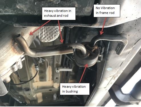

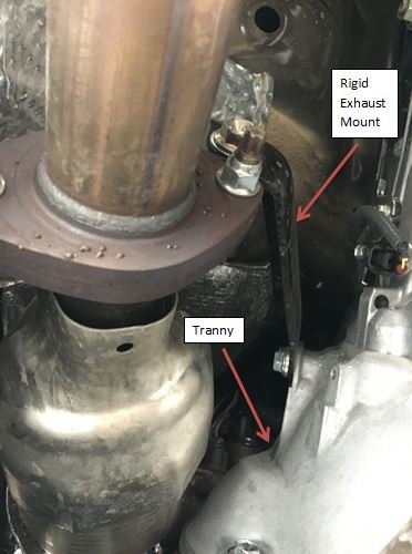

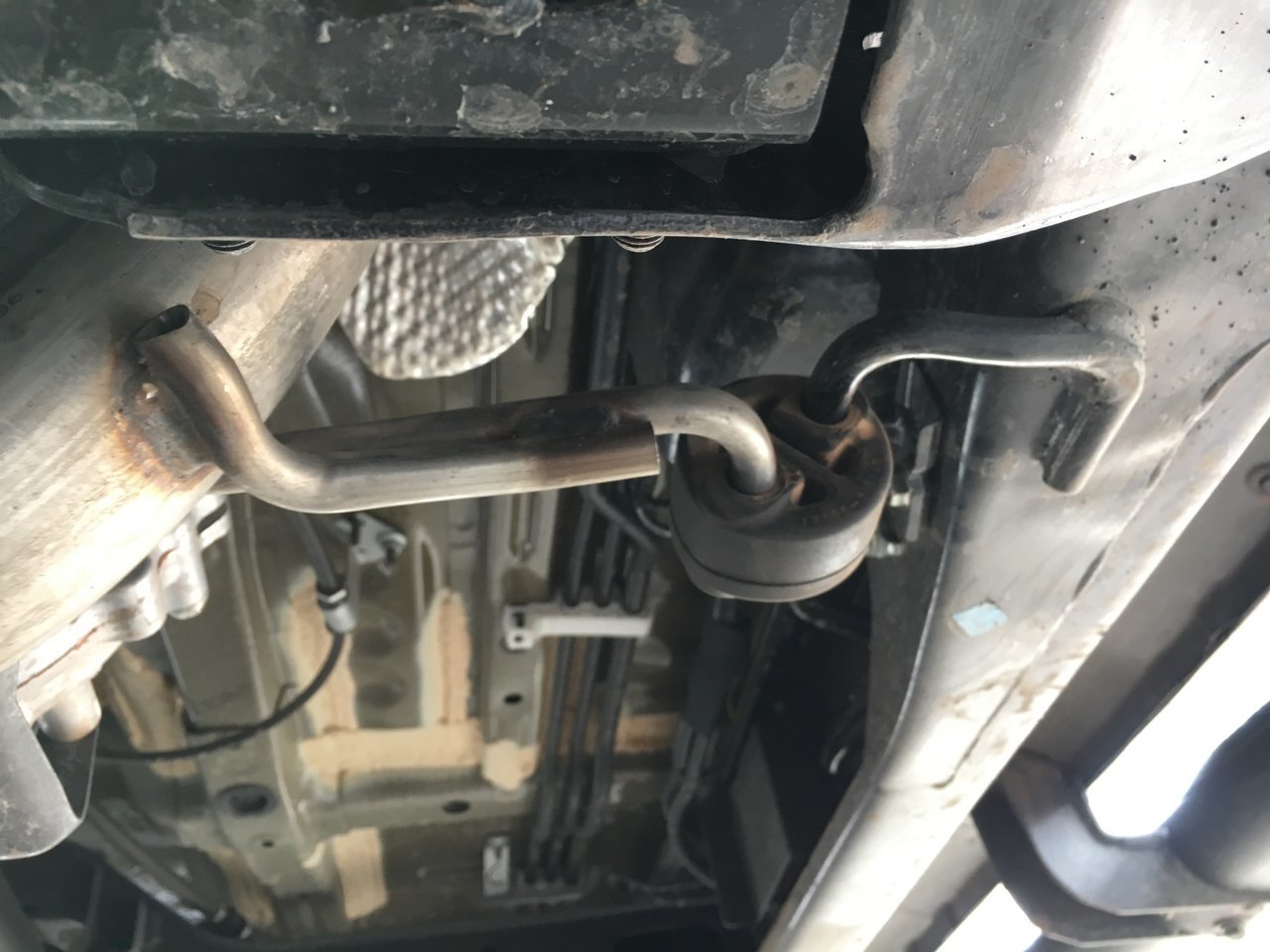

    I've heard a lot about how the vibration felt in the steering wheel and floorboard during acceleration may be due to how the exhaust system is set up. Today I went under the truck and checked the exhaust mounts and bushings, along with other points under the driver side cabin (after the engine was warmed up).
    A few observations regarding the exhaust system:
    The whole exhaust seems to be having some heavy vibration for idle. I'm willing to bet money that this vibration gets worse in certain RPMs. I don't think the exhaust being mounted to the tranny like this helps either. Since the exhaust is right under the floorboards it makes sense the vibration is felt in the floorboard area. Steering rack and column did not seem to be vibrating at all during idle. It would be interesting to get the truck on a dyno and see how the exhaust vibrates under certain RPMs. I'm also willing to bet money fluid dampening engine mounts would help relieve this issue. I will be running ethanol-free VP racing premium octane to see if that helps smooth out the flow...I think vibration got worse when I filled up with some crappy ethanol blended fuel. Thoughts appreciated...
    Patrick1046 and dtsnfire19 like this.

    Do think harm would be done removing the screw holding the brace to the transmission and taking it for a short drive to see if this reduces the vibration? I haven't looked at mine lately to see how much support the brace is providing.
  11. Mar 8, 2017 at 6:00 PM
    #2291
    aero90
    aero90 Well-Known Member
    Feb 10, 2016
    #177781
    1,774
    2016 TRD OR 4x4 M/T - Sold
    It would be fine for a short drive, however, I think many pages back someone may have already tried it. I don't remember it making a large difference.
    Main theory so far is Engine Mounts and/or exhaust resonance. There could also be a design flaw where external vibration sources (engine/exhaust) is exciting a natural frequency of the body, but if that is the case, that is some really piss poor engineering. I'd be really surprised if that slipped through the cracks.
    The exhaust as the source theory can be tested with either a helmholtz resonator or mass dampers correctly implemented at the right places (the latter method is a bit tougher without a model of the system and would require a lot of trial and error).
    The engine mount as the source theory we are kind of stuck on. The Lexus ones don't line up the same so it would require fabrication of new mounts.
    Basically both theories cost a lot of time and money which understandably nobody wants to have to devote to it. It is easier and cheaper to just trade it in.
