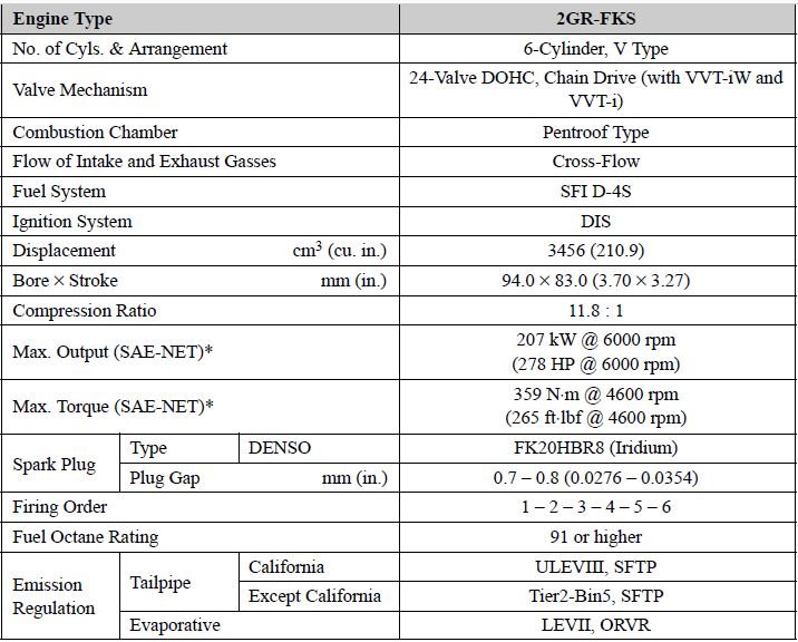

    The vibration in mine really isn't that bad...it doesn't make my hands go numb like some people have reported. Running ethanol free high octane seemed to help though. Engine is designed to run off 91 octane or higher according to these specs...

    My owner's manual says 87. Where did you get the above spec? I haven't had any issues fuel wise using 87. I'm not feeling the 2k vibration much either.

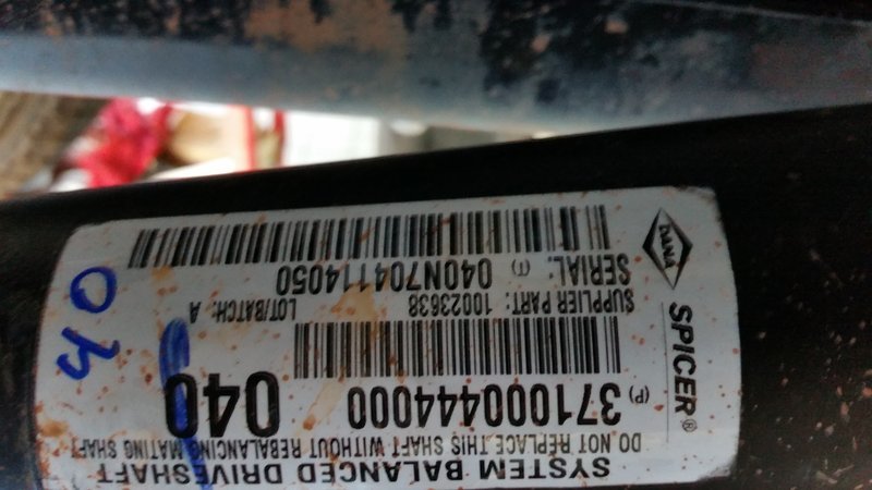

    I have a '17DCSB
    and I didn't see any part # for motor mounts.
    the drive shafts are made by Dana Spicer
