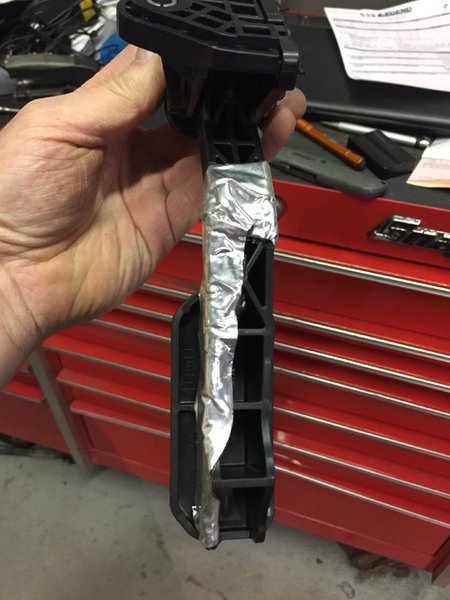

    My truck never seemed to have this issue much other than 5th gear at the RPM range where it occurs, for me that was 2100-maybe 3000 or so.
    My vibration has all but vanished after I installed sumosprings. I also adjusted the exhaust hanger right by the axle while down there. I also wondered if maybe when I put the U bolt, uh...plates?, back on maybe I moved them somehow. Regardless my vibes are non existent at this point.
    The sumosprings were not installed for any reason to do with this issue, just the normal reasons for them.

    3200 miles later and is a non issue. sucks toyota wont do this but for everyone else crying the blues, missing days at work and wasting time on the phone with corporate i suggest you take matters into your own hands.do a search of my posts to see all the pics and my repair. post #2343 the root cause of the vibes will probably never be rectified but you can certainly make your driving experience more tolerable. now i only hate the auto trans and the seat/headrest!!

    Okay Guy's new poster here with a 2016 vibrating Tacoma. 25000 miles and it's annoying. I read about 50 posts here today and I agree that it's possible that it may be exhaust related. I'm 63 years old and been a Porsche,BMW (master tech) Mercedes and VW mechanic. I currently have a full shop at my house and repair old air cooled 911's. I too complained to the Toyota dealer and reps wit no joy. I'm thinking of welding in a couple of stainless flex pipes (like the front pipes in transverse mounted engines) in line with the exhaust. I'll keep you posted.
