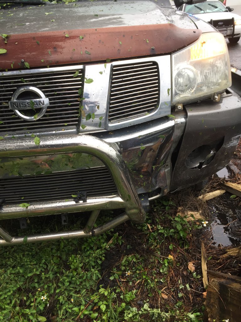

    Well I drove one of the trucks I intended to consider buying. Came within 1200 of making the deal. Left. Merged on interstate and the truck hydroplanes out of control. Hit the dirt, guard rail and I killed my freshly cleaned trade in. I'm fine. Wife is fine. Got a ticket. Dealership calls me tells me the truck sold.
    Well I guess I'll start drinking.
