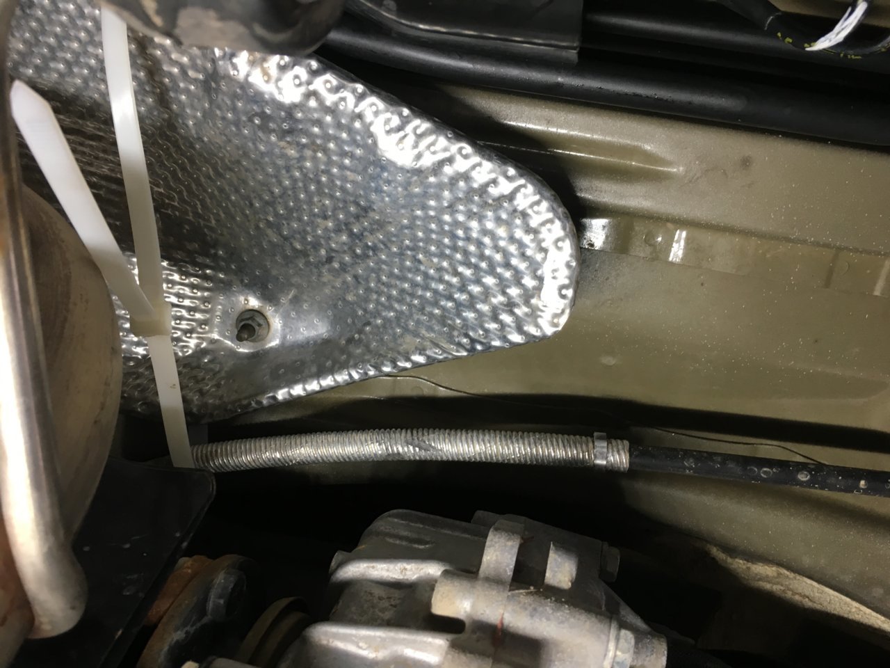

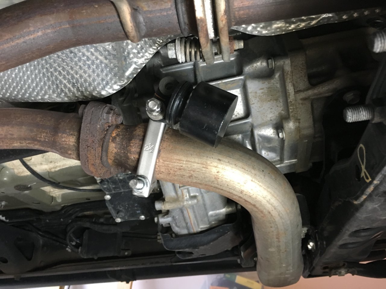

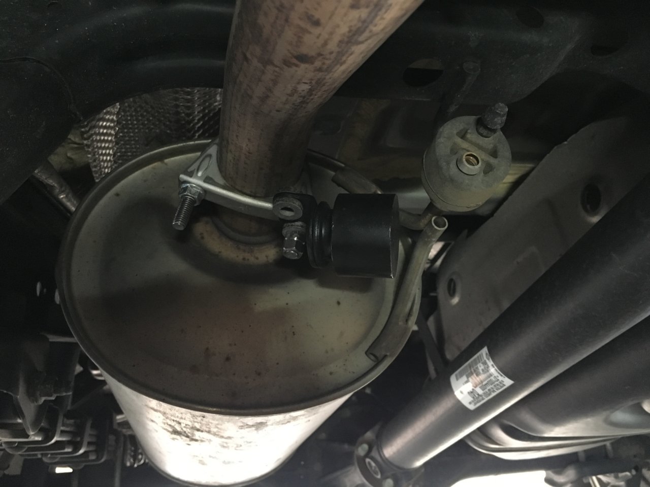

    Sad to report, but this (so far) HAS NOT worked for me :(:(:(
    I tried both in front of the muffler, and just ahead of the y-tube (see pics). I also tried getting the loose cable off of the TC as Bshammer0 notes (used a zip tie around some heat shielding), and no difference. I also tried cleaning the Maf. Alas, my gas pedal is still the worlds worst sex toy :mad:
    I did order two more dampers though, so I can try more locations. It's a cheap enough solution to try the "throw money at it" approach. Still, I worry that this is a transmission related problem, as the vibrations are far more subdued.
