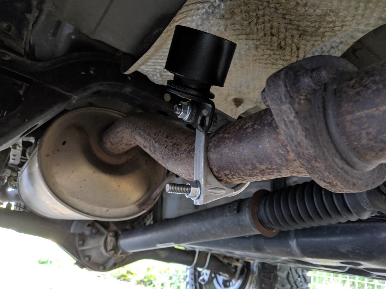

    Initial feedback from adding the exhaust dampener is a resounding improvement. Vibration was minimized throughout the range such that I didn't even notice and even forgot about it for a lot of the drive. It was not long distance so I'll update further as I drive more with it.
    Dampener was placed between the connection and the muffler.

    Part number is 17581-31010, searching online should give you a bunch of options. Make sure you use a clamp with a diameter that fits, one from Amazon did not but one from Napa was good.

    After several thousand miles, I can say no. I'm going to add one or two more and change where they are to see if that helps. I did put it pretty far toward the muffler.
