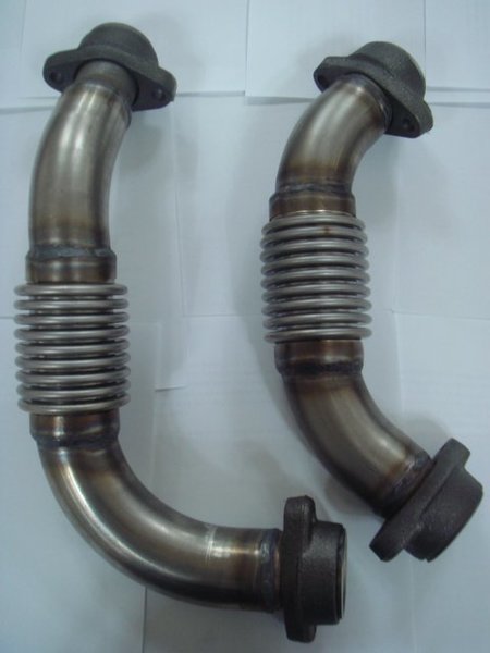

    2016 MGM Tacoma Limited 4x4 (sold)
    I would be curious if modifying the exhaust system with something similar fixed the issue.
