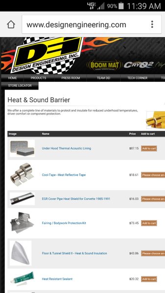

    If the exhaust shielding is the cause & Toyota will not address the issue here's something that may help:

    What about a rubber grommet as a washer between the heat shields and their mounting surface?
  19. Feb 24, 2016 at 5:43 AM
    #519
    gen3
    gen3 Member
    Dec 12, 2015
    #172022
    17
    A rubber grommet will either melt or catch fire because of the high temps of the converters. One way I use to eliminate converter heat shield buzz/rattle [without removing them] was by wrapping a large stainless steel hose clamp around both shields and tighten up. This is an easy fix that puts pressure on the shields and will eliminate buzz/rattle and also may be a quick diagnosis procedure to eliminate the shields. If anything it may change the buzz/drone/harmonics if it heat shield related.
