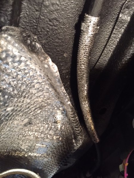

    I have had this annoying heavy-duty clanging/rattling at low RPM and when shifting (manual trans.) from day one. It sounds like what you just described is likely the source. I'm going to check it when I get home and that will be awesome if it fixes at least the noise.

    Can you take some pics while you're under there?

    @gen3 any chance you could take a pic or two of what you did? I'm happy to take some, but I'm a noob.

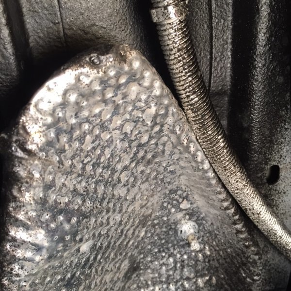

    Here's a couple of pictures showing before and after. You can see how close the cable is to the shield. Mine was about 1/8". After I bent the shield it was about 3/4" away. Note, This shift cable is only found on automatic trucks.truck 1.jpg truck 2.jpg

    I did find this heat shield and it definitely is a vibrator. Since I don't have automatic there's no cable though, so I'll just have to figure out how to make it stop vibrating at least.
