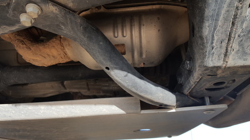

    Also, what is this? This is not the Catalytic Converter, is this an exhuast resonator? This sits directly below the area in the floor that I feel the floor vibes.20160513_070453.jpg

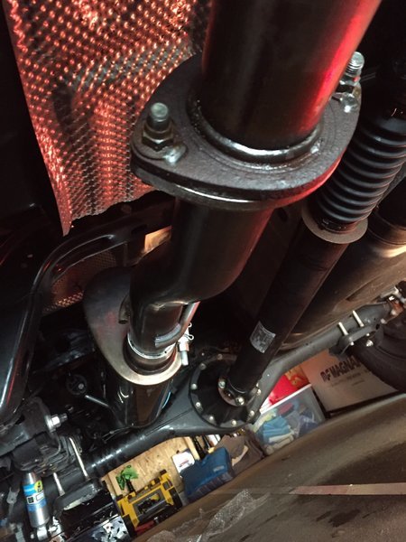

    Does you cat back delete the resonator that I have shown in my picture or does it start behind this?

    I did see your post. No it connects further back. Almost midway in the truck. image.jpg
