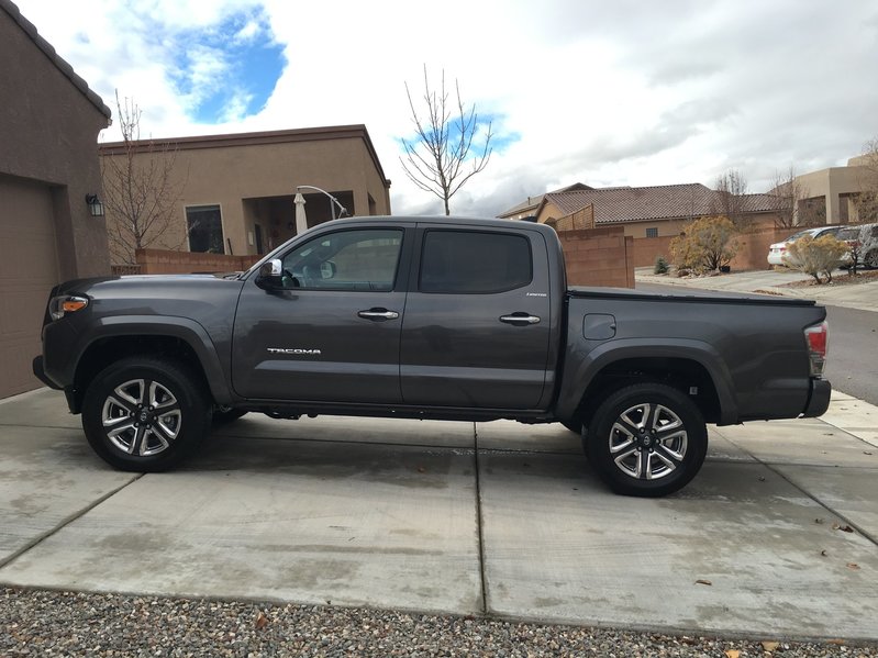

    Just picked mine up today. I can feel a slight almost unnoticeable vibration between 2100-2300 rpms. I only feel it when it's in those ranges and accelerating. Once I'm up to high way speeds and maintain it at those rpms I don't feel it. Hopefully that remains the case.

    that is a nice looking truck - congrats. hope the vibe issue fades away for you!

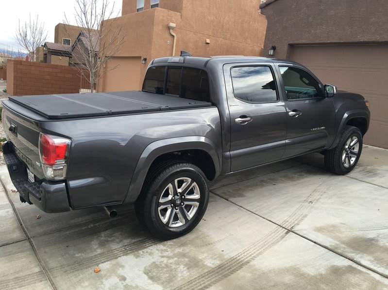

    Is that the oem cover?

    Yep, OEM tonneau cover.

    That's a beautiful truck! Same color and model as my relative's new Limited. Love the color and interior. Although the vibs showed up on his, they are very minor compared to mine--probably 80% less intensity. I'd take a reduction to those levels.
    Congrats on the truck! Sounds like you had quite a long wait.
