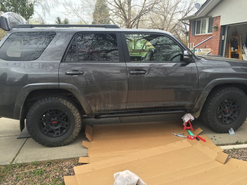

    I had a Taco on order, then test drove one off the lot and experienced the vibration first hand before ever even hearing about it, and was [very hesitantly] planning on still waiting for mine, but it turned out my family just wasn't going to fit in the Taco so instead I went this way and love it:
    I'm still following this thread, hoping there's a happy ending and I feel for the people stuck with the issue.
