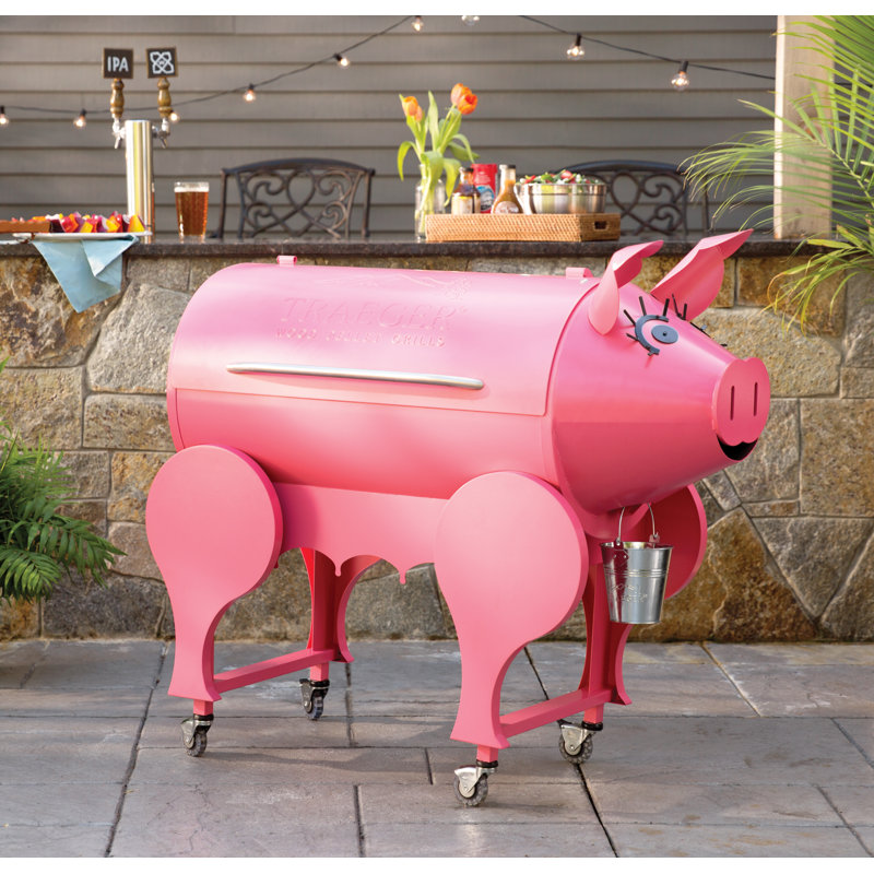

    Traeger already beat them to it..

    Only liked for the outdoor kitchen set up complete with a twin tap kegerator.

    yeah the pig is quite hideous...

    It does kinda hurt the eyes, doesn't it?
