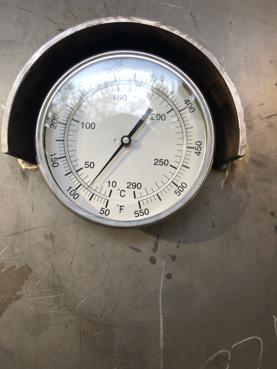

    5,745
    Bryan
    DFW, Texas
    2013 DCSB SR5 Prerunner Texas Edition
    Fresh wiper fluid
    Wow. That sure is one magnificently centered dial! ;) :rofl: ;) :rofl:
    That's honestly a little better than I'd expect! That's 20-1/2 hours after the torch hit and about 19 hours after coming up to temp. One bag of charcoal for that stretch and temps are still above ambient. It must have been burning a little heat not all that long ago. The rest is residual heat.
    Thanks for the update!

  12. Jan 20, 2020 at 7:34 AM
    #692
    Kanyon71
    Kanyon71 Well-Known Member
    Apr 29, 2013
    #103088
    12,319
    MI
    Yes but how many filled in holes are behind it?
    :rofl:
  13. Jan 20, 2020 at 8:09 AM
    #693
    bvbull200
    bvbull200 [OP] Well-Known Member
    May 17, 2016
    #187193
    5,745
    Bryan
    DFW, Texas
    Fresh wiper fluid
    That's kind of the inside joke. :laugh:
    We had all of the extra "stuff" done and it was rolling. Maner was ready for a celebratory pour of whiskey and I looked at the dial and said "you're going to think I'm crazy, but I swear that shroud is just off-center". Maner came and took a look, but couldn't really tell. We both agreed that maybe it was off, but it depended on how you looked at it and it would be unnoticeable once all painted up. Still, I told Maner to go ahead and pour him one, I was going to cut the three welds. The eye-roll was hilarious. :rofl: I think I just wasn't quite ready to be done tinkering with that thing. :anonymous:
    Three spot welds were all that was holding it on, so I cut them and moved that shroud over maybe 1/16 of an inch? I'll put it this way, the margin was so slim, there was a better chance I'd make it worse than make it better :rofl:
    It's centered nicely, though.
    I think....
    :rofl:
    :rofl:
    :rofl:

    I'd be way surprised if there were any coals left after 19+ hours. It was just one bag of charcoal. I'm kind of curious how much ash built up. There will be a point where too much ash could choke off the intake, but I think that will take quite a bit. Might need a sweep every 12 hours or so? Could probably do most cooks without having to worry about ash, but will have to clean it out before each cook.
    Maner has some plans for some handy tools, too. :D
    That isn't to say that Maner doesn't have an eye for those things, too. He's had plenty where he looks and just says "I don't like _______, we need to fix that." and we've gotten to work. This thing would look like hell if it weren't for his attention to detail and problem solving skills. The little brace he put in the chute and firebox doors was awesome and made the look and fit 100% better.
    I think the dial thing was more psychological to me than it was an actual flaw. I was jamming my fingers in the sides of it and saying "I swear it feels different on this side than the other!" :rofl:
