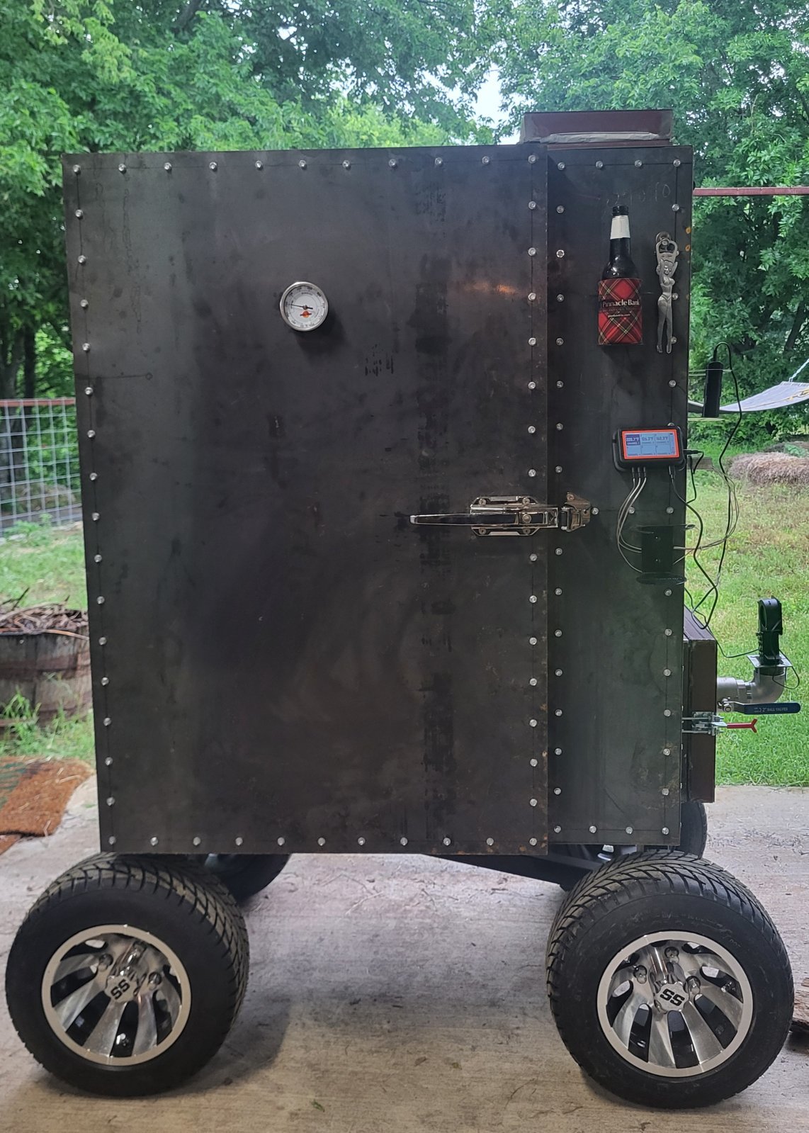

    I just ordered the plans from smoker builder, had a friend at a local steel building company CNC plasma cut all the flat sheets & firebox parts, I cut all the frame and fabricated the cart. I opted to use screws on all exterior sheet metal just for the look. I wish I had added an extra brace like y'all did the inside sheet metal sure was tough to get semi straight after warpage from welding.

    I should have the firebox & chute welded up tomorrow. I plan on having it running & seasoned by the weekend. I have to thank @Beef Nachos nachos for the cart idea when I saw his build awhile back I decided when I build one it will be sporting cool golfcart wheels.

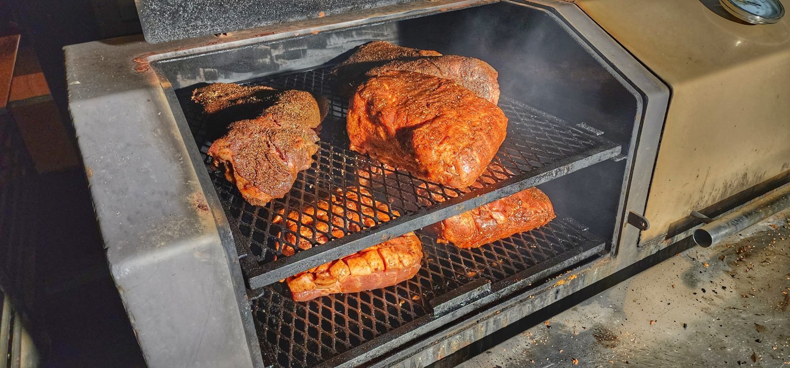

    I did cook beer in the butt chicken & baby backs both turned out good but my brand new Fireboard temp probe for smoker was reading over 100 degrees cold.
  20. May 12, 2024 at 10:53 PM
    #1040
    Vmax88
    Vmax88 Well-Known Member
    Sep 18, 2020
    #341220
    378
    Clint
    Joshua, TX
    20 MGM DCSB TRD Off Road 4X4
    Pick of bird & Baby backs
    The smoker was at about 375 degrees after the bird so I turned the fan down to 250 & opened the door for a few minutes shut the door & right up to 350 it went turned the fan off & opened the door & the damn thing kept climbing back up as soon as I shut the door.
    I thought the fan being off would block the intake enough to choke it down....not true this thing goes to 350 plus with the ball valve open & fan in place but off. I closed the ball valve to about 50% & it got down to 240 before I shut'er down so I think next cook I will open ball valve about 50% or so & see how it goes from there.
