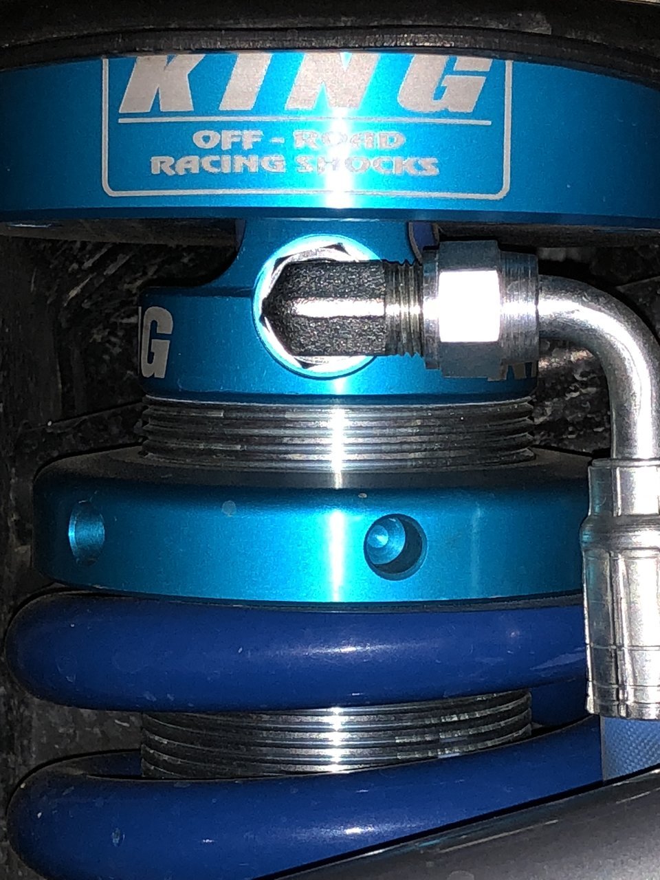

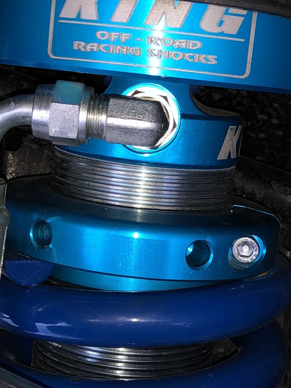

    Hey man sorry to bug you again but any chance you tell me the thread count showing on your front coils? Installing on Sunday and would love to only need to adjust once haha.
    ChadsPride likes this.
  3. Jan 10, 2018 at 7:57 PM
    #63
    BVita
    BVita [OP] Mall Cruiser
    Jun 30, 2014
    #133048
    3,971
    Not a problem! Im at 5 threads on the driver, 4 threads on the passenger and sitting at roughly 22 1/4” (hub to fender). I still need to readjust the fronts, but Im waiting the rear to settle down a bit more before I preload the front more.

    Was able to re look at my preload and measurements.
    Driver: counting 5 threads
    Passenger: counting 4 threads
    Roughly 22” Passenger and about 21 3/4 on driver with a full tank of gas. No extra weight on the truck.

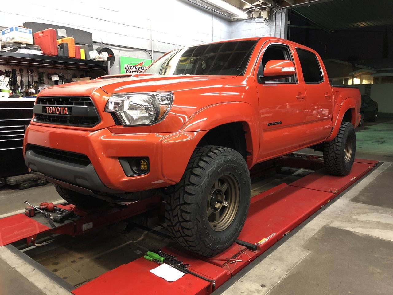

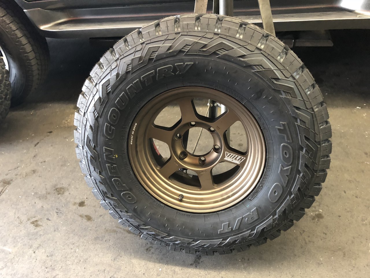

    Some more goodies, 285/75/16 Toyo RT’s
    loaded up, and met with @BanzaiChicken. Lookin overlander af

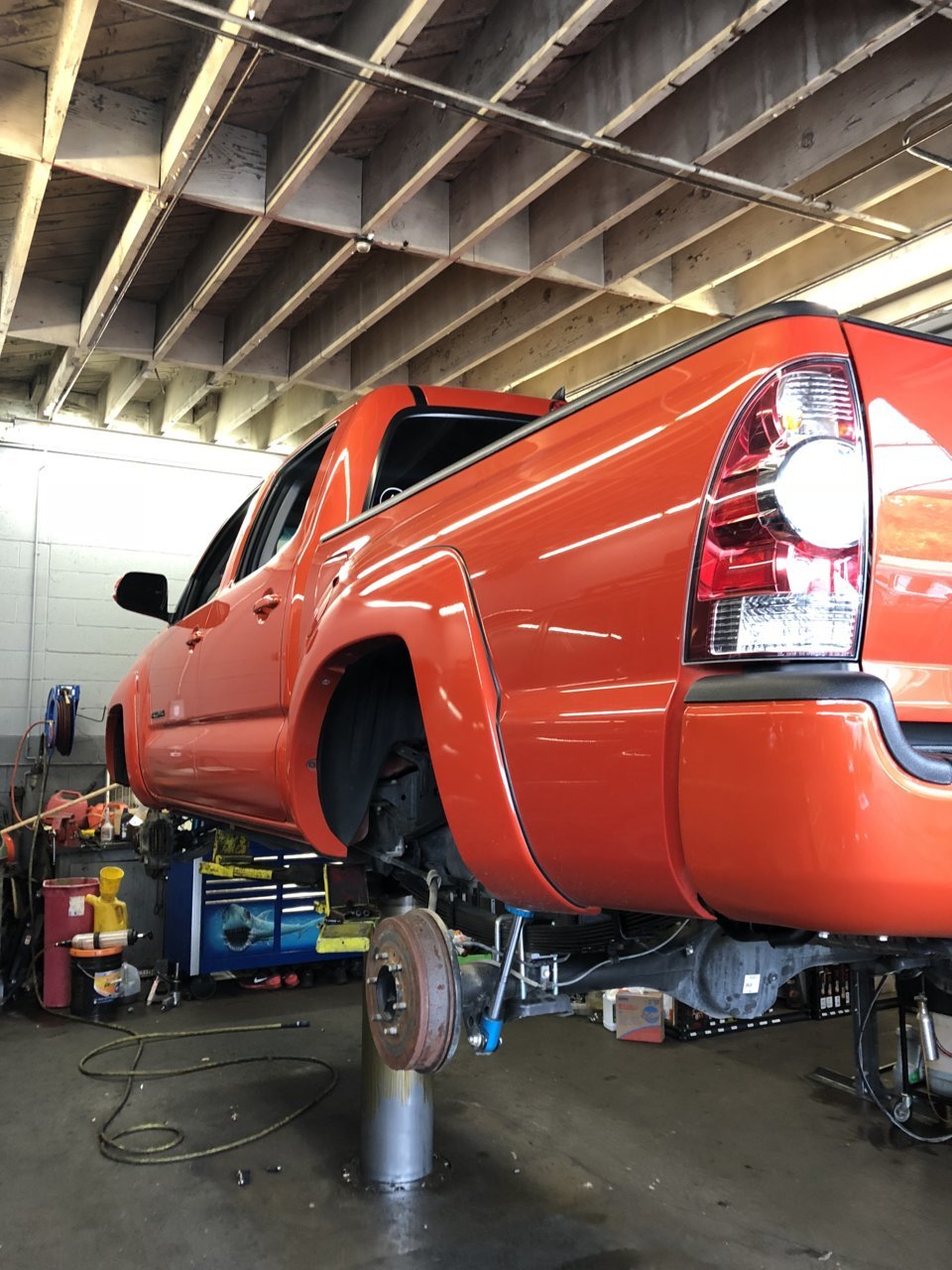

    Went over to RPM Garage to get my tires installed and to readjust my coilolvers.
    Brought the front up an inch and realigned!
    F: 23”
    R” 24”
    Should be done for this year :goingcrazy:

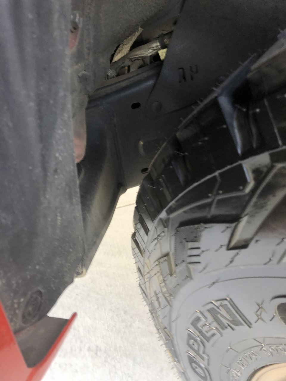

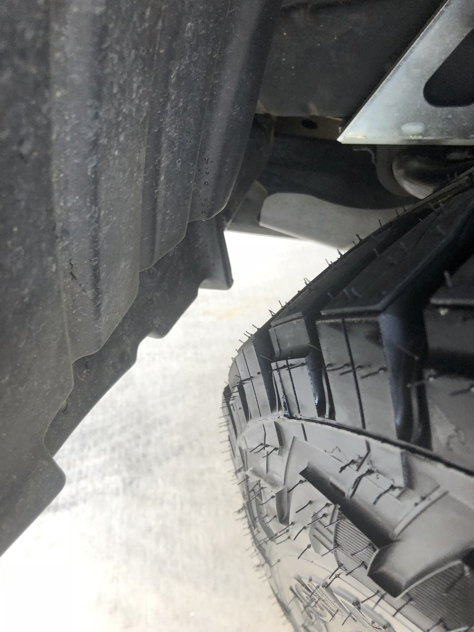

    35484529-8EDD-45AE-861A-43933372CFD6.jpg 2B7EAAE8-7B94-49BD-B9B6-407F1B0DFFD5.jpg
    Was hoping I wouldnt need to do a CMC for the time being/driving around on the streets. Im very surprised that I have room at full lock. I didnt even rub when going into driveways.
