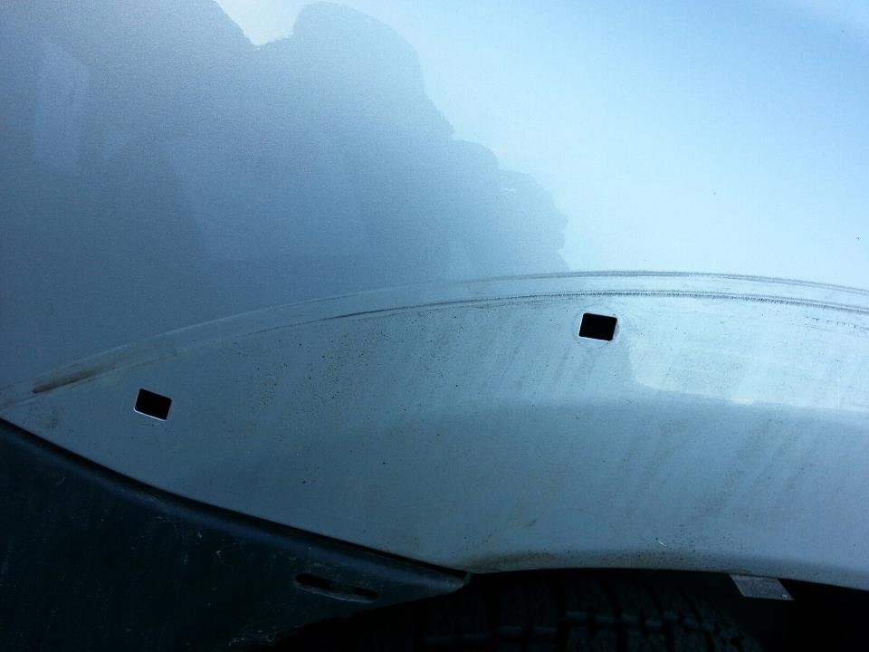

    Hello all. Well... after having my bush whacker fender flares on for over two years, I decided to take them off to get line xd. What was underneath made me sick. These flares completely rubbed my clear coat off every wheel well, and on two of them some paint was missing down to the bear metal!
    I love these flares, and without them my state will not allow me to inspect my vehicle. I fixed all the paint I could by sanding and touching it up.
    So now I am putting the flares back on. I read some threads on diesel forums of adding 3m tape behind the flares prior to installation to minimize any kind of rubbing. Any other suggestions? I will be putting them on tommorow.
    From a cummins forum (tundra owner) -
    "I had a 2002 Toyota Tundra. I took the flares off, when new, placed a layer of the 3M around the wheel well and placed the flares back on. My brother now owns the truck and recently had to repair one. The 3M tape was still in good condition and absolutely no wear through. I just did the same when I put on my Power Wagon flares. I don’t expect to have any problems.
    Jacob"

    It rubbed all around the wheel well. primarily at the top. The paint came off the front fender well (right above where the stock plastic bumper sits).
    This is a common problem with these flares apparently, and sadly I did not know this. What happens is they are loose, and tend to move with resistance. Dirt, salt, sand and water add to the rubbing and cause the clearcoat to start rubbing off. Next time you go down the road, watch the flare in your mirror, you will see the top lightly move due to wind resistance.
    With the stock flares this happened very lightly. I have now line xd the BW flares, and am using 3m tape in certain areas. I will take pictures tonight before I put the flares on, as I am in Clinical all day. The line x is pretty thick so these flares aint gonna budge or move whether im going 10 mph or 100.
    If I were you, I Would make sure the flares are as snug as possible. Use something like 3m tape, or anything that has minor padding and choose for spots near the top of the flare and mount it there. I am going to put 3m sticky pads every quarter of the flare (adding up to four pads) I think this should really stop the rubbing (if any of this makes sense)..
    I wouldn't worry too much, but If I were you, tonight take off your right or left rear fender flares and see if it has left any marks on your clearcoat. If so, immediately go to the hardware store and by 3m tape. When applying this tape, make sure surfaces are clean and the tape is higher near the top, where the salt and sand don't accumulate as much. Will post pics later.
    Still any suggestions other than 3m tape would be greately appreciated. Thanks!

    Here is a pic, sorry the truck is dirty but you can see where the clear coat has rubbed.

    Maybe find a local clear bra installer and get them to do your fenders around the area of the bushwackers to extend out past the edge. Shouldn't be too expensive and will protect the area well.
