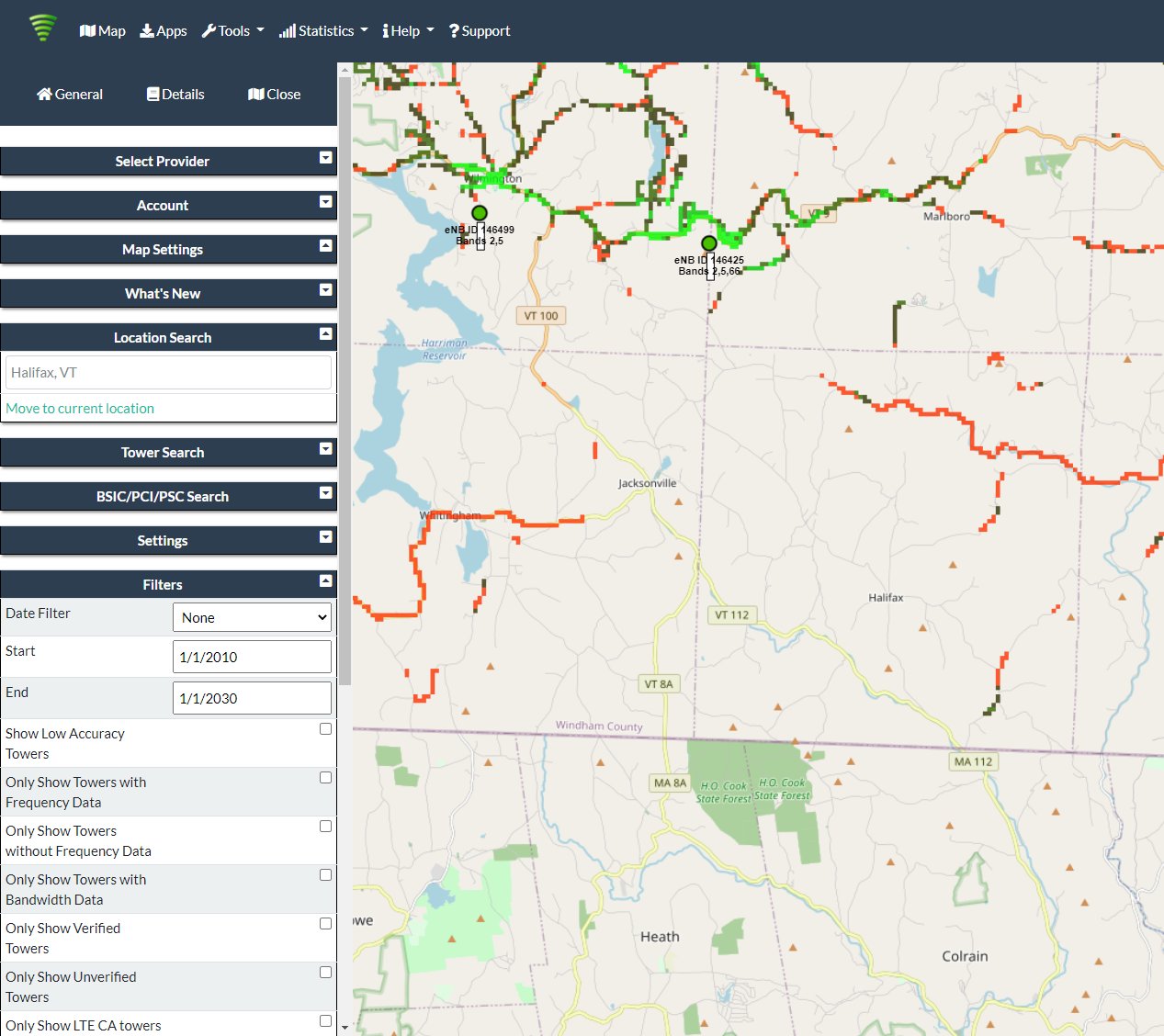

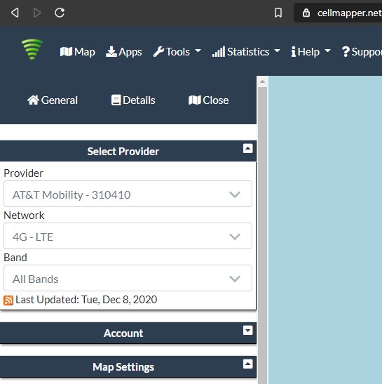

    First start with "Select Provider" in the upper left. Scroll down to find the country you're in, and then, using the MCC and MNC (from your smartphone app), choose the provider that corresponds to the info you collected with your smartphone.
    Let's just use AT&T in the United States for this example. The MCC and MNC are 310 and 410 respectively, so in the drop down select the appropriate options. Note that I've also selected the Network Type (from your smartphone app), in this case LTE.
    Use the location search drop-down to narrow your search geographically. I arbitrarily chose Halifax, VT. You'll obviously choose wherever you are in the world.

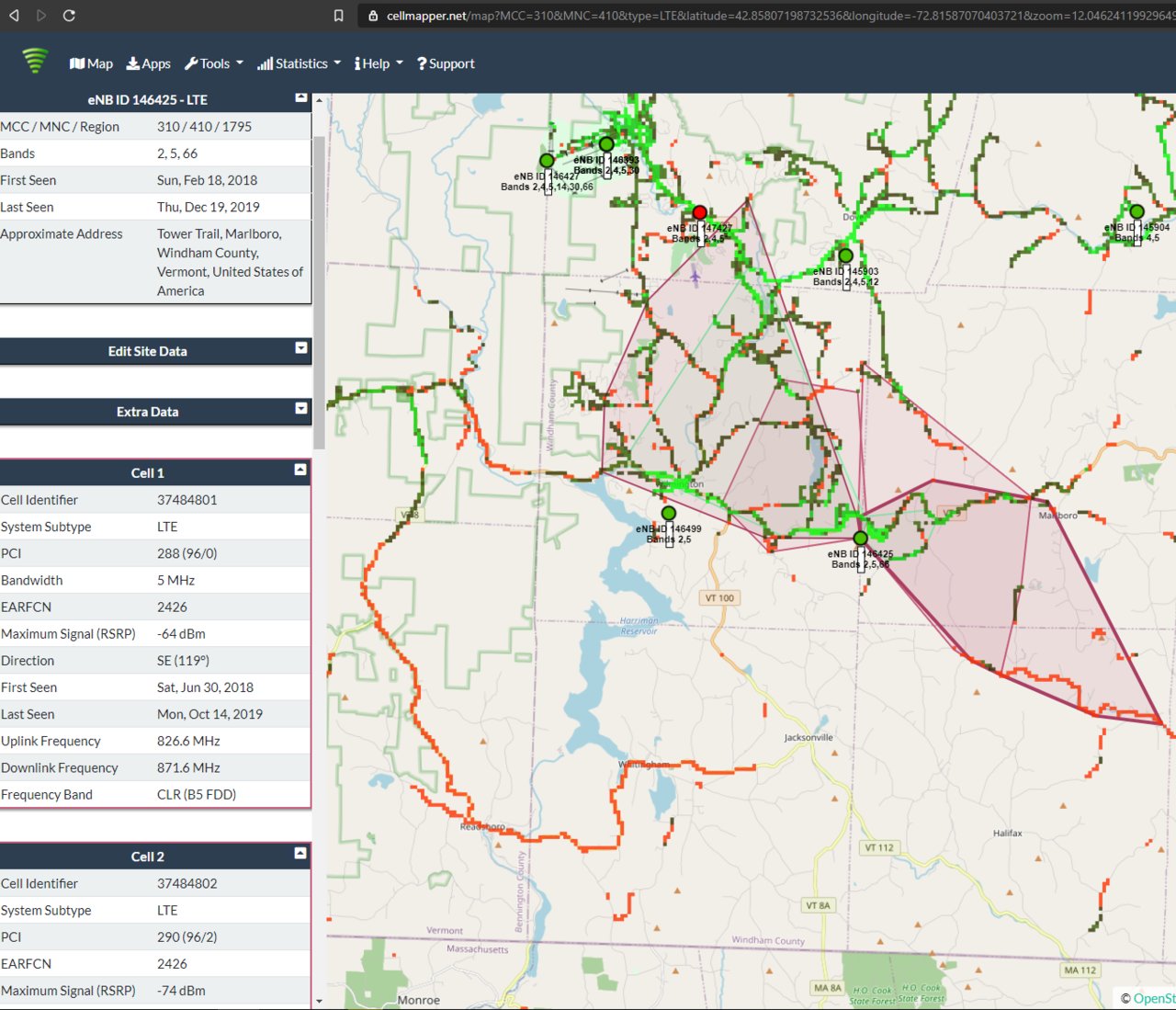

    Zooming out a bit, we can see a tower that might be the one we're looking for:
    Let's click on the tower and see what cell panels are on it, and if any of them match the CellID that we collected with our smartphone:
    You can now see each cell panel (there can be MANY on a given tower) and its corresponding footprint and information. Hopefully, one of the Cell Identifiers corresponds to the one we're looking for, which will let us move on to the next step - orientation and inclination of our directional antennas.

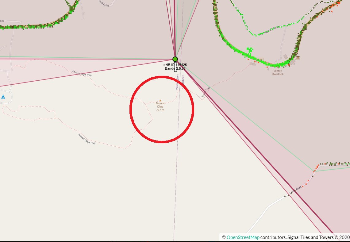

    Now, the locations pinned on this map are NOT exact. However, if we zoom in a bit and use some logic:
    I'd bet this tower is on the top of Mt. Olga, or VERY close to it! This gives us coordinates and an elevation to aim our antenna at. (A quick peek at Google Maps says there's a fire lookout tower on the top of Mt. Olga. I bet our cell panels are glued to it!)

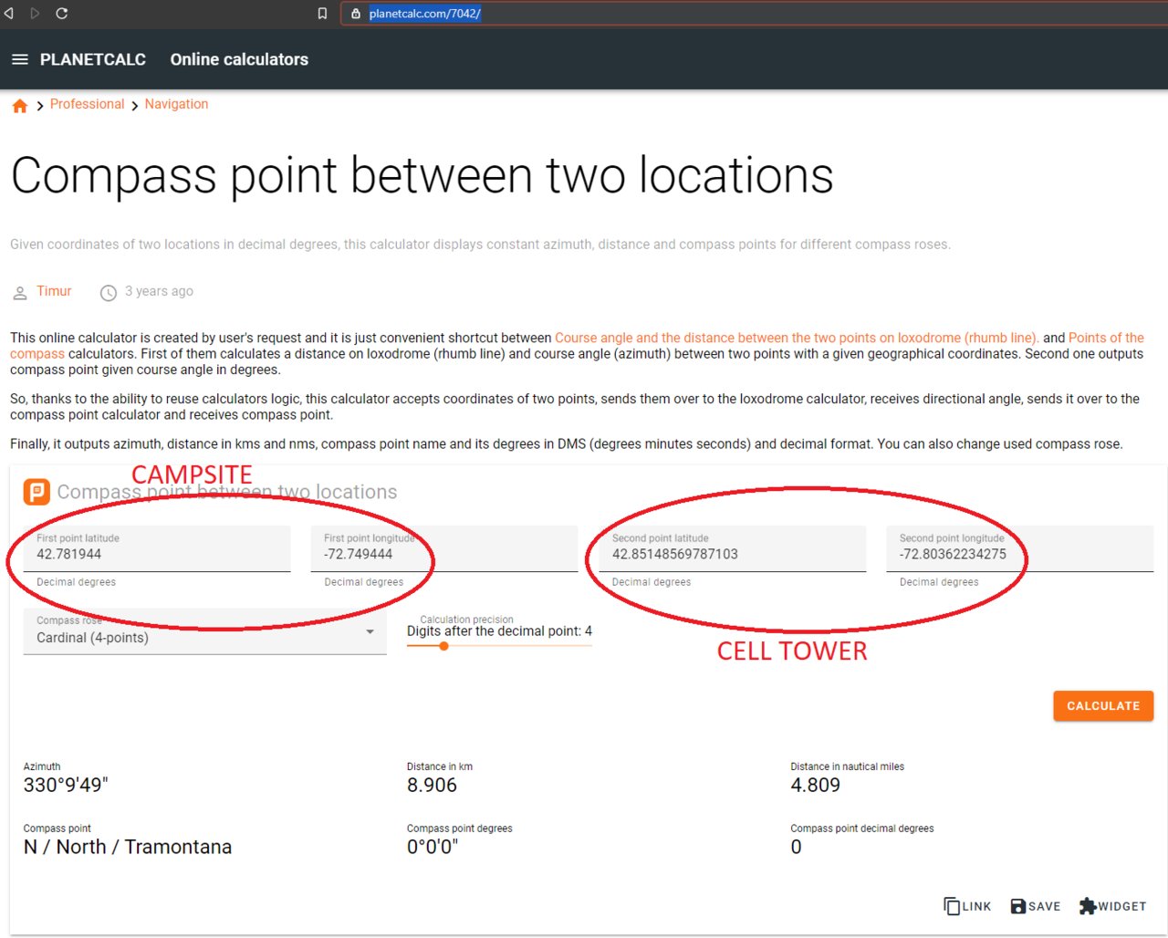

    From here, you'll just need the coordinates and elevation of your campsite (any hiking GPS should do that easy!) and a little trigonometry to figure out where to aim your antennas.
    Here's a tool for bearing angle: https://planetcalc.com/7042/
    And here's a tool for the elevation angle ("nod"): https://www.easycalculation.com/trigonometry/angle-elevation-calculator.php
    This gives us an Azimuth of about 330 degrees - use a compass to find 330 degrees from the antenna mast at your campsite. Note that reversing the locations (putting the tower first, and the campsite second) will give you the exactly wrong bearing!

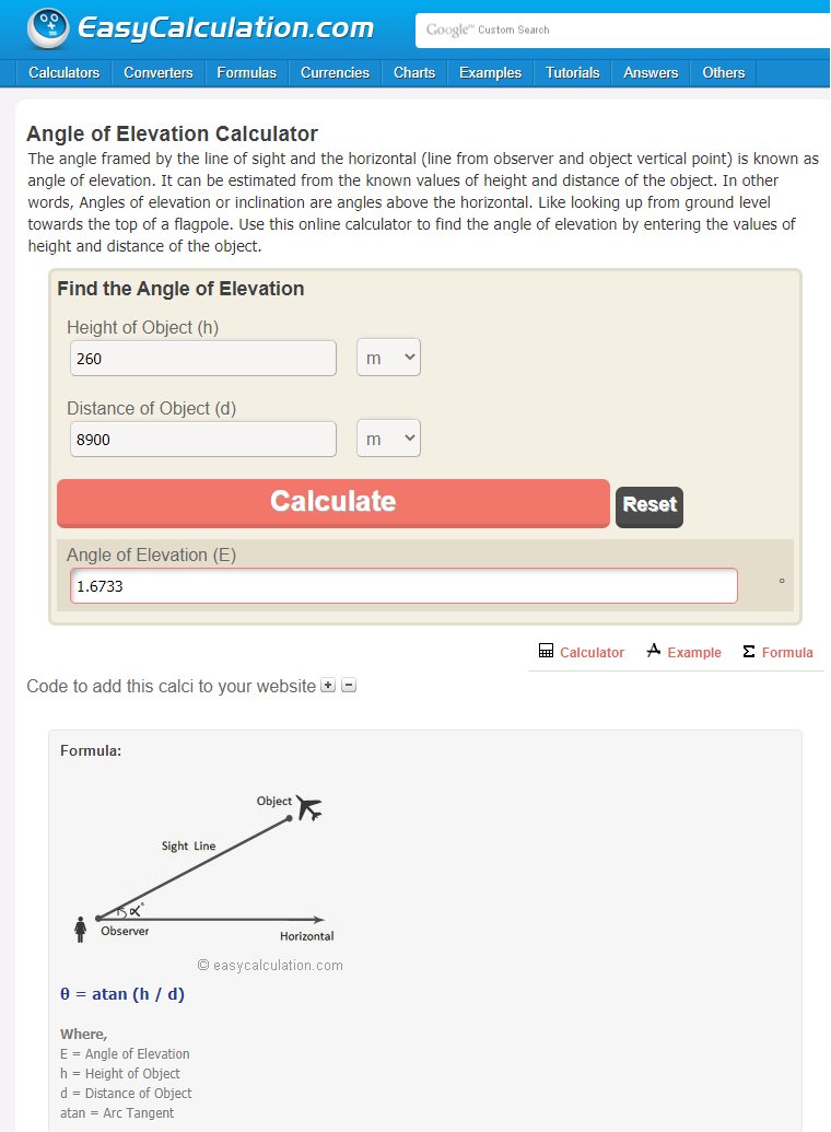

    Step 3: Find your angle of elevation
    And to calculate the angle of elevation (the "nod" of the antennas on your campsite mast), subtract the approximate elevation of your antenna from the approximate elevation of the tower.
    We know Mt. Olga is at about 750 meters, and our campsite is at about 490 meters. This gives us an approximate height difference of 260 meters. We know from our bearing angle calculator that the distance is 8.9 km, so we plug the numbers in and get:
    About 1.7 degrees "up" in this example, which is negligible in the given application, but the amount may be greater or may matter a great deal elsewhere!
    Tada! Now you know where to point your antennas from your campsite, and can fine-tune from there if you wish!
