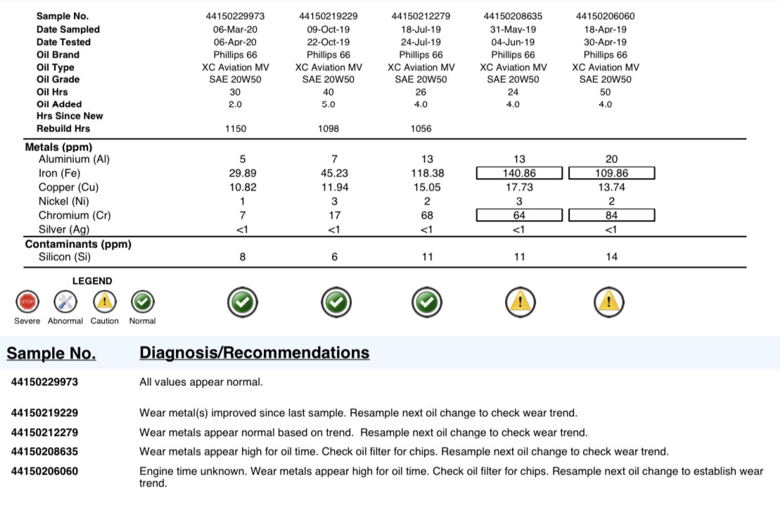

    I’m just going to play devils advocate for the sake of conversation.
    Looking at that sample analysis may look great initially, but finding elevated levels of those metals in the oil will tell you what is wearing in the engine. It can be an early indicator of what is going wrong. Most people who drive road going vehicles don’t test often enough to use the analysis as a tool as trends tend to be more important than single results. But if your new filter is pulling all those wear metals out of the oil you’ve now lost that tool to diagnose.
    Here’s the trend from my Cessna. You can see the previous owner didn’t fly it often and there was a lot of metal from corrosion at first. After a solid year of flying those levels came way down. Now I have a solid baseline to work from. If I see certain metals start to increase I have an idea of what’s wrong, or i can attribute it to a couple months of not flying.

    Completely agree. The oil test results I get will not tell much because I do not have multiple "pre-bypass filter" samples to compare against.

    Right. One could argue with our engines you may not be so worried about what’s wearing, as the engines last forever anyway. You’re just concerned with keeping the oil clean and extending its life.
    If you can get temp readings on the oil, I would be curious. Cooler helps but to an extent. We usually aim for 185-190 at the probe in the lycoming as that correlates to just over boiling in the engine, which is what you want; boil off all the water.
