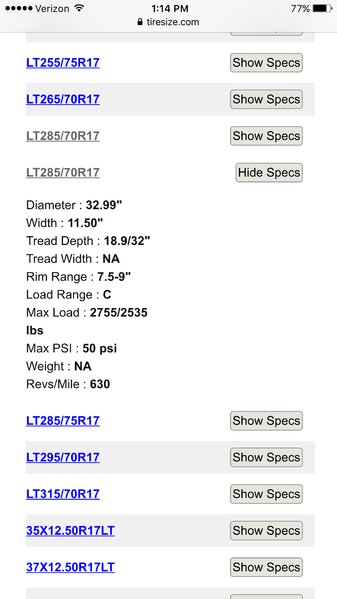

    Without the Nitto Trail Grappler there's still other option at 275/75/70 load C options but not many. Cooper AT3 and Kumho AT51 both have 275/70/17 options in load range C. The Nitto is 285/70/17 in load range C. I'll get the link.

    BUT when you click on the link for the tire and then look at the specs it switches to a different diameter and load range E...

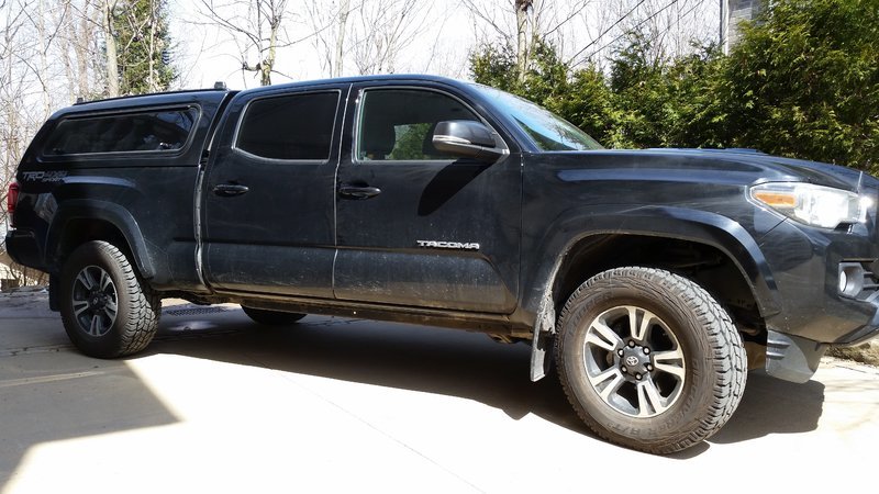

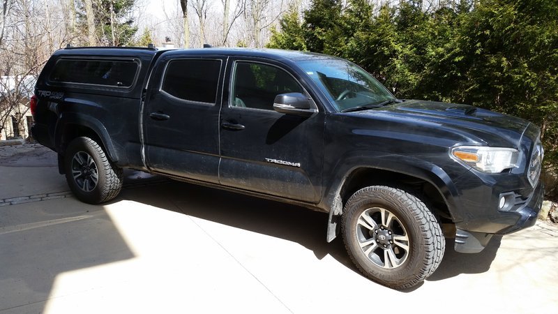

    Sorry I'm late. Coopers AT/3 load C 265/70 17. No lift. Quiet on highway, good grip on gravel. about 5% more fuel consumption than original tires. Love them so far, but I did not have any other off road tires on my Taco so I can't compare.
    And yes Taco needs a bath.
