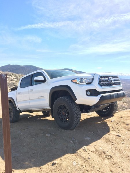

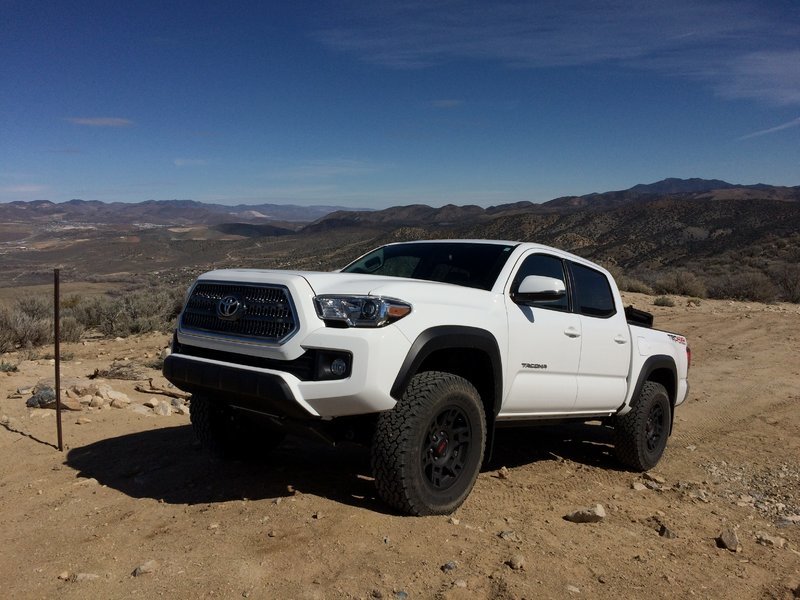

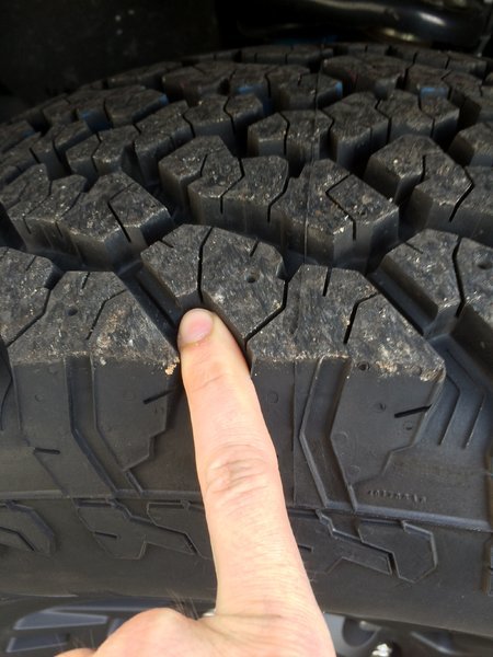

    I have the 265/70 17s and they're the non e rates ones. No power loss or any mpg loss and the ride is better than stock. They're not as mushy and do way better off road. Once I get my truck lifted and these wear out I'm probably going to get another set in a 285 because they've been that good. The tread depth on the non e load is one of the best out there.

    Damn, those are 265's? They look really good, is that with any lift? So if they are the non-E rated tires I am assuming they are the SL's? I wonder how much weight I'd be able to carry before it makes sense to go to a load C tire vs SL.

    Yeah they're 265s but theyre big because of the deep tread! No lift I just put 5100s on front set at .85 to level the front to compensate for my skids. The load rating on them is higher than what you could safely carry in your truck anyways so I'm not worried.

    If I didn't know better I'd say those look really similar to the KO2s

    Looks like the General Grabber AT2's, can see the little holes for the optional stud placement. They do look a lot bigger than most the other pictures I see with 265/70/17 however.

    Yes they do look really similar to the BFGs! I looked into them but based off of the awesome reviews these got not only on here but on other websites as well and the price on these I had to give them a shot and I love them. They also have a deeper tread than the BFGs if I'm not mistaken.
    Yes I agree they look larger than most 265/70/17s and it might because of how deep the tread is on these compared to a lot of other all terrain tires. I love how they look.
