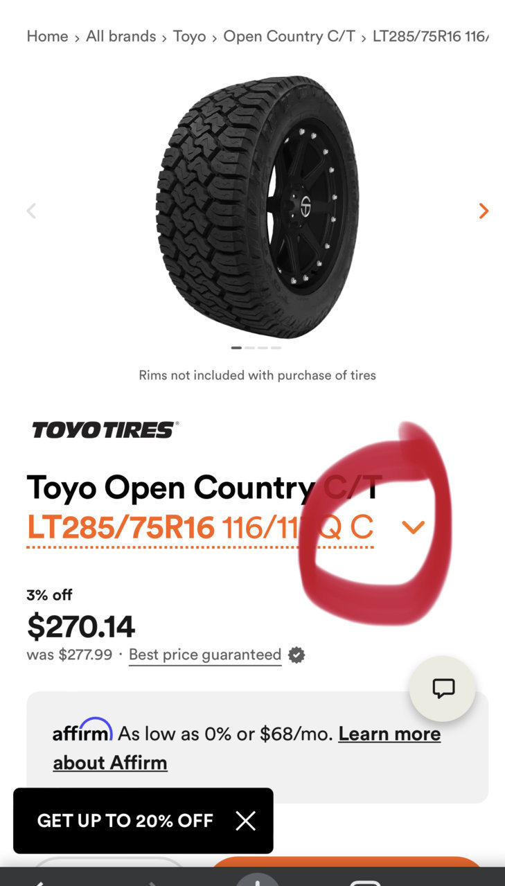

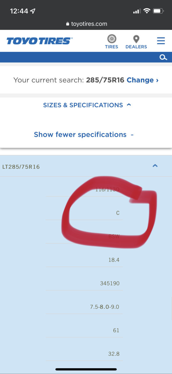

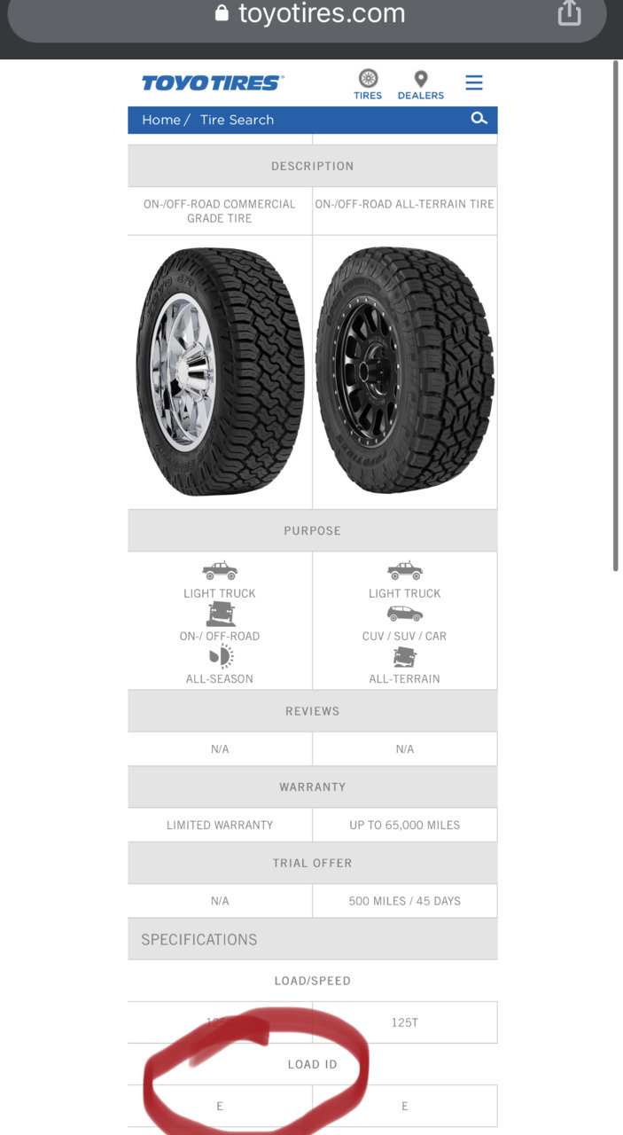

    I’ve searched all over TW, including doing the google search with “Tacoma world” and can’t find an answer for this…hopefully I didn’t miss it somewhere.
    Can someone who is running the Toyo Open Country C/T tires in 285/75/16 confirm the load rating for me?
    There is conflicting info all over the major tire websites about whether they are E rated or C rated, including the Toyo website. See below photos.
    @Discount Tire maybe you guys could help out with this?

    That is very interesting, would be the only C rated in that size i know of. The max presure and load figures match C rated, but the weight appears to be 61lbs. That would be heavier then many E rated uptions in that size. Following...

    Yeah that’s exactly what I was thinking too…even the other stats on the tire don’t really make sense.
    If I found a C rated 285/75/16 tire, I’m gonna have to buy them immediately and get rid of my E rated Grabbers.

    We are able to confirm the 285/75R16 Toyo C/T are a load range C tire. They are not offered in an E rating

    This is likely one of the only C rated options in this size as the other ones we looked through are all D or E rated.
