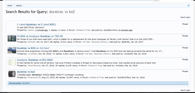

    Plenty of those on here.

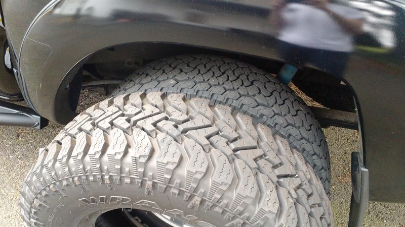

    Check out the wallyworld Goodyear Wrangler Authority. Based on the duratracs, extremely positive reviews, and a fraction of the price of either. I love mine.

    Those wally tires are CRAP. I went from a set of Duratrac to the Authority. Have a new set of Duratracs in the garage to get installed. Stick with the Duratracs!
