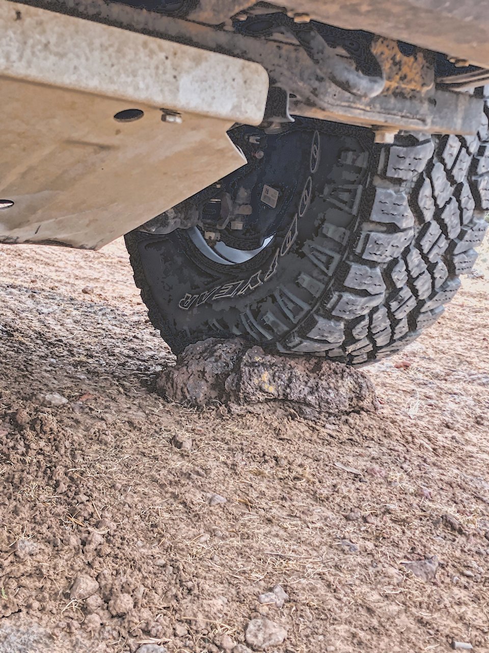

    Fantastic photo and a great Segway into why I chose this exact tire
    With an E you get 10 ply that's great for quite a bit.
    The extra give the C have to be able to deform and wrap around rocks is a huge benefit. I ran stoney lonesome recently in Northern Alabama and multiple people mentioned how the tires were much more flexible over rocks ect and I had no traction issues where an equally equipped truck was having minor traction issues. Lot of variables but I can 100% feel the tires wrap around obstacles, especially dropping off ledges
