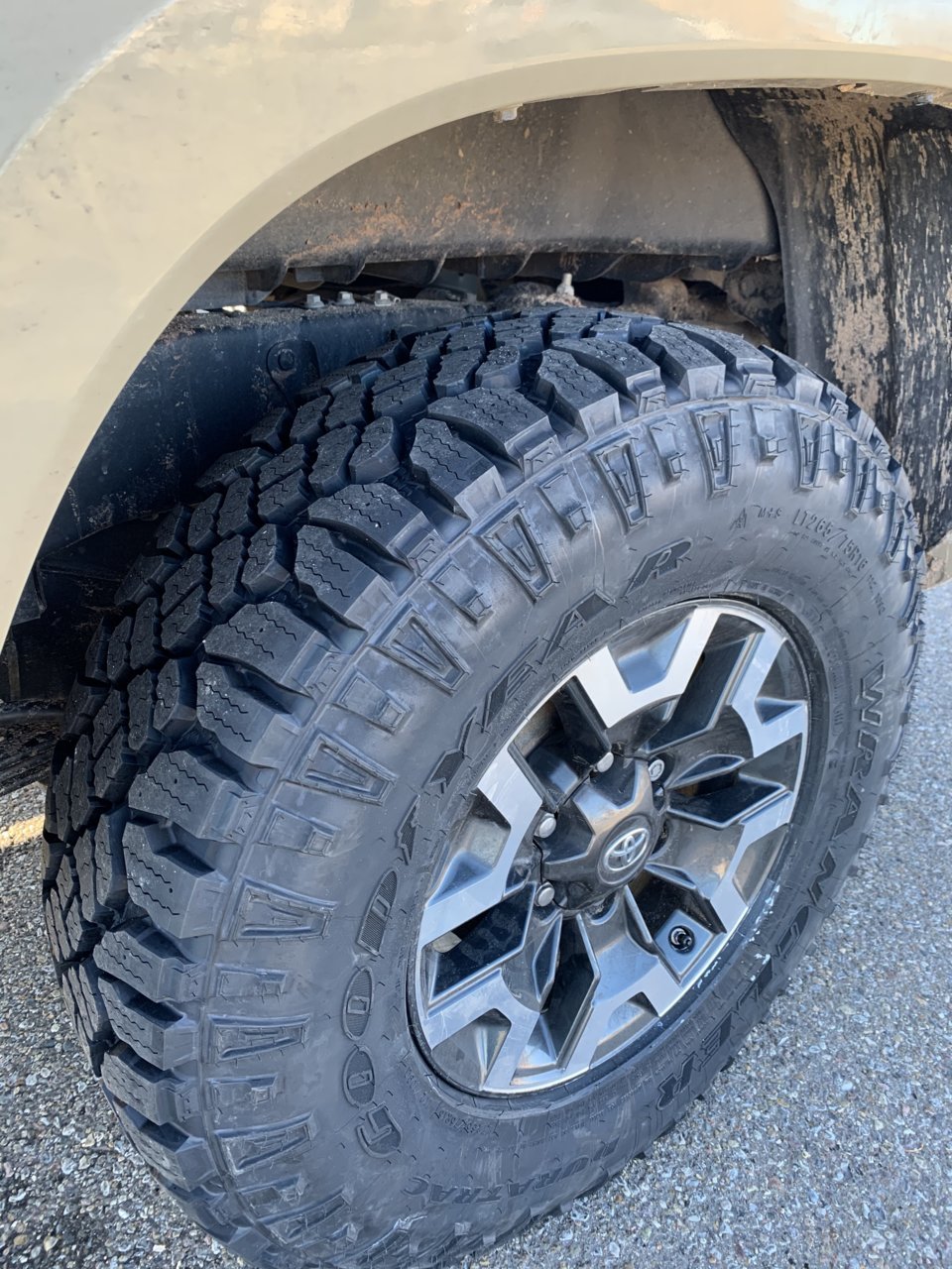

    I guess it depends on how you use the vehicle. My E load ko2’s road like bricks, adjusting tire pressure didn’t help. Maybe if you play in the rocks a lot. C and even D load seem far better suited to the weight of the Tacoma.IMO
    Just got new c load duratracs

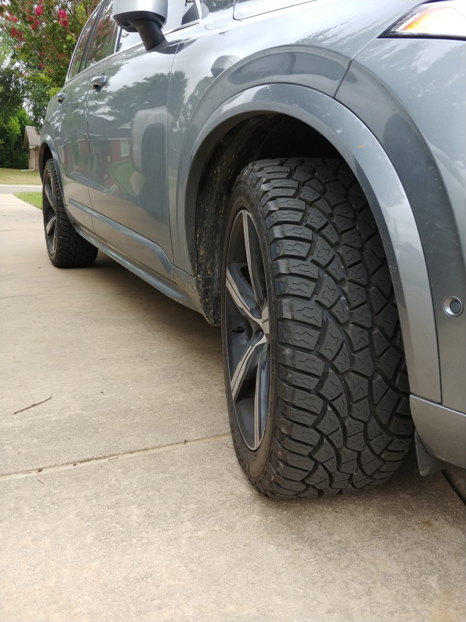

    Damn I wonder why so many are saying the BFG in E are rough.
    Find em smooth as hell.

    Ok its bothering me. What car is this?
    Let me guess... Acura? Mazda? Fuck i should know this.

    They are very smooth at 30 psi in 17" size. But thats a bit underinflated.

    Haha someone had to ask.

    I been lazy. I'll take a PSIG reading tomorrow.

    lol it's a Volvo Polestar XC90.

    Polestar?

    Damn it! Thats a hard one.

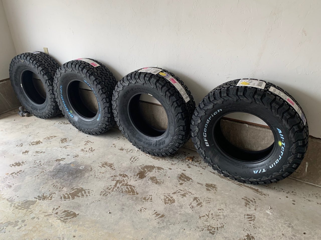

    C rated tires came in quick.

    E rated. At the right pressure they ride just fine.
    I'd rather take a small hit on fuel and not worry nearly as much about trying to change a flat in a shit spot on the trail.

    You will love the smooth ride!
