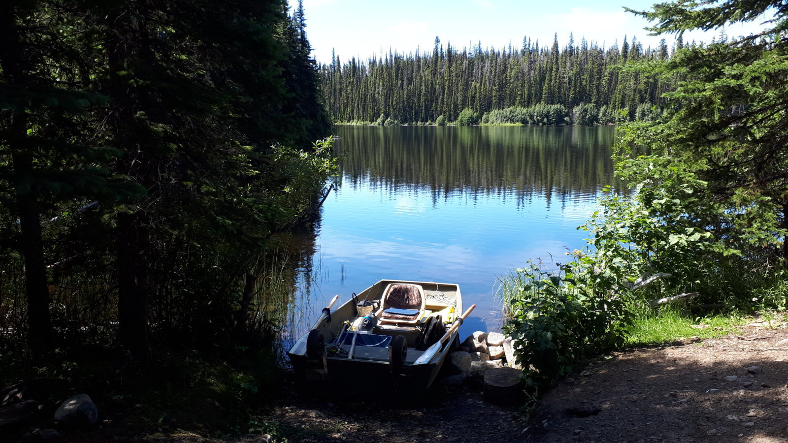

    Other pic is the reward at this spot.

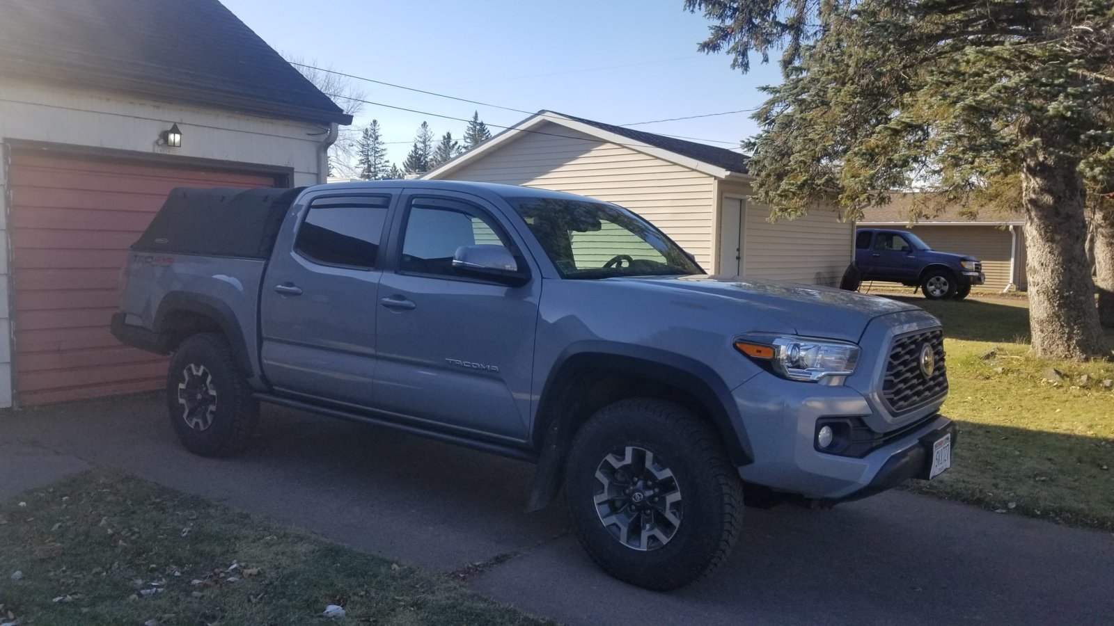

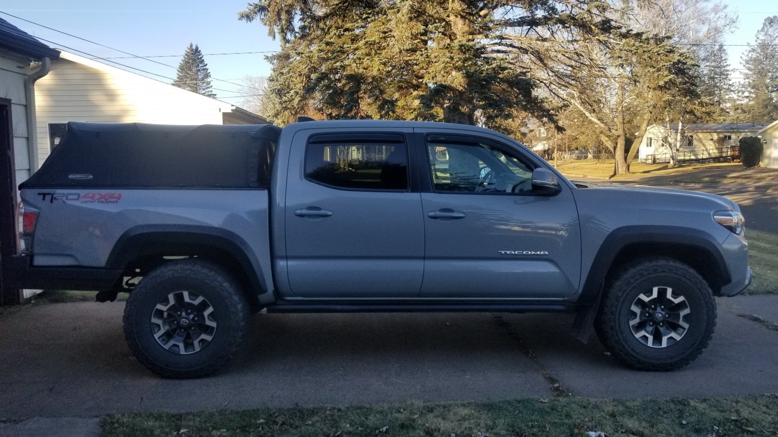

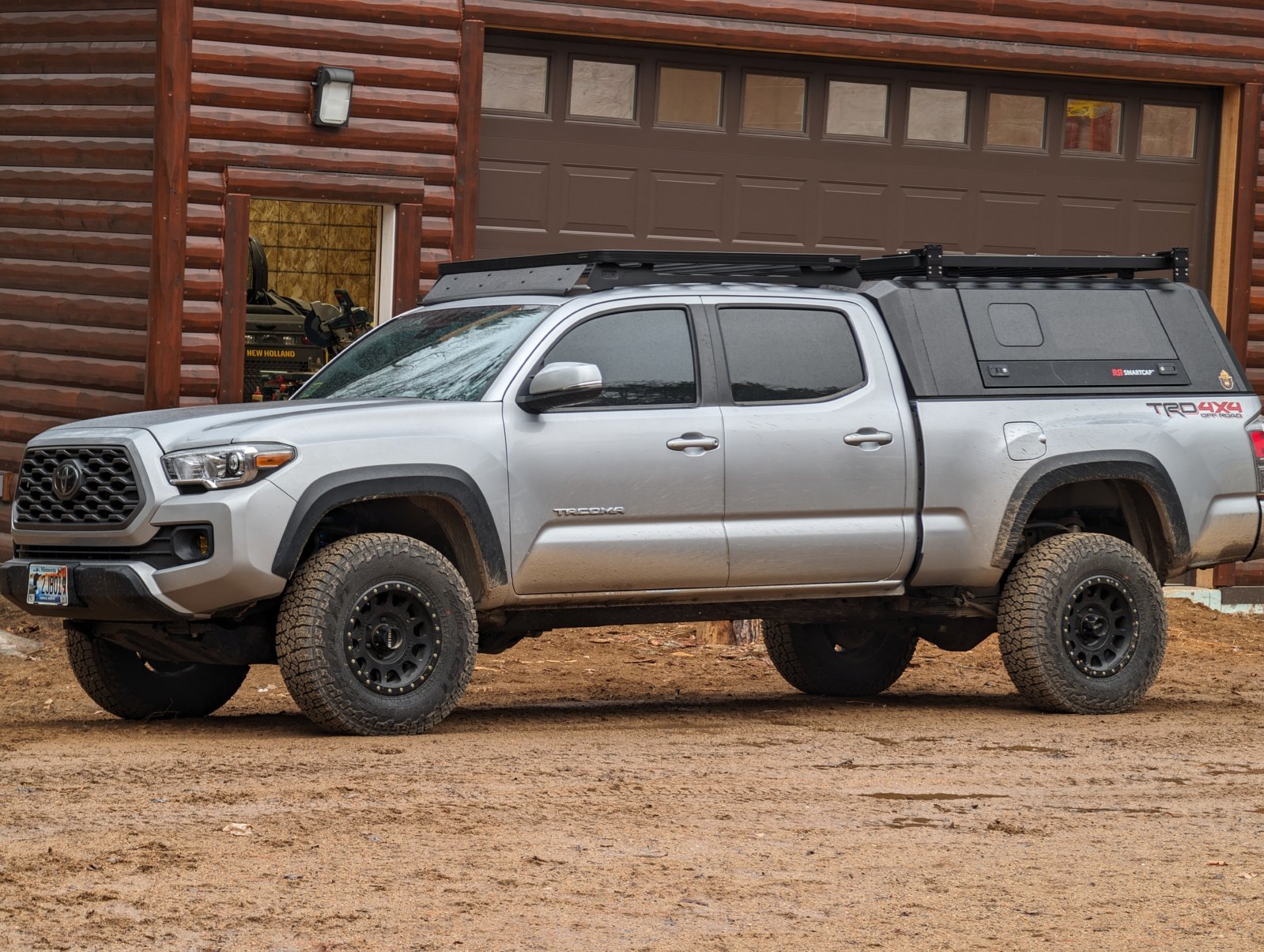

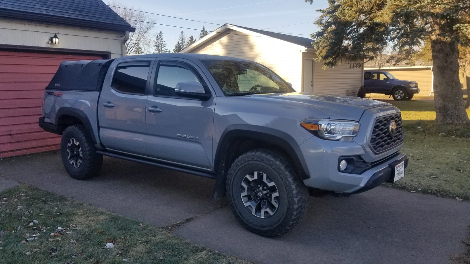

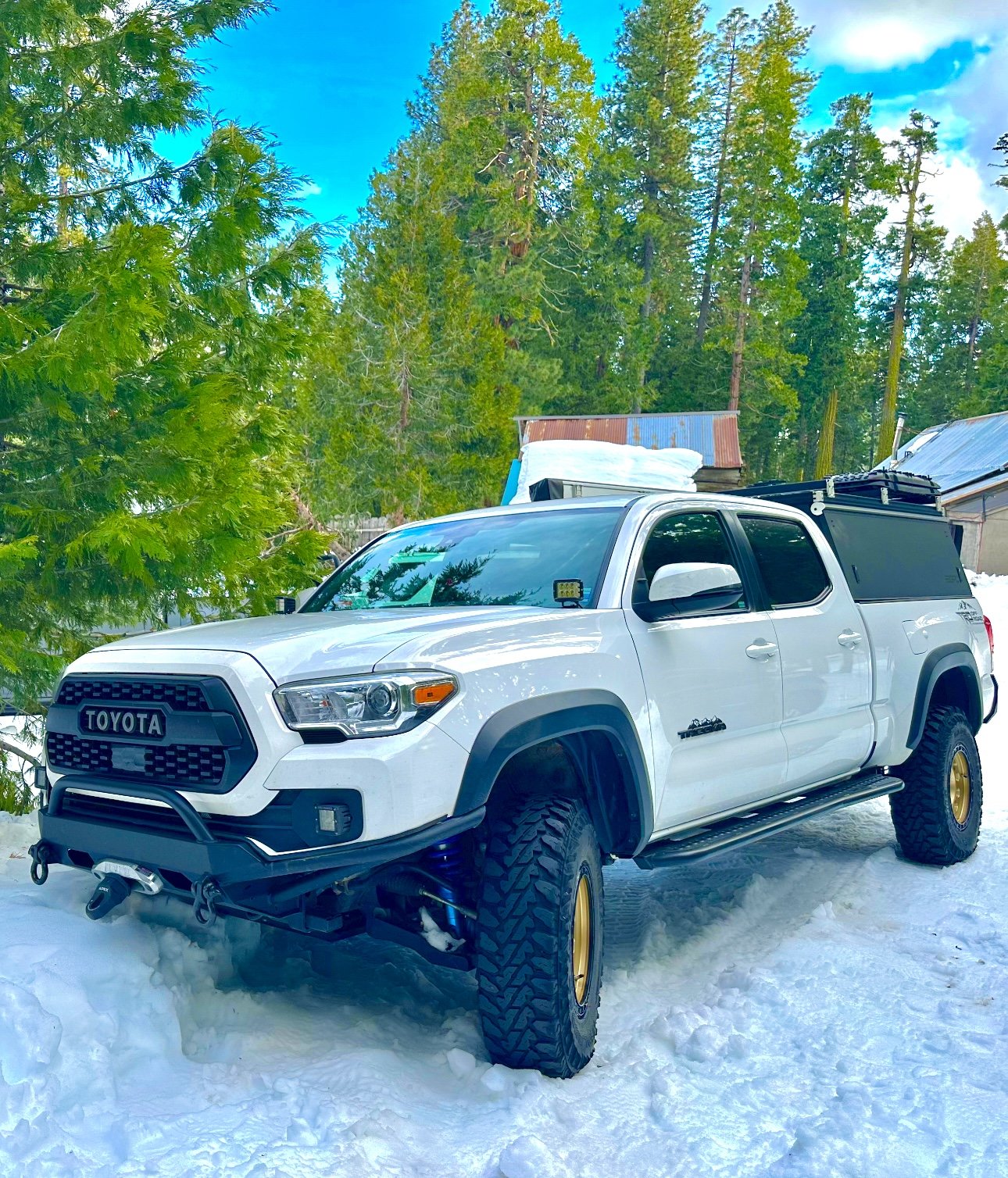

    I have two different sets of E's, more for the tall skinny tire sizes that are only available in E load rather than for any other reason. My Mastercraft Courser CXT's are 255/85R16, went with those prior to going to Moab for the first time and decided to prioritize bigger tires for diff clearance rather than a lift, so I wanted the tallest tires I could fit with stock suspension. I really like that tire size, so I can see myself sticking with them for the life of the truck. The beefier construction and thicker sidewalls was just an added bonus for airing down and when wheeling for me.
    I wanted to get dedicated snow tires this winter (and then we got a record low amount of snow, lol) and I wanted again to go with something tall and skinny, so I ended up with 235/85R16 Nokian Hakka's, which also only come in E load.
    Maybe it's been so long on E load tires that I don't remember what the stock tires felt like (took them off at 10k for the 255's, now approaching 40k) but the ride isn't significantly harsher to me. I run the 255's at 36 psi and the 235's at 39 psi. Since adding my high clearance rear bumper, I have more peace of mind leaving the spare 255 at home (since it looks stupid under the truck now), unless I'm going on some cross country road trip, then it goes in the bed. I didn't buy a spare 235 because they were E load. I carry a tire puncture kit in the truck at all times.
    I agree that they are definitely overkill for most use cases, but for fans of tall skinny tires, there aren't a lot of options, and so far, the benefits have outweighed the negatives for me. I haven't had a discernible drop in MPG's, the 255's have worn really well, and my ass can't tell the difference in ride quality, the midsize truck still rides like a midsize truck.
    255:
    235:

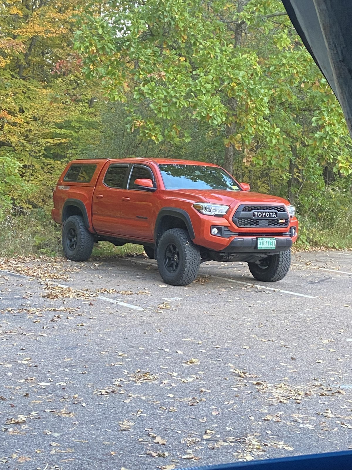

    Running 285/75/16s
    E rated here.
    Don’t really care about mpg and it’s like buying a divers watch in case it gets wet doing dish’s!
    Can’t say I need it just what I wanted.

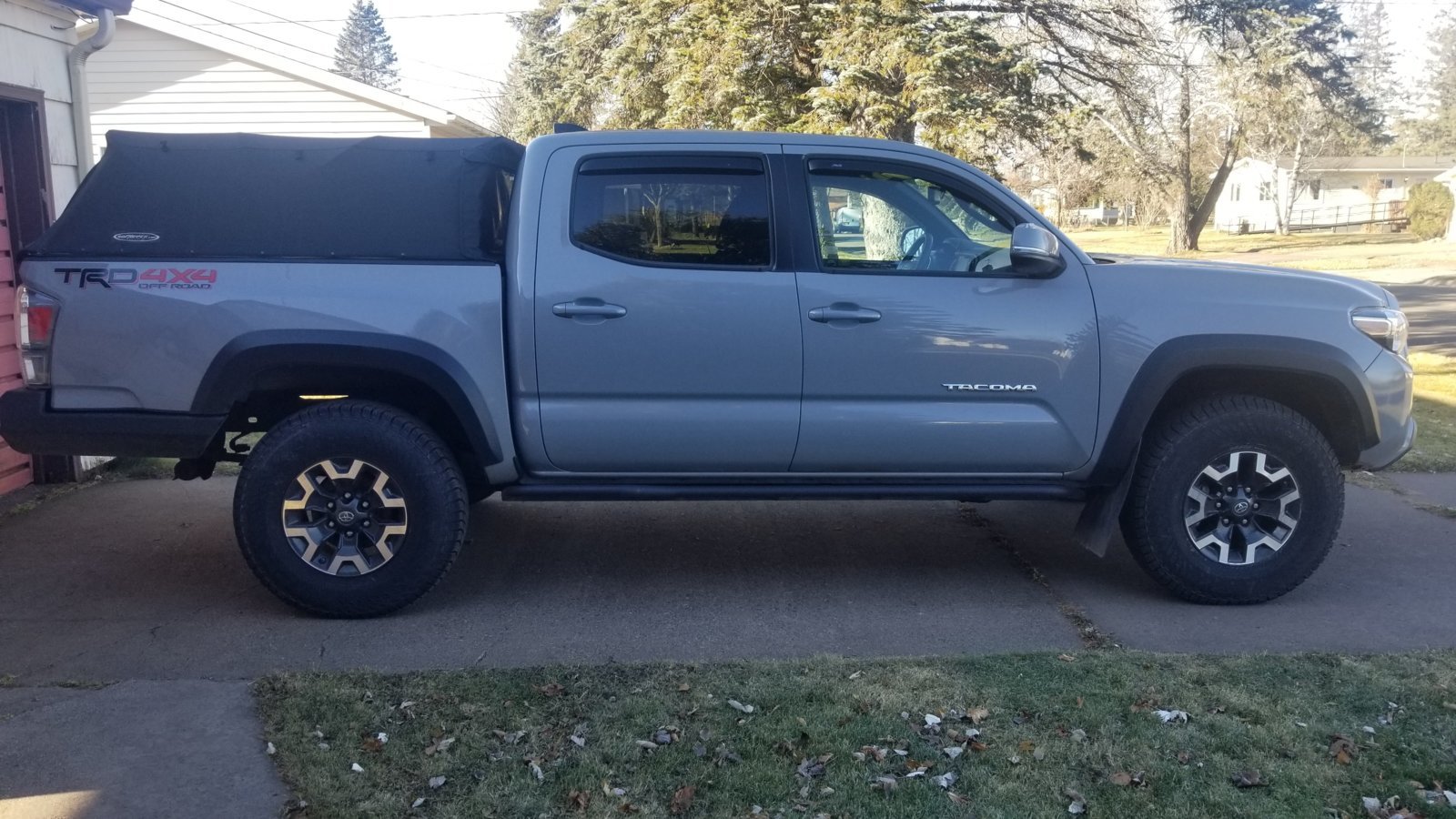

    265/75/16 at3w E rated. 15-18 mpgs cruising at 63mph every day, I also do lots of gravel road driving
