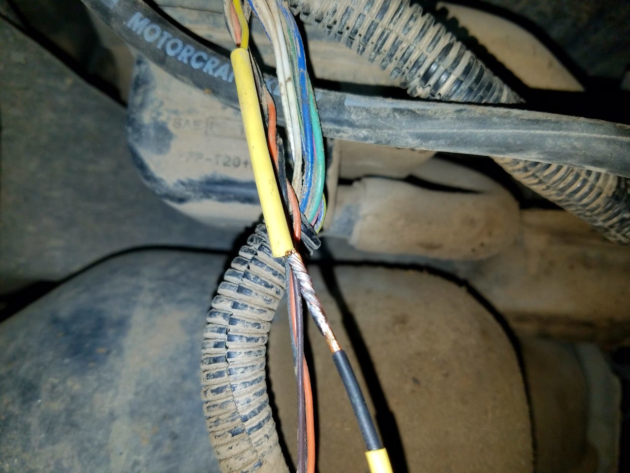

    I had a problem with the left rear sensor that was intermittent. Because that ABS light was not always on it took sometime to diagnose and fix. Found a frayed wire in a connector.
    The damaged wire:

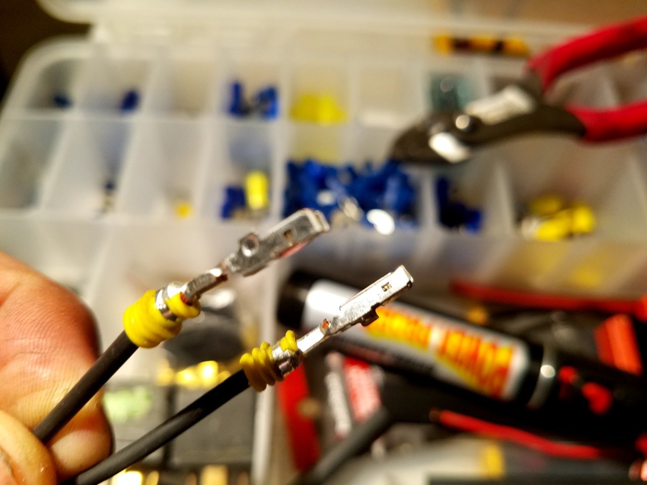

    Made new Bosch style connectors. Spliced, soldered and heatshrinked to the damaged section:
