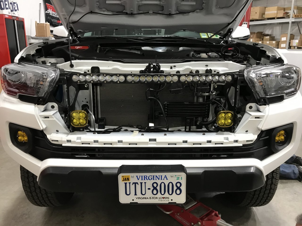

    This is what i did with mine.

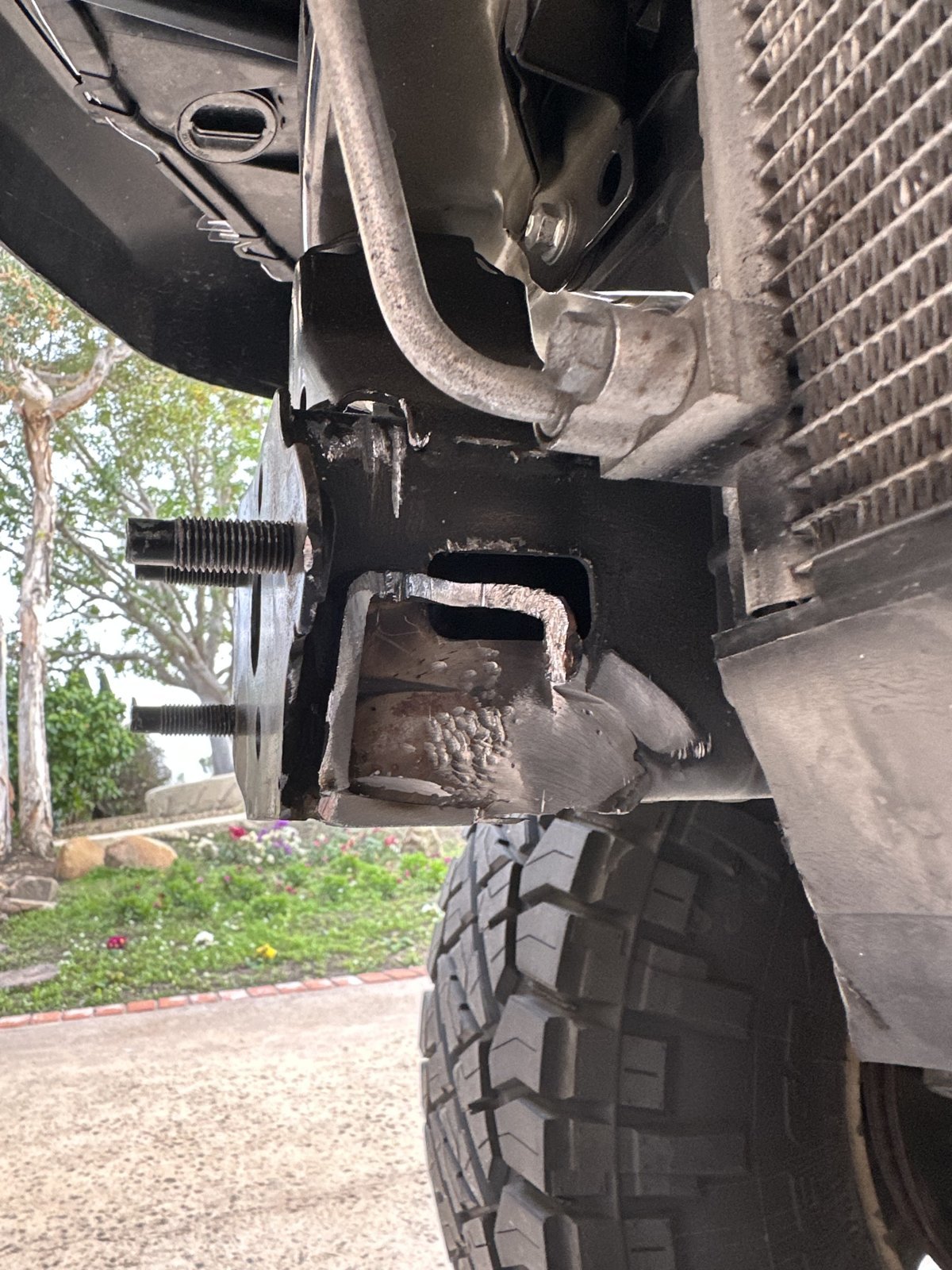

    Had a fun time getting the coastal off road crossmember out to get this new c4 one in. PITA grinding the welds off but got her to fit. Just waiting for paint to dry and throwing the bumper and skid on today

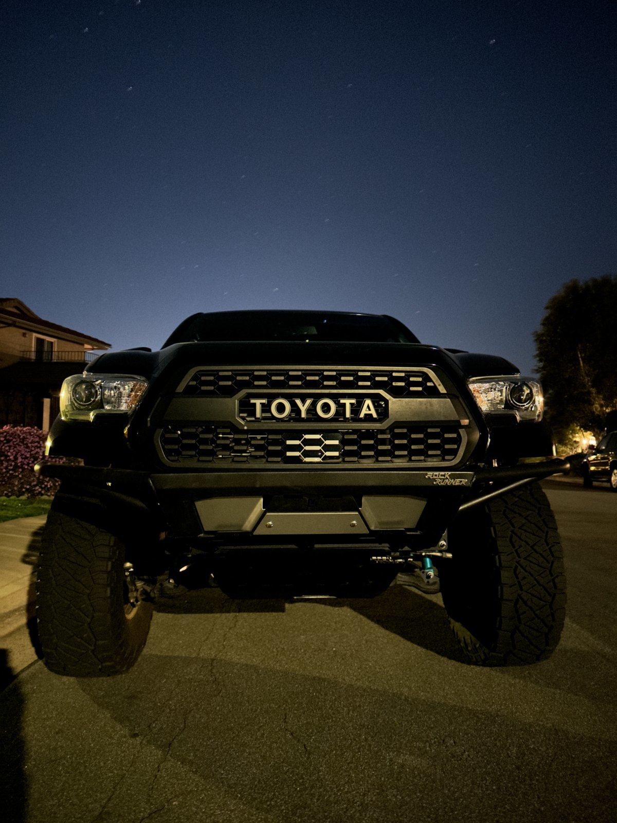

    Looks pretty sick. Now gotta figure out lighting

    I like how awkward it looks without oversized tires. I always wanted a bumper first but was too scared to commit before tires.

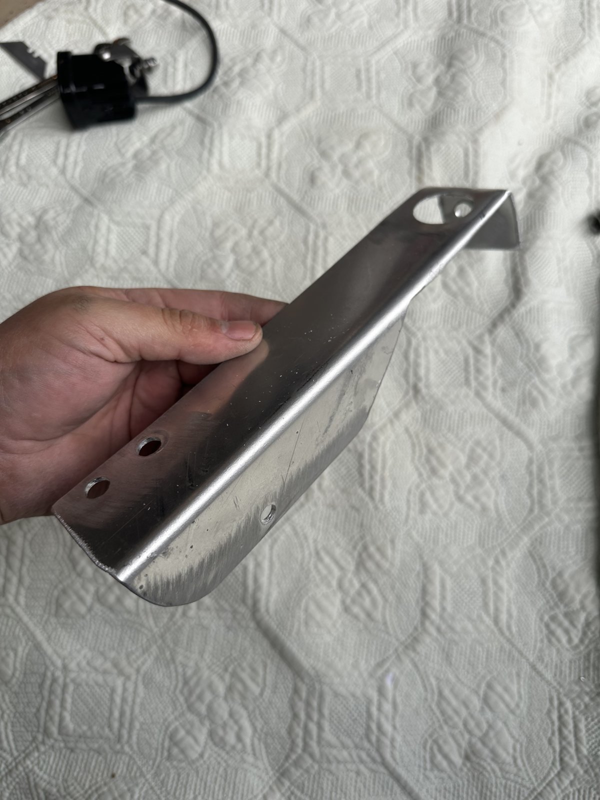

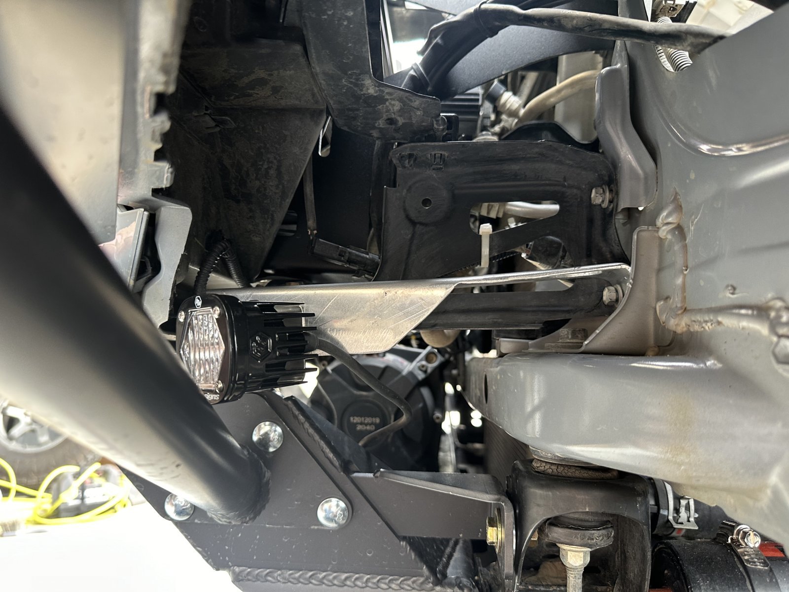

    In the process of making mounts for my S1’s. Going to be removing my ditch lights and using the wide cornering S1’s at an angle instead. This would also work if I wanted to keep them straight for fog lights. Also made a hole to still have access to the nasty body mount bushings I’m waiting to receive to swap out without removing anything

    I think I’m just gonna chop my grill a little to fit some

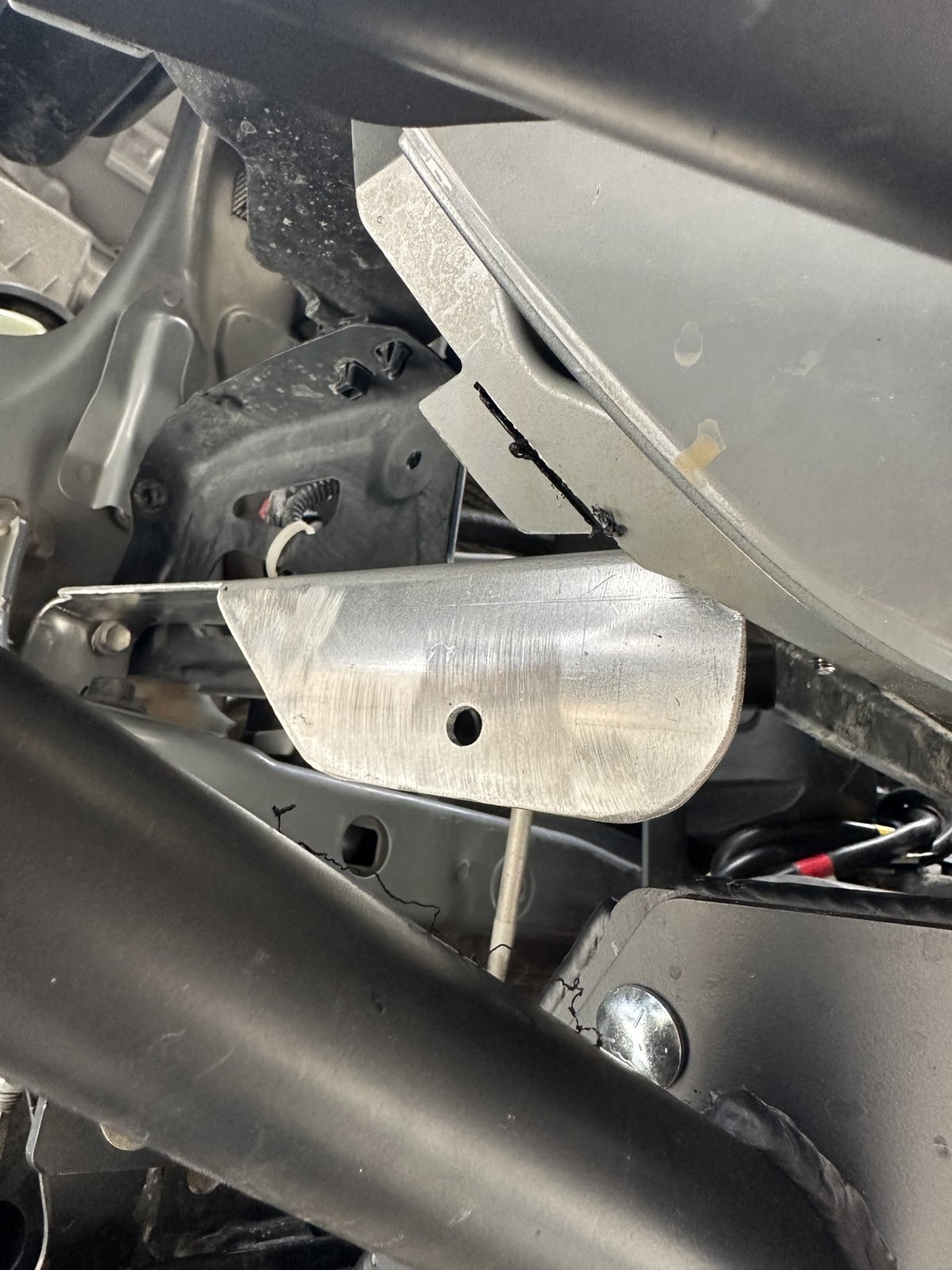

    Here’s all I had to cut off going this route

    Gonna chop more so I can weld in a bracket on the tube

    Bracket looks great! Was wondering if you are going to add any bracing at the end of it since it look like it might bend a bit over time with the weight of that light and bumps?

    Feels pretty sturdy when all bolted together and tightened down. If it does start showing any bending or weakens then you bet I will :thumbsup:
